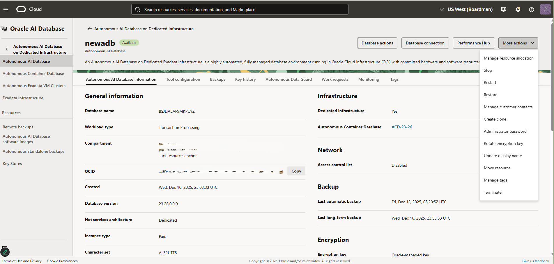

    4. Select the More actions button, and then select the Create clone option.This screenshot shows how to create a clone.

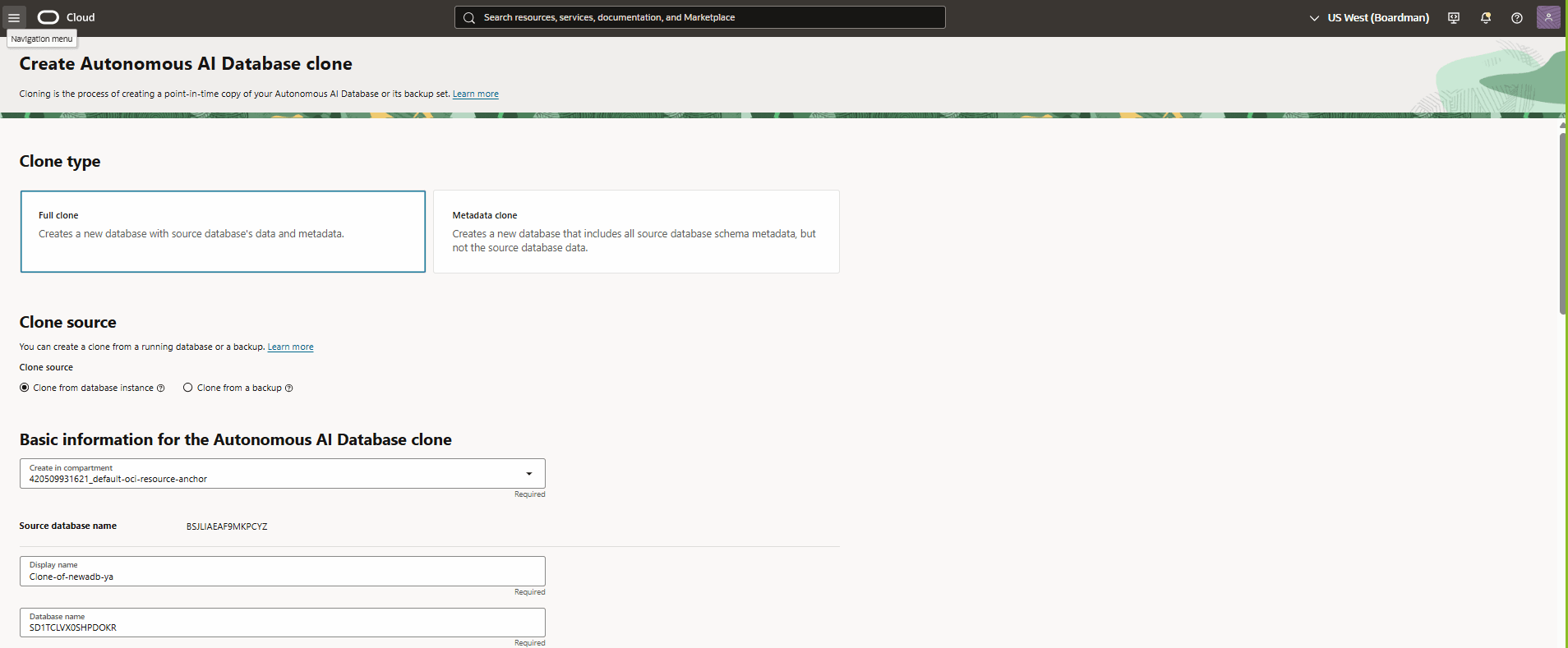

    5. From the Create Autonomous AI Database clone page. Complete the following substeps:
      1. Select your Clone type as Full clone.
      2. Select the Clone from a backup option as your Clone source. Choose a date and time.
      3. Select your compartment that you want to create the clone in.
      4. Enter a Display name that helps you easily identify the resource. The display name must be 1 to 255 characters, of letters, numbers, underscores (_) and hyphens (-). Display name must start with a letter or underscore (_) and cannot contain two successive hyphens (-).
      5. Specify a Database name. The database name must contain only letters and numbers, starting with a letter. It can be up to 30 characters. Spaces are not allowed.This screenshot shows how to create a clone.

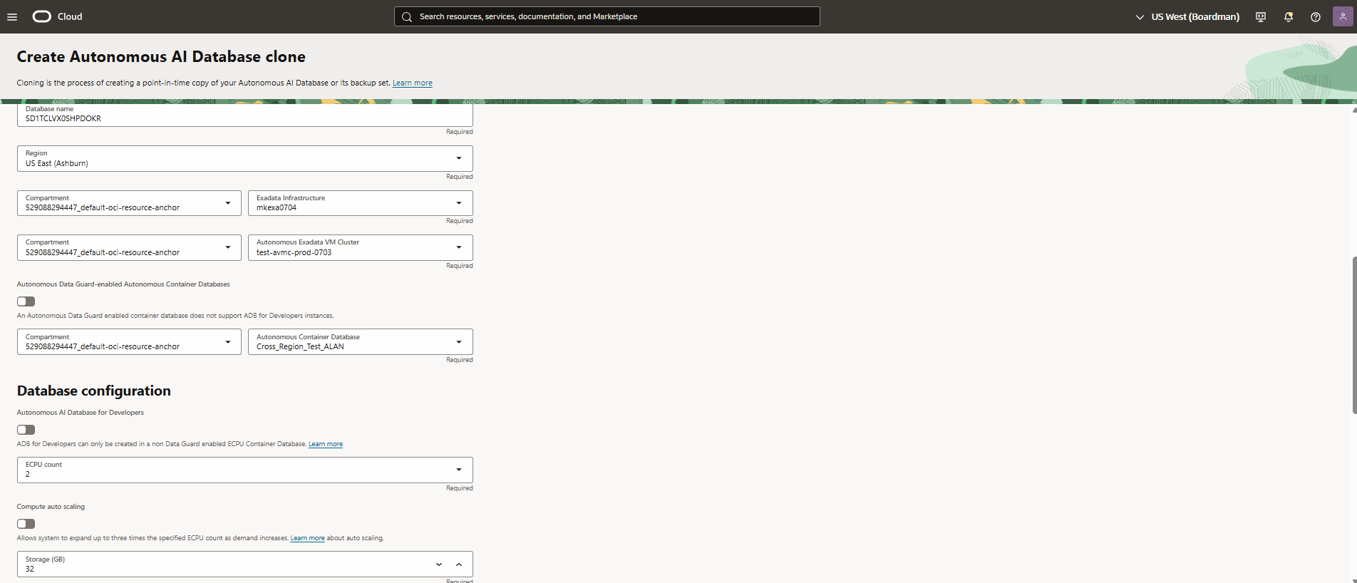

      6. From the Region list, select the target region where your backup will be restored.
        Note
        The OCI region Ashburn is mapped to the AWS region N. Virginia. The target Autonomous AI VM Cluster is physically located in N. Virginia.
      7. From the Compartment dropdown list, select your compartment in which your Exadata Infrastructure resides.
      8. From the Exadata Infrastructure dropdown list, select your Exadata Infrastructure.
      9. From the Compartment dropdown list, select your compartment in which your Autonomous Exadata VM Cluster resides and then select your target Autonomous Exadata VM Cluster.
      10. If you want to use Autonomous Data Guard–enabled Autonomous Container Databases, turn on the toggle. This step is optional.
        Note
        An Autonomous Data Guard enabled container database does not support Autonomous AI Database for Developers instances.
      11. Select your Compartment and Autonomous Container Database from the dropdown lists.
      12. Navigate to the Database configuration section. To enable Autonomous AI Database for Developers, turn on the toggle. This step is optional.
        Note
        Autonomous AI Database for Developers can only be created in a non Data Guard enabled ECPU Container Database. For more information, see Autonomous AI Database for Developers.
      13. Select the ECPU count from the dropdown list. Only available ECPU values are displayed.
      14. The Compute auto scaling is optional. This option allows the system to expand up to three times the specified ECPU count as demand increases. For more information, see CPU Allocation When Auto-Scaling.
      15. Specify the Storage (GB).This screenshot shows how to create a clone.

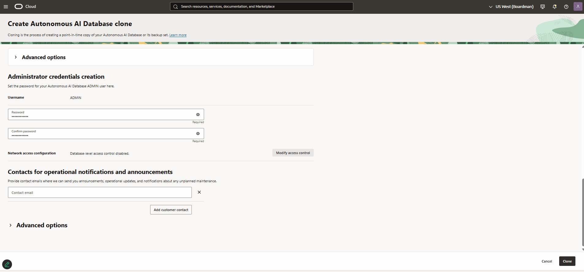

      17. Navigate to Administrator credentials creation section, and then enter your Password. The password must be 12 to 30 characters and contain at least one uppercase letter, one lowercase letter, and one number. The password cannot contain a single quote (') or a double quote (") character or the user-name "admin".
      18. Reenter your password in the Confirm password field. The confirm password must match password you entered in the previous step.
      19. The Network access configuration is disabled by default. Based on your requirements, you can modify access control. This step is optional.

      20. Enter your Contact email for operational notifications and announcements. You can select the Add customer contact, and then enter the required information.

      22. Review your information, and then select the Clone button.This screenshot shows how to create a clone.
