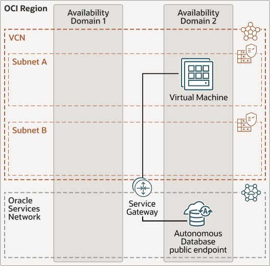

Low Latency Connections Using Public Endpoint with Application Running Inside the OCI Region
Description of adb-public-low-latency.eps follows

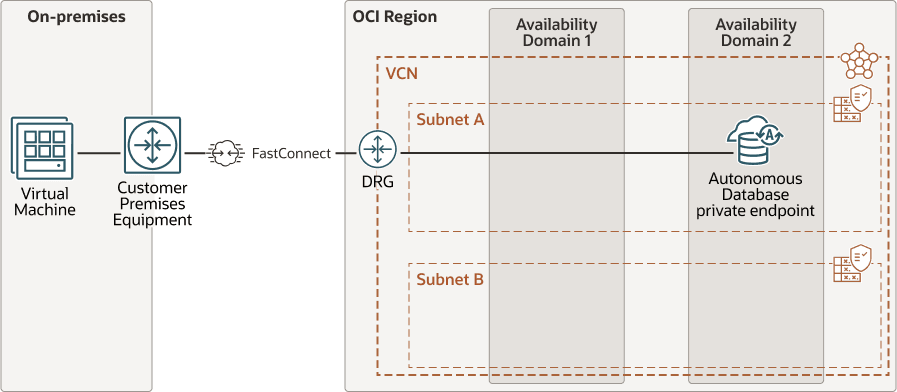

Low Latency Connections Using a Private Endpoint with Application Running In On-Premises Data Center Connected to OCI Using FastConnect
Description of adb-fastconnect-private-low-latency.eps follows

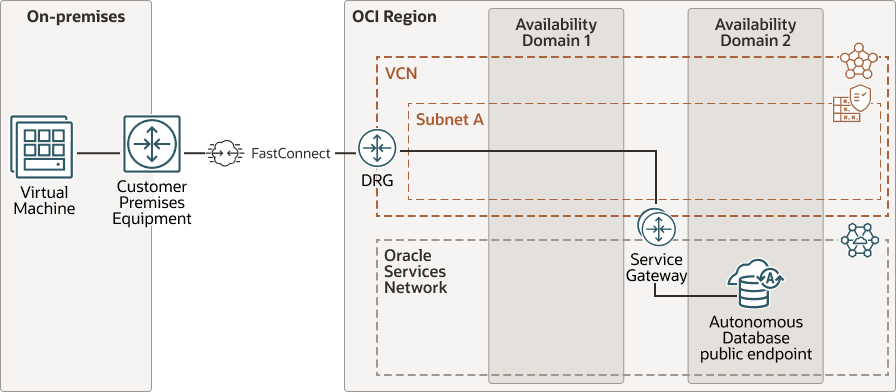

Low Latency Connections Using a Private Endpoint with Application Running In Your in On-Premises Data Center Connected to OCI Using FastConnect
Description of adb-fastconnect-public-low-latency.eps follows
