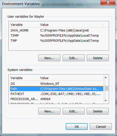

Troubleshoot: Windows: The system cannot find the path specified. Agent install failed.
ERRORLEVEL=9009
Possible Cause: Environment variables have not been set properly due to spaces in the directory/folder name.
Windows environments allow to use spaces within a directory/folder name which causes an issue with the Management Agent installation since quotes are added to the name automatically by Windows. For example, there's a directory/folder named: Program Files. In this case Windows auto-inserts quotes since there's a space within the folder name, and it will now say: "Program Files".
Extra quotes can cause an issue since Management Agent installer does not allow quotes for environment variables like JAVA_HOME and AGENT_INSTALL_BASEDIR.
Note
The Management Agent installer does not accept the following special characters in the path: [, ^^, ", ', &, or ].
Action:
The recommended way to set up environment variables in Windows is by using the Advanced System Settings.
  • On the Windows taskbar, right-click the Windows icon and select System.
  • In the Settings window, under Related Settings, click Advanced system settings.
    Windows Advanced Settings
  • On the Advanced tab, click Environment Variables.
    Windows Environment Variables
  • Click New to create a new environment variable. Click Edit to modify an existing environment variable.
  • After creating or modifying the environment variable, click Apply and then OK to have the change take effect.
    Note
    The graphical user interface for creating environment variables may vary slightly, depending on your version of Windows.
