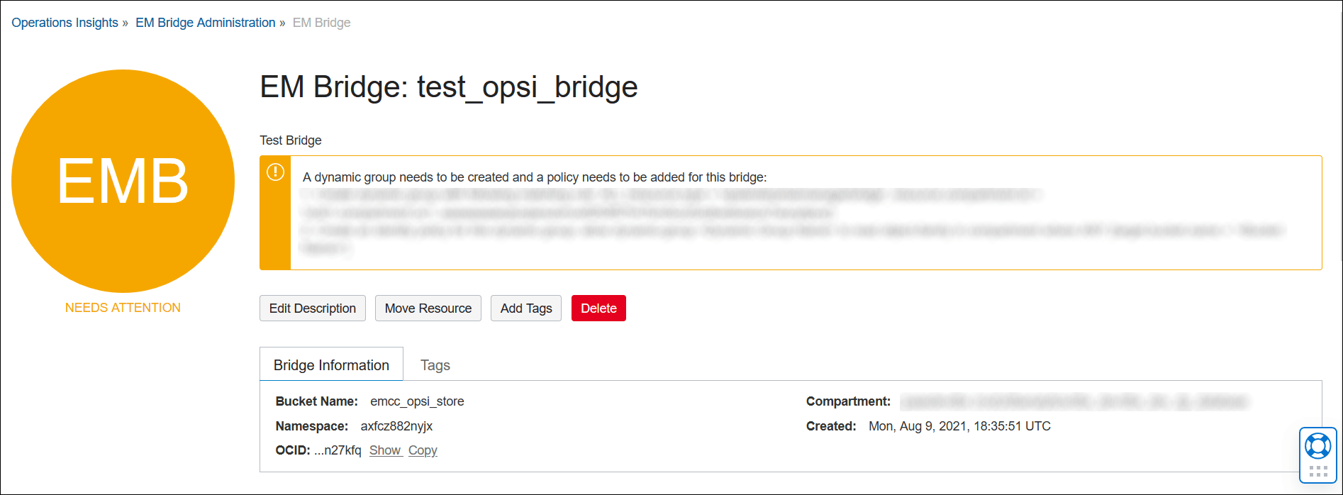

  1. Obtain the EM Bridge OCID to which the target belongs from the value of the alarm sourceIdentifier dimension.
  2. Navigate to the EM Bridge Administration UI for that bridge and check its status.
    1. If the status is NEEDS ATTENTION, then refer to the policy shown in the UI and add the appropriate policy so that the EM bridge's status become ACTIVE.

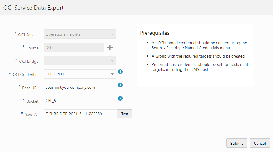

  4. In Enterprise Manage console, check the OCI Bridge connectivity using steps outlined in Step 1: Export Enterprise Manager Data to OCI.
    Click Test to check the OCI bridge connectivity for your bridge.
    Image illustrates how to check for OCI bridge connectivity.
  5. If the OCI bridge test fails, then update the OCI credential accordingly so that Enterprise Manager has access to the provided Object Storage bucket.

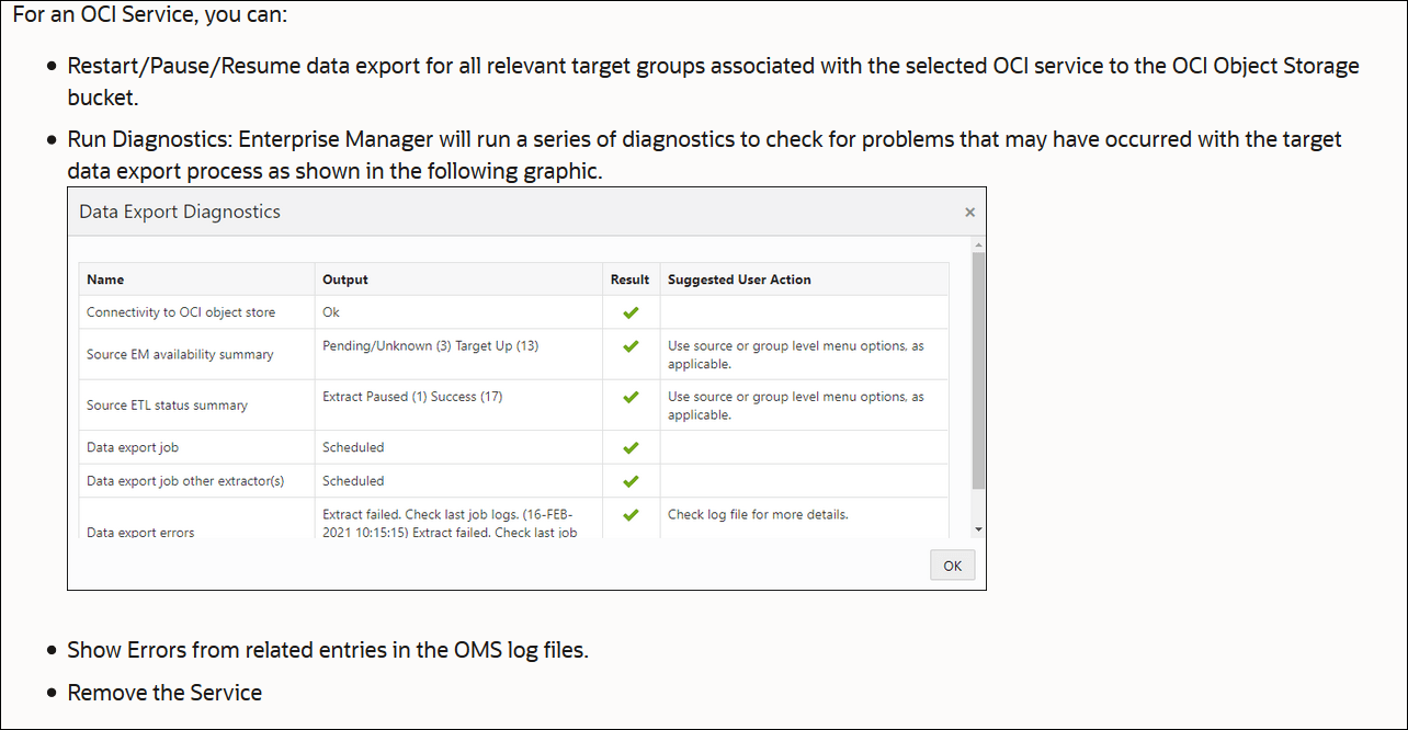

  7. Select the Ops Insights service and select Run Diagnostics from the menu to get the overall report.
    Image shows a sample diagnostic report.
  8. For a group/target, with apparent problems (as shown in the UI), select Show Errors to get detailed information on that error.
    If the error shows that the target or agent is down, then you can restart the target or agent from the Enterprise Manager console.

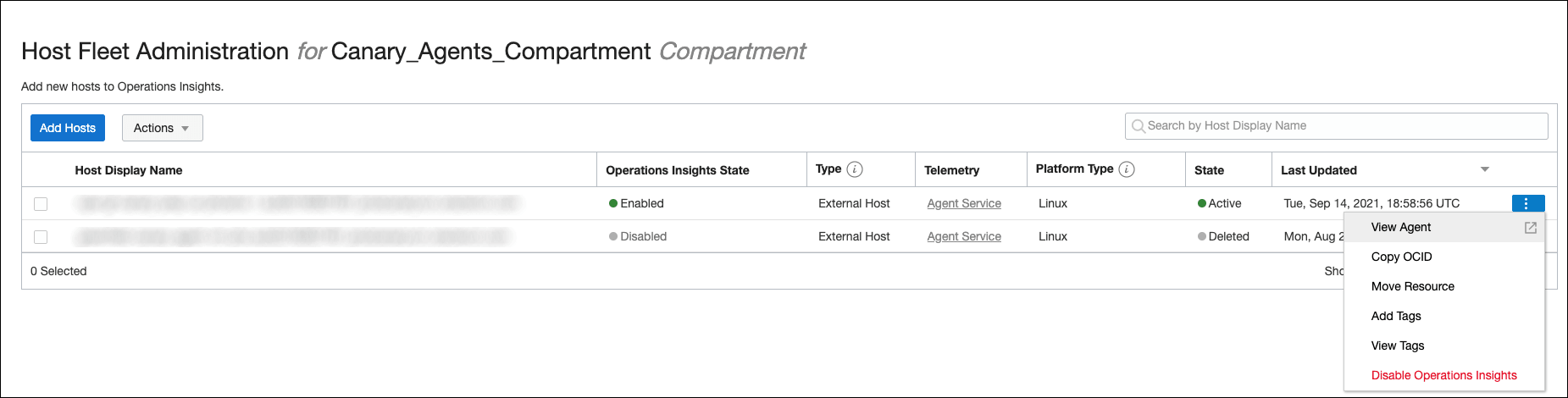

Host Resource Shows as Needs Attention
Oracle Cloud Agent (OCA) enabled host resources show as Needs Attention when reviewing the host fleet page. When reviewing your Oracle Cloud Agents (OCA) on the instances, they are running, however when reviewing under Observability & Management, and selecting Agents, these are not visible. This error is due to insufficient permissions or permission issues to create directory or files under the /var/lib/oracle-cloud-agent/plugins/ path.

  7. Disable and re-enable Host fleet, navigate to OPSI Administration, select Host fleet. First click Disable Ops Insights, once disabled, select Re-enable Ops Insights. After this it will show as Active.
For complete information on OCA plug in management see: Enable Hosts for the Service.
