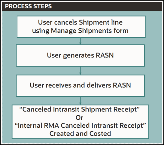

Cancel interorganization shipments process flow

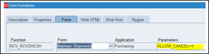

Inventory setup to enable Cancel Shipment flow

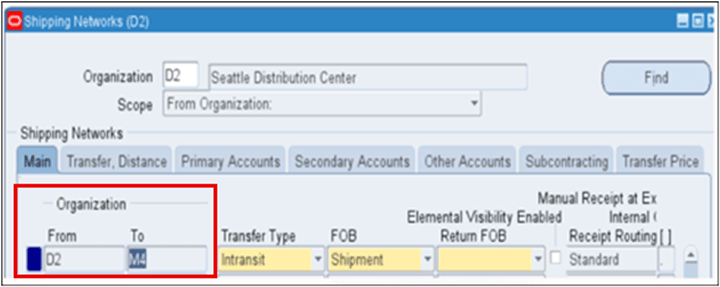

Define shipping network between source and destination organizations

  2. Enable the cancel action in the shipment flow, including the Maintain Shipment form parameter where required.

  • Support material notes with common setup issues around transfer price profiles, shipping networks, and the ALLOW_CANCEL parameter.
