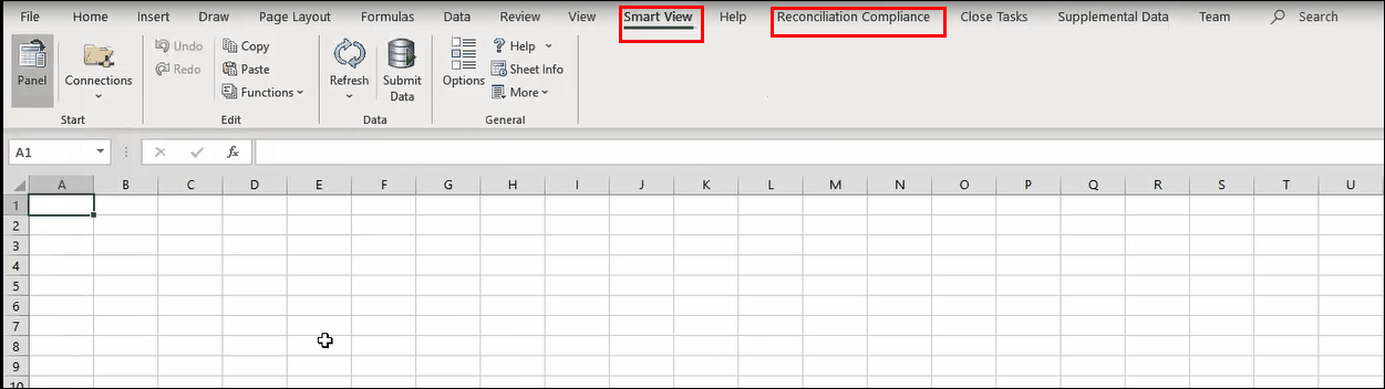

Once the Smartview installation steps are complete, open Excel, and establish the private connection. Note that you see the Smart View menu option as well as Reconciliation Compliance on the Smart View ribbon.
Once you connect. you see the Initialize and Import options are active and ready to use.

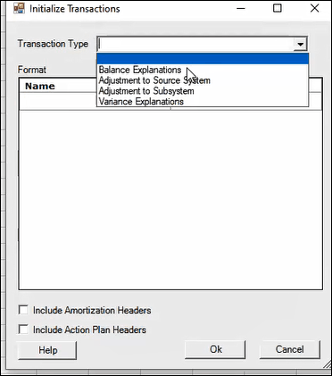

- Click Initialize.
- Select a Transaction Type from the drop down and the list
of formats display for that transaction type.
- Select one or more Formats. The Formats selected will determine which Attributes are created in the header row after the Initialize step is complete.
- You can select the checkbox to Include Amortization
Headers and/or Include Action Plan
Headers. Then click OK. If you leave
these blank, they will not be included in the Header Row.

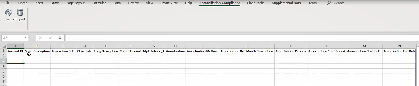

Here's an example of the header row showing the Amortization columns:

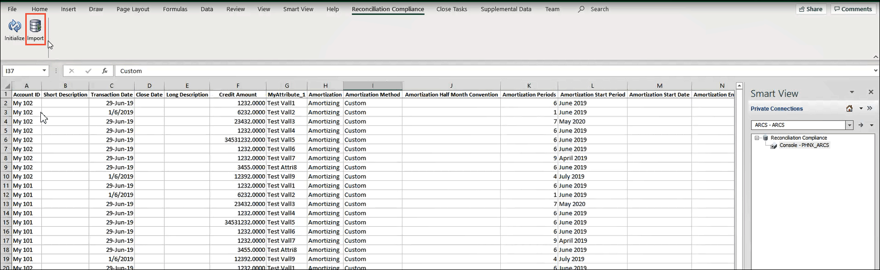

- Make sure your Excel header row is ready and you are connected to the Account Reconciliation instance.
- Create transactions for import in the sheet that has your header row configured.
- In Smart View's Reconciliation Compliance ribbon, click Import.

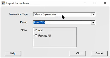

The Import Transactions dialog displays. You can change the Transaction Type if you wish.
Select the period from the drop down of Open and Closed periods.
You can load transactions for a period whether or not reconciliations are created for that period. Once the reconciliations are created, the transactions are displayed on the Reconciliation. If the reconciliation is deleted, the transactions that were loaded using Smart View still remain in the database.
- Select the import mode of either Add or
Replace All. Then click OK.
Add adds the transactions to your existing
transactions. Replace All replaces your existing
transactions with this new transaction import file.
