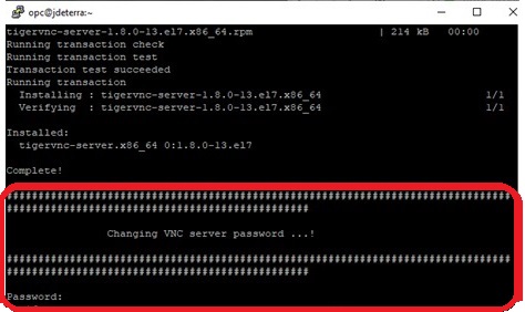

  2. As the first-time configuration script of the OpenTofu staging server runs, the system displays the following prompt. At this prompt, you must set and confirm a password for the VNC server that this first-time configuration script installs and configures on the OpenTofu staging server.
    The password values you enter are masked. As with all password values, you should keep a record of the values that you enter because these values are encrypted and cannot subsequently be retrieved or decrypted.First-Time Configuration—Password for VNC Server

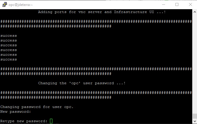

  3. Next the first-time configuration scripts prompts you to enter the password for the opc user. This password will be used by the system to authenticate the opc user that is created by the script.
    The password values you enter are masked. As with all password values, you should keep a record because the values that you enter because these values are encrypted and cannot subsequently be retrieved or decrypted.First-Time Configuration—Password for opc User
