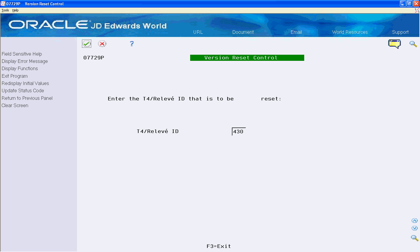

  1. On Version Reset Control, complete the T4/Relevé ID field and click Enter twice.

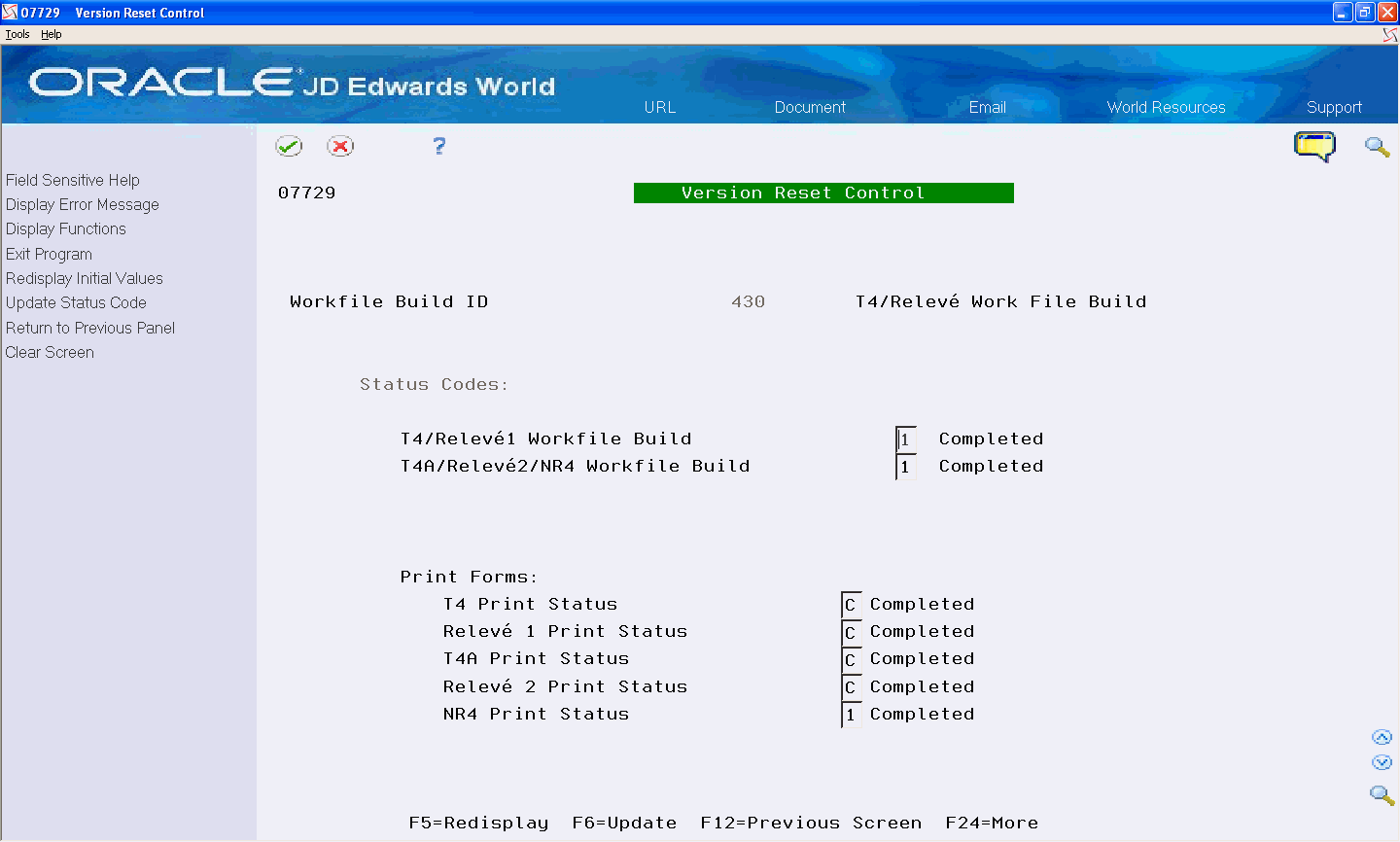

  2. On the ID Reset Control screen, delete the status codes for any of the steps that you need to reset and click Enter.
    This image is described in the surrounding text.
  3. Choose Update Status Code (F6).
