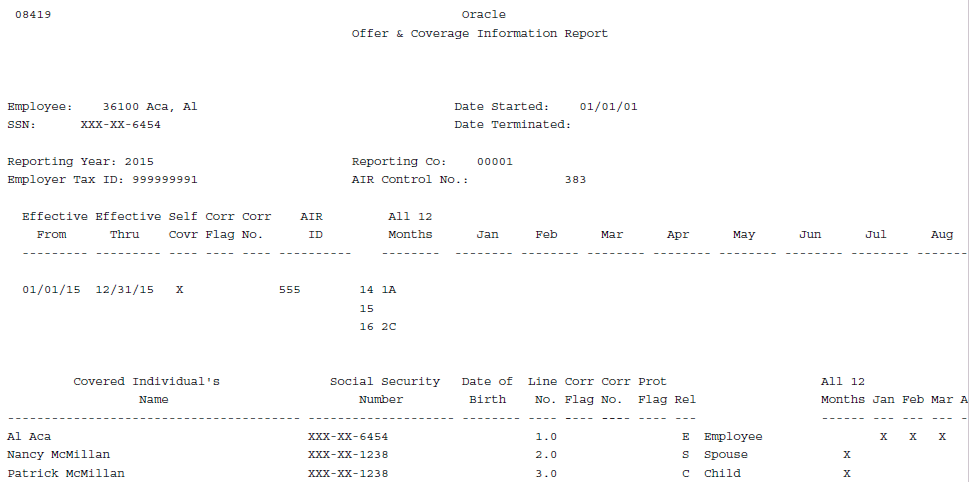

The 1095-C Offer and Coverage Report (R08419) report is run from the reports menu G08ACAR. The Offer and Coverage Workfile report (R08419) reports information from the F08119 and F08120 tables that are created for Form 1095-C Part II and Part III. The report includes the summary and detail records that were created in the reporting workfiles:
The summary record in the report displays the coverage details of the employee for the specified year. Summary records are used for producing Form 1095-C.
The Detail record in the report displays more detailed information that influenced how the summary record was created. Detail records are used only for audit purpose.
It also lists the employee and their dependents under the Covered Individuals section.
After you process the workfile build, review the records using the 1095-C Offer and Coverage Inquiry (P08119) and make any necessary changes before you begin printing Form 1095-C.

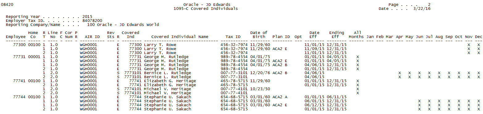

Setting Processing Options and Data Selection for the 1095-C Covered Individuals Report (P08420)
The 1095-C Covered Individuals report can be run as part of the build process, if a version is specified in the processing options for the build job. It can also be run independently from the build from the reports menu (G08ACAR).
The 1095-C Covered Individuals report (P08420) prints the information created during the 1095-C Covered Individuals Build (P08520).
The data selection for the report must be setup the same as the data selection for the build in order to see only the records created during the build. This is because the report can be run independently from the build.
Sample 1095-C Covered Individuals Report
