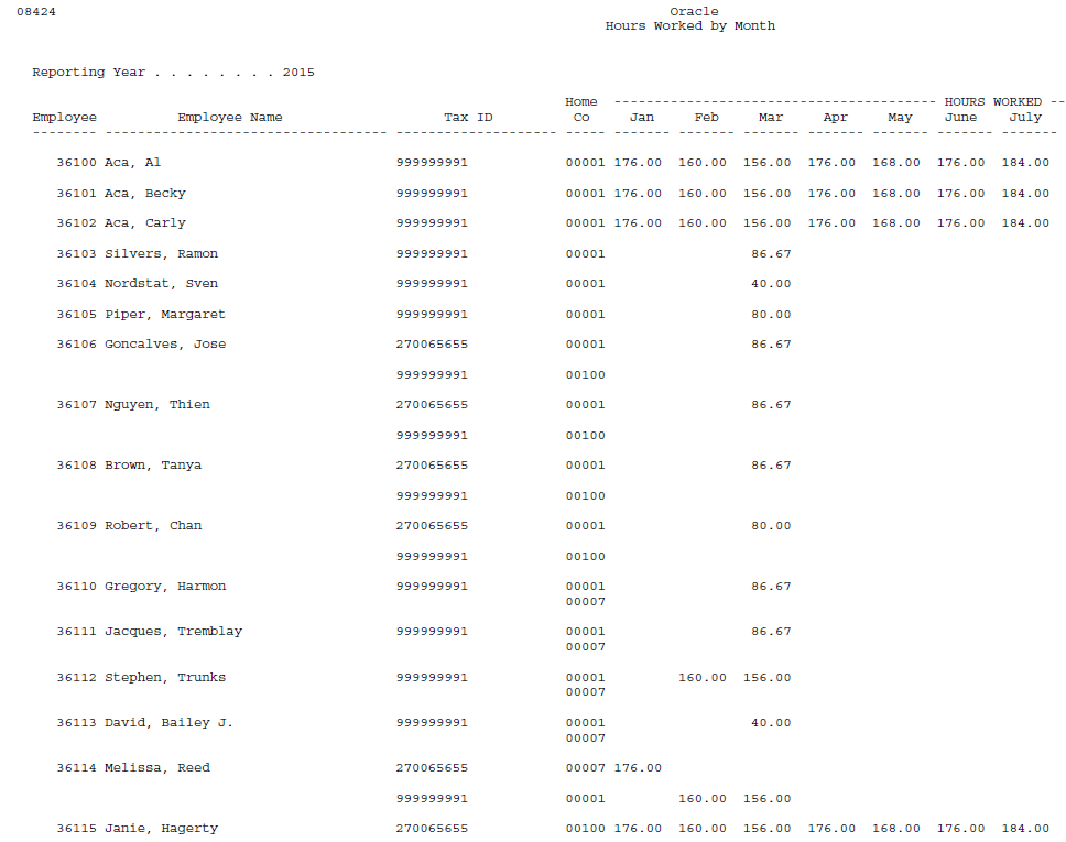

The Hours Worked by Month report is run as part of the build process, if a version is specified in the processing options for the build job. It can also be run independently from the build from the reports menu (G08ACAR).
Sample Hours Worked by Month Report
