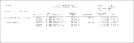

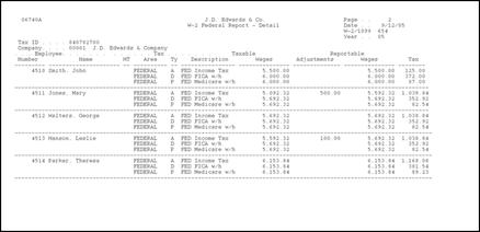

Reviewing the Federal Detail Report (P06740A)
This Report displays the taxable wages, adjustments, adjusted wages and taxes for the various federal tax types for each tax type that is applicable for a given employee.
If you choose the detail version of this report, the report lists the following information by employee:
  • All federal taxable wages
  • Special adjustments
  • Reportable wages
  • Taxes paid
Navigation
From W-2 Reports & Forms Setup (G072473), choose Federal Detail Report
Processing Options
Data Selection
The Type of Form field must have a value of 0 to insure that you are reporting W-2 records for the employees.
Data Sequence
The data sequence is hard coded and any changes to the report will cause a program error.
Example: Federal Detail Report

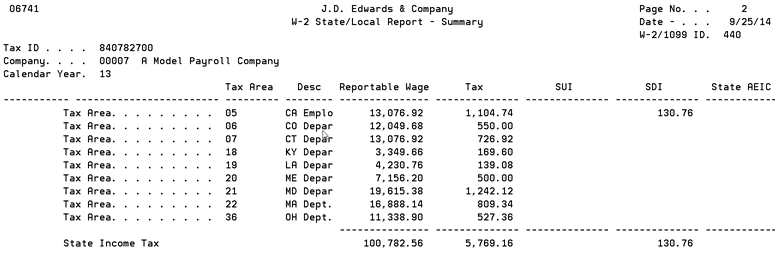

Reviewing the W-2 State/Local Report (P06741)
The W-2 State/Local Control Report allows you to print the detail information for the State/Local Wages and Taxes.
Navigation
From Additional Year End Reports & Forms (G072474), choose W-2 State/Local Report
Data Sequence
To print summary information correctly, you cannot have Page Skip equal to Y for Work State, Work City, and Work County. To print detail and summary information, Page Skip can equal Y for Work State, Work City, or Work County.
Example: W-2 State/Local Report (P06741)

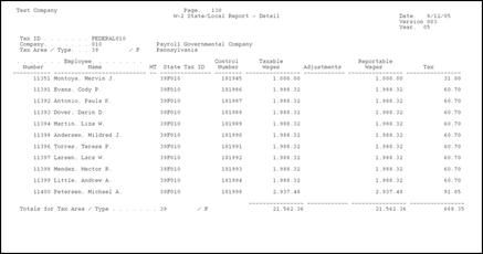

Reviewing the State/Local Detail Report (P06741A)
The State/Local Detail report prints the following information:
  • State and local taxable wages
  • Special handling adjustments
  • Reportable wages
  • Tax by employee, tax area, and tax history type, as reported on the W-2 forms
If you choose summary information, the report lists detail by company, tax area, and tax type.
Navigation
From W-2 Reports & Forms Setup (G072473), choose State/Local Detail Report
Processing Options
Data Selection
Type of form must have a value of 0 to insure that you are reporting W-2 records for the employees.
Data Sequence
The program is hard coded and any change to the data Sequence causes an error.
Example: State/Local Detail Report

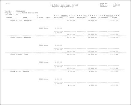

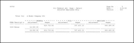

Reviewing the W-2 Federal Adjusted Wage Detail Report (P06743)
The W-2 Federal Adjusted Wage Detail Report lists taxable wages and any special handling adjustments for FIT, FICA, and Medicare. This report groups the information by employee if you choose detail information or by company if you choose summary information. This report also lists error messages if the adjusted wages on the report do not match the adjusted wages on the W-2.
Navigation
From W-2 Reports & Forms Setup (G072473), choose Federal Adjusted Wage Report
Processing Options
Data Sequence
JD Edwards World recommends that you do not change the data sequence.
Example: Federal Adjusted Wage Detail Report
This image is described in the surrounding text.

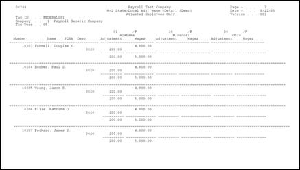

Reviewing the W-2 State/Local Adjusted Wage Detail Report (P06744)
The W-2 State/Local Adjusted Wage Detail Report prints employees' taxable wages, fringe benefits, and reportable wages, as reported on the individual W-2 forms. A processing option allows you to specify up to three states or localities for which to print this information. This report also prints error messages if adjusted wages on the report do not match adjusted wages on the W-2.
Navigation
From W-2 Reports & Forms Setup (G072473), choose State/Local Wage Adjustments
Example: W-2 State/Local Adjusted Wage Detail Report

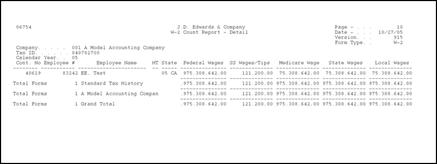

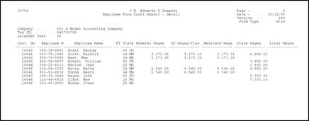

Reviewing the Form Count Reports (P06754)
These reports provide a listing of the form you submit to employees. It lists the total amount of earnings for employees that are on the forms.
This report lists federal, state, and local reportable wages by employee, as well as an employee count by company and tax ID as reported on the individual forms. If you choose summary information, only the company and tax ID totals appear.
From this menu selection, you can run the following reports:
  • W-2 and W-2C Count Report (Summary or Detail)
  • 499R-2 Count Report (Summary or Detail)
  • 1099-R Count Report (Summary or Detail)
  • 1099-Misc. Count Report (Summary or Detail)
Navigation
From W-2 Reports & Forms Setup (G072473), choose W-2 Count Report
Processing Options
Data Sequence
JD Edwards World recommends you do not change the data sequence.
Example: Form Count Report

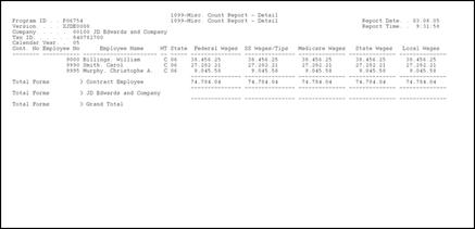

Example: 1099-MISC Count Report

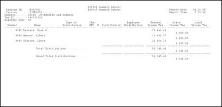

Reviewing the 1099-R Summary Report (P067561)
This report allows you to review all of the retirement or pension amounts earned by employees within a given company and version.
The 1099-R Summary report lists all of the information that displays on 1099-R forms for pension employees. You should consider producing this report as a mandatory step in the year-end process and it is mandatory if you are creating 1099-R forms during the payroll year-end process. This is the only report that lists all of the data on each employee's 1099-R form.
Navigation
From Additional Year End Reports & Forms (G072474), choose 1099-R Summary Report
Processing Options
Data Selection
You must have Type of Form equal to 5 for the report to run properly.
Data Sequence
Example: 1099-R Summary Report

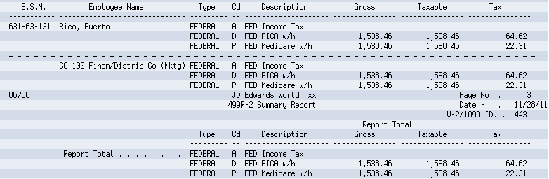

Reviewing the 499R-2 Summary Report (P06758)
This report provides a detailed listing of all information pertaining to a 499R-2 and the non-form hardcopy of the 499R-2 that you issue to the employee.
Navigation
From Additional Year End Reports & Forms (G072474), choose 499R-2 Summary Report

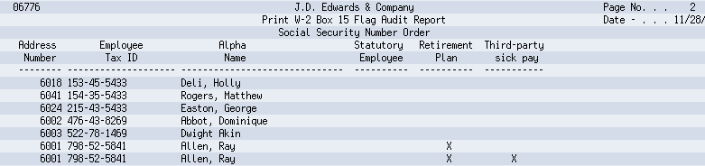

Reviewing the W-2 Box 13 Flag Audit Report (P06776)
The W-2 Box 13 Flag Audit Report lists which employees have information that prints in Box 13 of the W-2 form.
Navigation
From Year End Processing (G07247), choose Audit Reports
Example: W-2 Box 13 Flag Audit Report

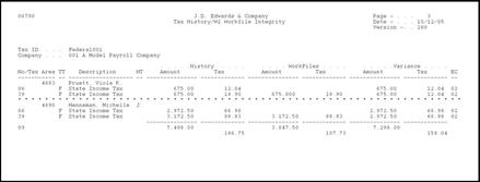

Reviewing the Tax History/W-2 Workfile Integrity Report (P06790)
Once you build and balance the workfiles, there can be occasions when you need to modify employee history because of late corrections. Modifications might include manual or void checks that you did not process promptly or DBA's which were previously unidentified. When you process these items through the standard payroll cycle or update them directly into the history, the integrity report creates a variance. The main purpose of this integrity report is to identify employees with variance amounts so you can correct the information, by running a Changes Only workfile, before printing year end forms.
The Tax History/W-2 Workfile Integrity Report lists any variances by employee when comparing the actual W-2 forms to the payroll history tables. The EC (Error Code) column identifies the error numbers that appear on the error table at the end of the report. This table lists which integrity test the system performs to identify the variance.
This report displays variances between the following history files and the W-2/1099 Workfile build files:
  • Taxation Summary History (F06136)

The report includes the following fields and descriptions:
  • Tax Area, Tax Type, Description of the Problem
  • History Type, History Amounts and Taxes
  • Workfile Amounts and Taxes
  • Variance Amounts and Taxes
  • Error Code (EC)
The EC column prints a numeric error code (01-06) that identifies which history files and W-2 workfiles contain errors.
Following are the error codes for this report:
  • 01 = Tax History Taxable Wage VS. W-2 Workfile (Federal)
    When this error occurs, the program locates a variance between the Federal Taxation History (F06136) and the W-2 Employee Federal Control Record (F6730) files. This error can occur on each of the employee's Federal tax records and on each company in which the employee worked. This variance is for only Federal Taxes Areas and Tax Types.
  • 02 = Tax History Taxable Wage VS. W-2 Workfile (State/Local)
    When this error occurs, the program locates a variance between the State and Local Taxation History (F06136) and the Employee State/Local Control Record (F06731) files. This error can occur on each State record and on each company in which the employee worked. This variance is for only Tax Areas and Tax Types.
  • 03 = Transaction Summary VS. W-2 Workfile (Federal)
    When this error occurs, the program locates a variance between the total Transaction History file (F06146) and the PDBA's in the Special Handling Tables that create the Employee Federal Control Record file (F06730). This error can occur on the following forms and boxes:
    • W-2 Forms:
      • Box 11 - Non-qualified Plans
      • Box 10 - Dependent Child Care
      • Box 12 - Benefits included in Box 1
    • Magnetic Media (W-2)
      • Fringe Benefit Amounts
      • Deferred Compensation
      • Non-Qualified Non 457 Amounts
      • Dependent Child Care
      • Group Term Life
    • 1099-R Forms
      • Non-Qualified Plan Income
      • Gross Distributions
      • Employee Contributions
    • 1099-Misc Forms
      • Rents
      • Royalties
      • Prizes and Awards
      • Non-Employee Compensations
      • Medical and Health
      • Substitute Payments
    • 1099-NEC Forms
    • 499R-2 Forms
      • Commissions
      • Concessions
      • Reimbursed Expenses
      • Retirement Funds
      • CODA Plans
    If the total of the PDBA's in a Special Handling table does not match the grand total in the field, the program issues an error.
  • 04 = Transaction Summary VS. W-2 Special Handling Workfile
    When this error occurs, the program locates a variance between the Transaction History file (F06146) defined in a Special Handling Table and the Employee Special Handling Control Record file (F06732). This error can occur when you enter Special Handling Table codes for the W-2 form, in the following boxes:
    • Box 13 - Statutory employee, Retirement plan, Third-party sick pay
    • Box 14 - Other
    The program is comparing each Special Handling record to a related Transaction History record. Because each DBA in the Special Handling Table must be handled separately, the program performs the comparison on a record by record basis. If a variance exists, the program issues an error.
  • 05 = Tax Area Trans. History VS. W-2 Special Handling Workfile
    When this error occurs, the program locates a variance between the Tax Area Transaction History file (F06148) and the PDBA's defined in a Special Handling Table that create the Employee Special Handling Control Record file (F06732). The only time this error occurs is when you enter Special Handling Table codes for any of following boxes on the W-2 form:
    • Box 17 - State Wages, tips, etc.
    • Box 20 - Local wages, tips, etc.
    The program is comparing each Special Handling record to the related Tax Area Transaction History record. Because each DBA in the Special Handling Table must be handled separately, the program performs the comparison on a record by record basis.
  • 06 = Arreared Payroll Taxes VS. W-2 Special Handling Workfile
    When this error occurs, the program locates a variance between the Federal Taxation History (F06136) and the Employee Special Handling Control Record files (F06732). This error identifies variances when it encounters an arrearage in FICA and Medicare taxes and the system creates unique Special Handling records to accommodate the following codes in Box 13:
    • A - Uncollected FICA on Tipped Employees
    • B - Uncollected MEDICARE on Tipped Employees
    • M - Uncollected FICA on Group Term Life
    • N - Uncollected MEDICARE on Group Term Life
      The only time that an A or B Special Handling can occur is when the employee is defined as a Tipped Employee in the Basic Employee Data. If the program finds FICA or Medicare taxes in arrears on a non-tipped employee, the Special Handling record creates codes M and N to note the uncollected taxes.
      The program is comparing each Special Handling record to the related Tax History record.
Navigation
From W-2 Reports & Forms Setup (G072473), choose W-2 Workfile Integrity
Processing Options
Data Sequence
Example: Tax History/W-2 Workfile Integrity Report
