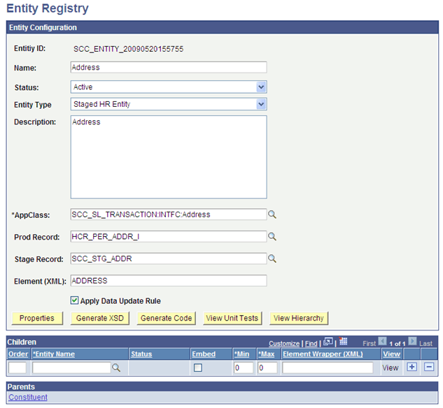

This example illustrates the fields and controls on the Example of the entity created for Address. You can find definitions for the fields and controls later on this page.
