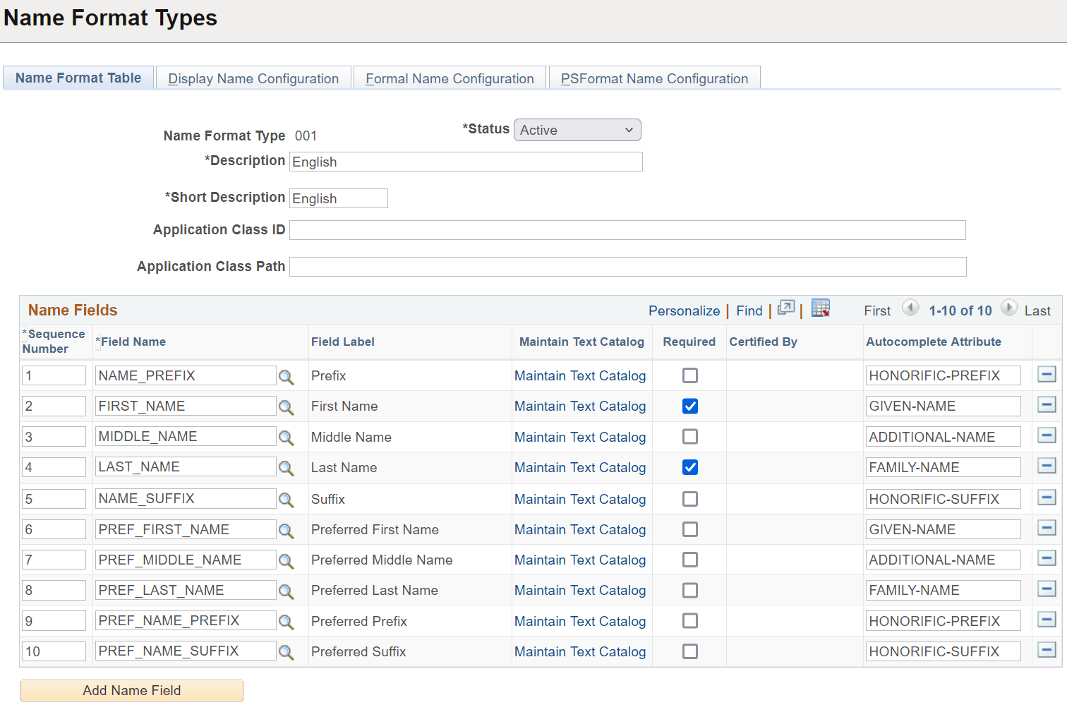

Defining Name Format Types and Fields
Access the Name Format Table page Set Up Common Objects, and then Foundation Tables, and then Personal , and then Name Format Types, and then Name Format Table).
This example illustrates the fields and controls on the Name Format Table page. You can find definitions for the fields and controls later on this page.
Use this page to define name format types and fields that appear on name pages throughout CS. You can identify which fields are available for the format type, in what order they should be displayed for data entry, what labels are used, and whether or not a field is required.
Important:
You should always run the Refresh Name Display process whenever you make changes in this component.
Field or Control Description
Application Class ID and Application Class Path
Enter the application class ID and page of the application package, which store the path of the extension code. Basic name formatting and all name validation are in the PeopleCode application class HCR_NAME:NameFormat. When the basic formatting or validation is not enough for a particular name format, you can extended the class. PeopleSoft delivers extensions that are done for the Chinese, German, Japanese, Mexican and Netherlands name formats.
Sequence Number
Enter a numeric value to indicate the default order in which you want the name fields to appear on the data entry pages for names. By default, the system sets the first row to one and incrementally increases the value by one for each additional row that you insert.
Field Name and Field Label
Select the name fields you want to display on the Name page for this format type. The field label is stored in the Text Catalog.
Maintain Text Catalog
To view or update the label, see Campus Self Service: Defining Text Catalogs.
To change the label for one name format only, add a row in the Context Keys and Text area on the Maintain Text Catalog page and indicate the format and text for that format.
Required
Indicate whether this field is required to be entered for this name format. Users will not be able to save a name if this field is not entered.
Certified By
(DEU, NLD) Indicate the certifying authority for the Royal Name Prefix and Suffix fields. Valid values are defined on the Royal Name Prefix and Royal Name Suffix pages.
Autocomplete Attribute
Define a value that will be used for the autocomplete attribute on the HTML pages for name entries. This allows browsers to autopopulate the field.

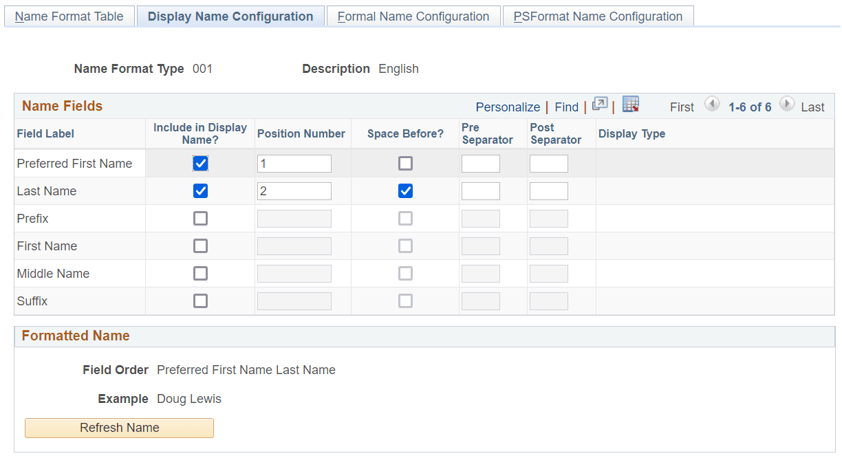

Configuring the Display Name
Access the Display Name Configuration page (Set Up Common Objects, and then Foundation Tables, and then Personal, and then Name Format Types, and then Display Name Configuration).
This example illustrates the fields and controls on the Display Name Configuration page. You can find definitions for the fields and controls later on this page.
Use this page to configure how to display the name that appears throughout CS.
The fields that appear in the Name Fields group box are the ones you added on the Name Format Table page.
Important:
Include in Display Name
Select this check box to ensure that this field value displays when showing the individual's Display name (NAME_DISPLAY field). When you select this option, other fields on this row will become available.
Position Number
Enter a numeric value to indicate the order in which you want the name fields to appear on the formatted Display name page. By default, the system sets the first included field to one and incrementally increases the value by one for each additional field that is included.
Space Before
Select this check box to indicate that there should be a space before this name field. For example, if a name field displays after another field, you may want to ensure that there is a space between the field values by selecting this option.
Pre Separator or Post Separator
Enter a character that should display before or after this field value. For example, if you are showing the name for a person in Japan, you can choose to enclose the alternate character name for the person in parenthesis.
Display Type
For the Name Suffix, Name Prefix, Title, Name Royal Suffix, and Name Royal Prefix fields, the system enables you to select how to show the field value. Options include:
  • Long Description
  • Short Description
  • Value
By default, Value is selected. This means that the actual code is used and will not be translated when it is included in the Display name, (e.g., Mrs Jane Smith will be displayed in English and also in French. If the Short Description or Long Description is selected, the translated value will be used. For example, a display name showing Mister John Smith in English would read Monsieur John Smith in French).
Formatted Name
Field Order
Displays the order based on Position Number.
Example
Shows a sample name based on Position Number.
Refresh Name
Click this button to have the Example field show how the name appears with the current settings.

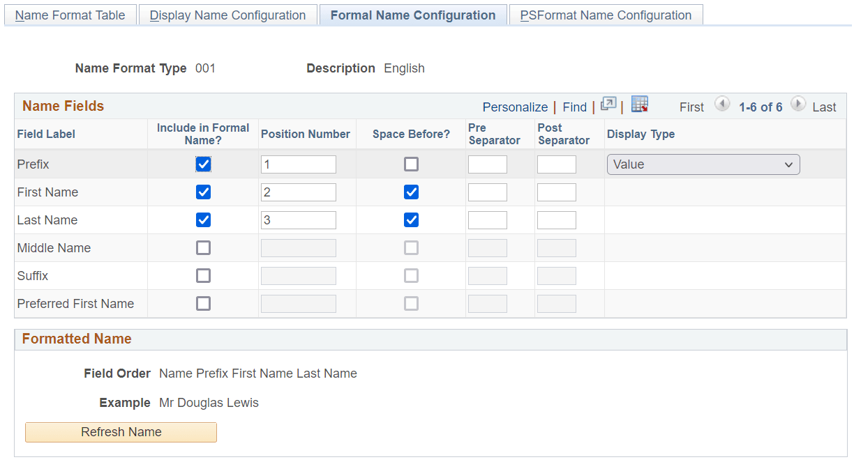

Configuring the Formal Name
Access the Formal Name Configuration page (Set Up Common Objects, and then Foundation Tables, and then Personal, and then Name, and then Format Types, and then Formal Name Configuration).
This example illustrates the fields and controls on the Formal Name Configuration page. You can find definitions for the fields and controls later on this page.
Use this page to build the individual's formal name (NAME_FORMAL field). This name can be used in correspondence/reporting.
The setup for this page is similar to that on the Display Name Configuration page.
Important:
You should always run the Refresh Name Display process when you make changes in this component.

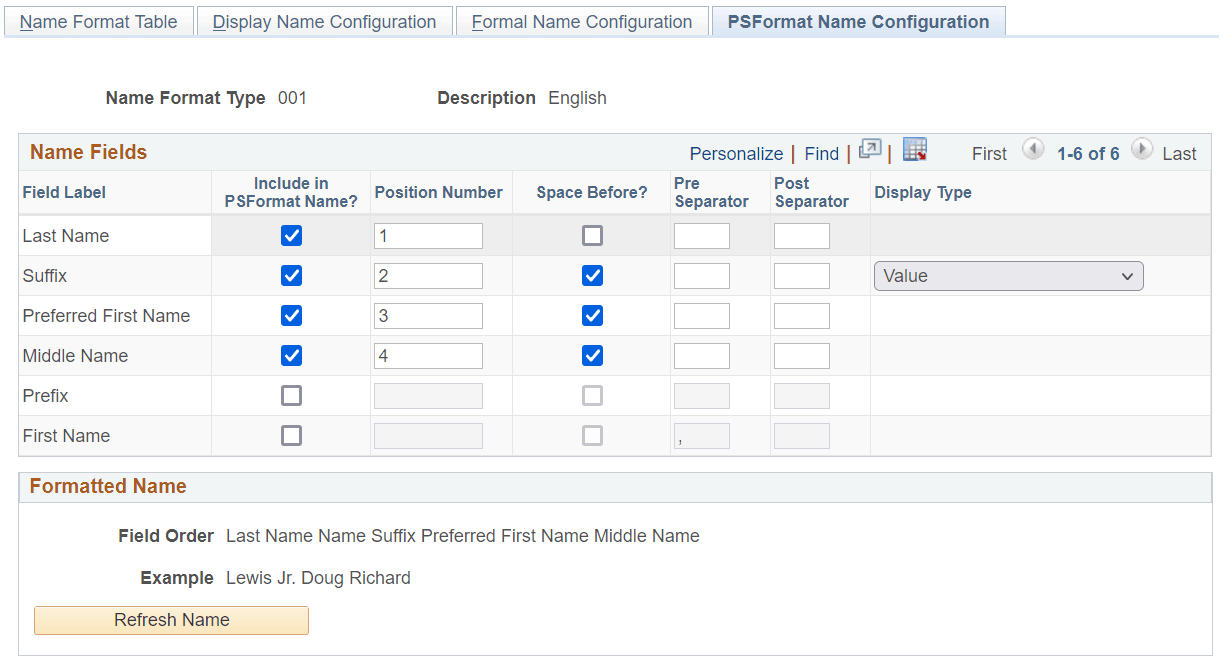

Configuring the PeopleSoft Name
Access the PSFormat Name Configuration page (Set Up Common Objects, and then Foundation Tables, and then Personal, and then Name, and then Format Types, and then PSFormat Name Configuration).
This example illustrates the fields and controls on the PSFormat Name Configuration page. You can find definitions for the fields and controls later on this page.
Use this page to build the employee's PeopleSoft Name (NAME field). This name appears in search results.
The NAME field uses the PeopleSoft Name field format, which automatically removes any spaces before and after the first comma that is included in the name. Because of this, there is no use selecting the Space Before option for a name component immediately following or preceding the first comma separator.
Important:

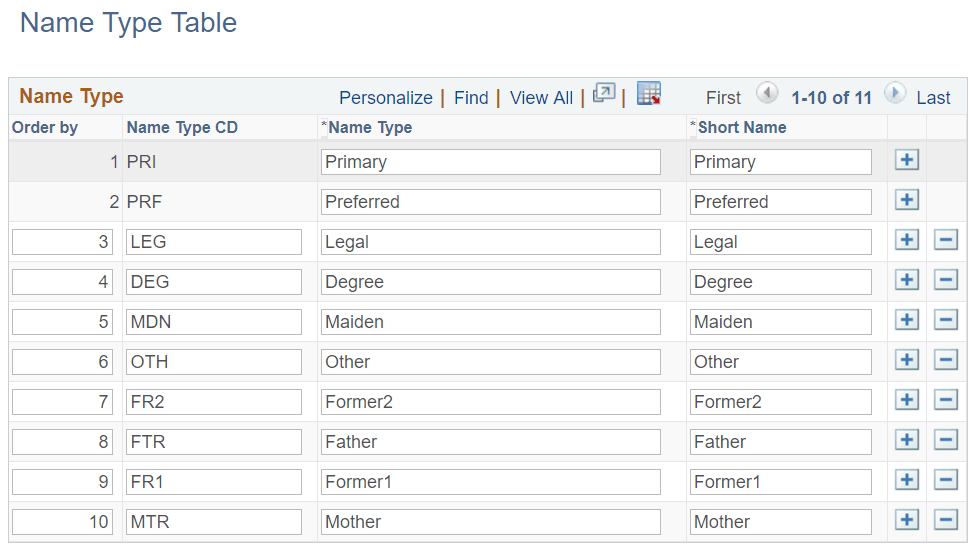

Defining Name Types
Access the Name Type Table page (Set Up Common Objects, and then Foundation Tables, and then Personal, and then Name Type, and then Name Type Table ).
This example illustrates the fields and controls on the Name Type Table page. You can find definitions for the fields and controls later on this page.
Order By
Enter the order in which the system should make this name type available.
You won't be able to delete or reorder the Primary and Preferred name types because they are system data.
If you make changes to this table, you should consider if you need to make changes to the corresponding description for the name type in FERPA Setup for the NAMES_FERPA_VW record table (Set Up SACR, and then Product Related, and then Campus Community, and then Establish People Processing, and then Setup, and then FERPA Control).
