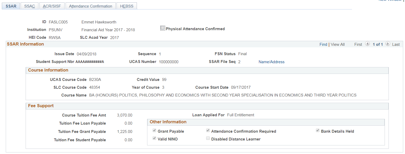

Viewing SSAR Student Data
Access the SSAR page (Financial Aid, and then Student Loans Company, and then View SLC Student Data, and then SSAR).
This example illustrates the fields and controls on the SSAR page. You can find definitions for the fields and controls later on this page.
SSAR (Student Support Attendance Request) page
Use this page to view the details of students' SSAR records. The page is view-only with the exception of the Tuition Fee Loan Payable and Tuition Fee Grant Payable fields. These fields can be updated for Scottish students whose SSNs begin with SAAS.
Field or Control Description
Physical Attendance Confirmed
Select this check box to indicate that a student's physical attendance on the campus has been confirmed. This check box can be selected on this page or set by the institution's custom process.
SSAR Information
Issue Date
Displays the issue date of the SSAR.
Sequence
Displays the internal sequence number used to indicate the version of the individual student's SSAR file.
SSAR File Seq (Student Support Attendance Requests file sequence number)
Displays the sequence number, which is unique within the SLC for the HEI, academic year, and file type.
Fee Support
Displays the portion of the fee paid by TFL.
Note: You can update this field for Scottish students whose SSNs begin with SAAS.
Displays the portion of the fee paid by the TFG.
Loan Applied For
Displays the type of loan for which the student applied. Values are:
  • F (Full Entitlement)
  • P (Part Entitlement)
  • N (No loan applied for)

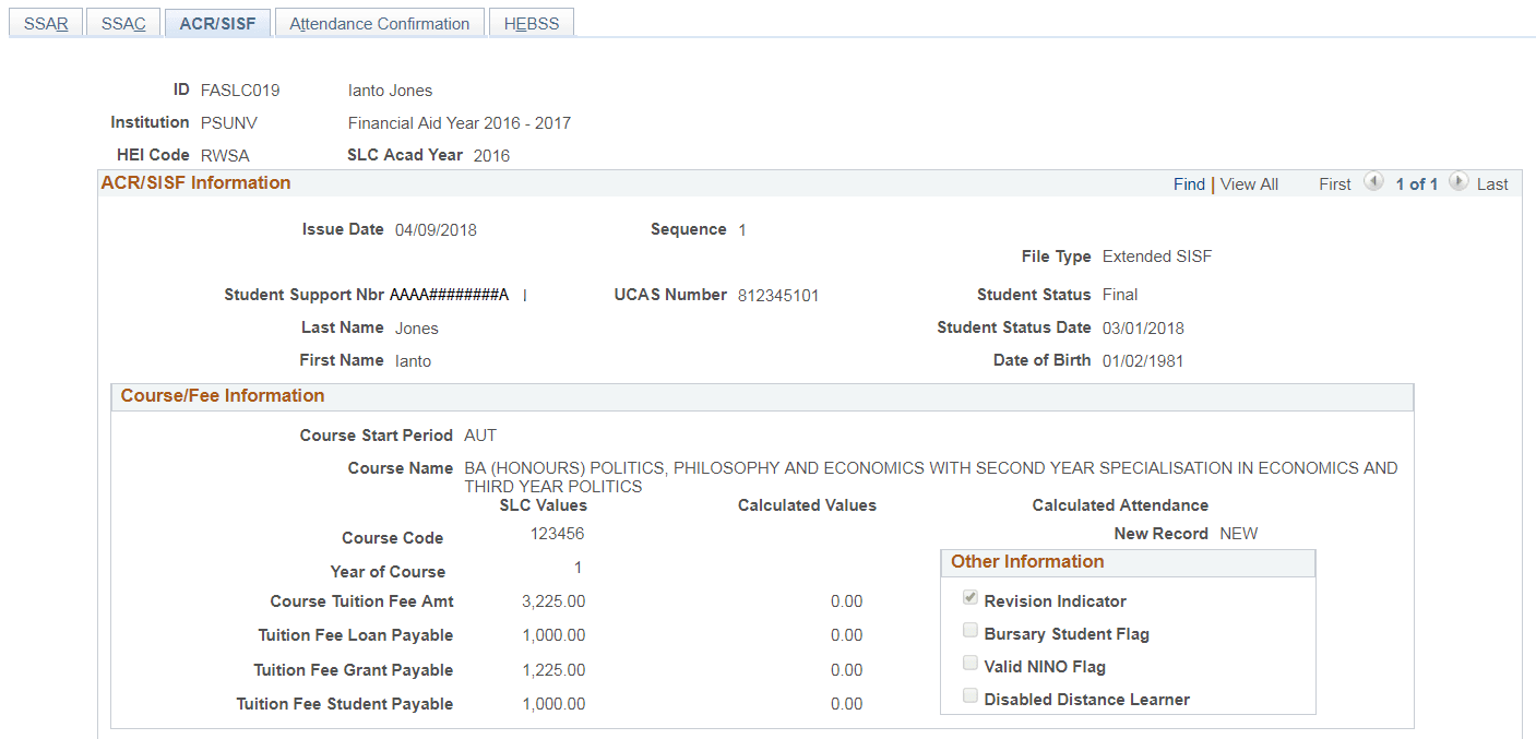

Viewing ACR and SISF Student Data
Access the ACR/SISF page (Financial Aid, and then Student Loans Company, and then View SLC Student Data, and then ACR/SISF tab).
This example illustrates the fields and controls on the ACR/SISF page 1 of 2). You can find definitions for the fields and controls later on this page.
ACR (Attendance Confirmation Report)/SISF (Student Information Service File) page (1 of 2)
This example illustrates the fields and controls on the ACR/SISF page 2 of 2). You can find definitions for the fields and controls later on this page.
ACR (Attendance Confirmation Report)/SISF (Student Information Service File) page (2 of 2)
Use this page to view the details of ACR or SISF data for students.
All fields on this page, except for the Attendance Indicator field, are view-only.
ACR/SISF Information
Issue Date
Displays the date that the ACR/SISF was issued.
This field appears only if the value in the File Type field is Attendance Confirmation Reqst.
The field contains a list of At Fee Code values that can be manually set on this page. You can manually set this field instead of running the Evaluate ACR process.
File Type
Displays the File Type:
  • Attendance Confirmation Reqst (attendance confirmation request).
  • Extended SISF.
  • Short Course Attendance.
  • Student Information Service.

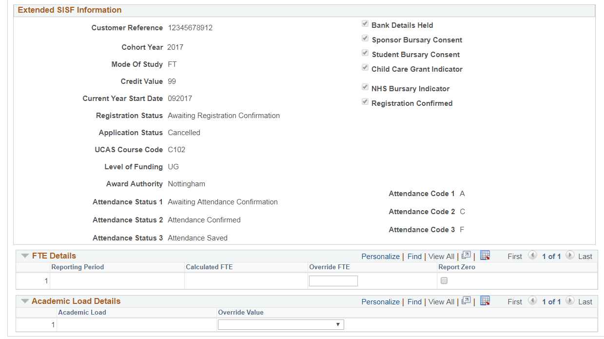

If the value is Extended SISF, the Extended SISF Data group box appears.
Student Status Date
Displays the date that the student's status was assigned or updated.
Course/Fee Information
Course Start Period
Displays the period when the course starts, for example AUT (Autumn).
New Record
Indicates whether the record appeared on a previous ACR.
Course Code
Displays the UCAS code or SLC code that is assigned to the course.
Note: For this field, and the remaining fields in this group box, values appear in both the SLC Values and Calculated Values columns. The values in the SLC Values column come from the context ACR or SISF record. The values in the Calculated Values column appear after the ACR At Fee Evaluation process is run.
Other Information
Revision Indicator
Indicates whether the record has changed since a previous ACR/SISF.
FTE Details
Override FTE
Enter a value here and save to override the Calculated FTE.
Report Zero
Select this check box to report FTE of zero.
Once you have overridden a student's FTE or selected Report Zero for a student's FTE for a Liability Period then that overridden or zero value remains until manually removed, even if the Calculate FTE process is rerun.
Academic Load Details
Academic Load
Displays the student's Academic Load from the ACR.
Override Value
Enter a value here and save to override the student's Academic Load.

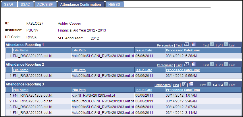

Viewing Attendance Confirmation Data by Liability Period
Access the Attendance Confirmation page (Financial Aid, and then Student Loans Company, and then View SLC Student Data, and then Attendance Confirmation tab).
This example illustrates the fields and controls on the Attendance Confirmation page. You can find definitions for the fields and controls later on this page.
You can use this page to view details of attendance confirmation file information sent for the three SLC Liability Periods. There is a group box for each of the Liability Periods: Attendance Reporting 1, Attendance Reporting 2, and Attendance Reporting 3.

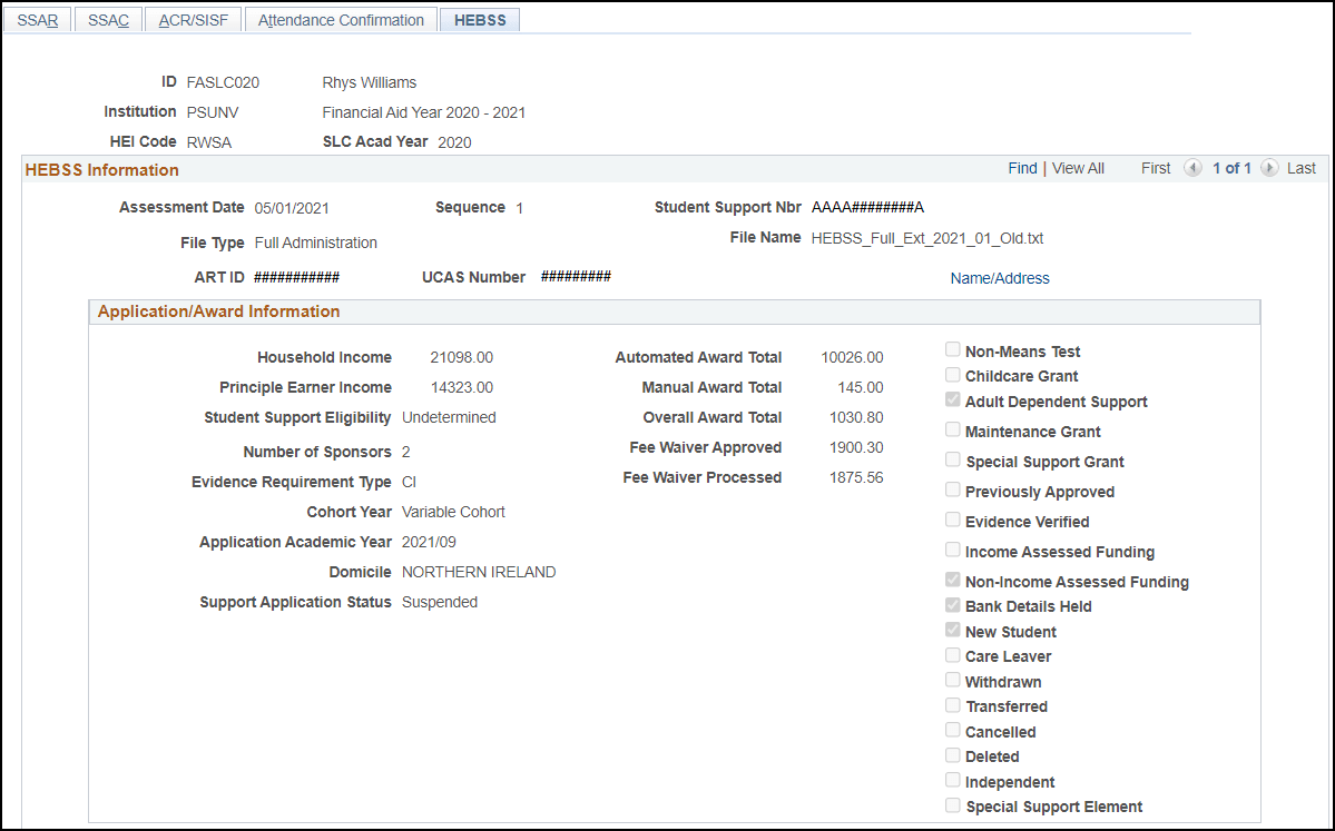

Viewing HEBSS Student Data
Access the HEBSS page (Financial Aid, and then Student Loans Company, and then View SLC Student Data, and then HEBSS tab).
This example illustrates the fields and controls on the HEBBS page. You can find definitions for the fields and controls later on this page.
HEBSS (Higher Education Bursary and Scholarship Scheme) page (1 of 2)
This example illustrates the fields and controls on the HEBSS page (2 of 2). You can find definitions for the fields and controls later on this page.
HEBSS (Higher Education Bursary and Scholarship Scheme) page (2 of 2)
You can view the details of the student's HEBSS data on this page. This page is view-only.
For information about the fields in the Application/Award Information group box, refer to the information about the group box in the Manage HEBSS Suspensions section.
HEBSS Information
Assessment Date
Displays the date the customer record was entered or updated on the Higher Education (HE) portal.

Course Information
Qualification
Displays the qualification achieved.
Method of Attendance
Displays the method of attendance. Values are:
  • Full Time
  • Part Time
  • PGCE (post graduate)

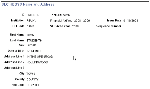

Viewing HEBSS Name and Address Data
Access the SLC HEBSS Name and Address page (click the Name/Address link on the HEBSS page).
This example illustrates the fields and controls on the SLC HEBSS Name and Address page.
SLC (Student Loans Company) HEBSS (Higher Education Bursary and Scholarship Scheme) Name and Address page
Use this page to help determine whether you are matching to the correct person.
