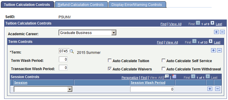

Access the Tuition Calculation Controls page (Set Up SACR, and then Product Related, and then Student Financials, and then Tuition and Fees, and then Tuition Calculation Controls).
This example illustrates the fields and controls on the Tuition Calculation Controls page. You can find definitions for the fields and controls later on this page.
The wash functionality contains three levels: session, term, and transaction, and are mutually exclusive.
You must establish tuition controls for each active academic career for each term.
Field or Control Description
Academic Career
Select the academic career for your tuition calculation controls.
Term Controls
Term
Select the term to which these controls apply.
When you add a new term, a message appears: Warning — Term has not been setup for Installment Control. To set up the term so that ITEM_SF installments can be applied, go to the Installment Controls tab.
Term Wash Period
The term wash period indicates the number of days that a student can drop and add classes of equal value (wash) without penalty. This is not the same as a drop/add period in which students are allowed to make any changes. The term wash period typically extends beyond the normal drop/add period to accommodate students who must make changes to their enrollment.
For example: a student enrolls in Chemistry 101 and determines, after two weeks in class, that he or she is too advanced for the introductory level class. If the term wash period is at least 14 days, the student can switch to Chemistry 201 without penalty.
Term wash is not based on class or class cost, but is based on billing units of the class.
Note: If you drop a three-unit class, then add a two-unit class, the tuition calculation process ignores this field and applies the normal adjustment rules. The process assumes that the three-unit class is more expensive. However, if you drop a three-unit class, then add a four-unit class, the drop is “washed.” Even if you drop two two-unit classes, then add a four-unit class, the two dropped classes are washed.
Transaction Wash Period
Enter a number of days for a transaction wash period. The transaction wash period allows students a period of time in which to complete a wash transaction. That is, the student does not need to drop and add the wash classes at the same time. Rather, as long as the replacement class or classes are added within the transaction wash period, no penalty is incurred. If the drop and add take place outside both the term wash and transaction wash periods, the student is charged the prorated amount of the dropped class and the full amount of the added class.
Auto Calculate Tuition (automatically calculate tuition)
Select to automatically calculate tuition whenever you inquire on a student's account. This feature enables you to see the most up-to-date tuition information without having to run a separate tuition calculation.
Auto Calculate Self Service
Select to automatically calculate tuition for a particular term in self service. If you select the check box, a student using self service can see the most up-to-date tuition information without you having to run a separate tuition calculation.
In self service, the system calculates tuition when a student accesses the Account Inquiry or the Make a Payment component. The system does not automatically calculate tuition when a student accesses the Student Center. In addition, tuition calculation is never invoked from the Student Services Center or Student Services Center (Student).
Note: This option impacts only self service, in contrast to the Auto Calculate Tuition option that impacts only the administrative module. You can choose to enable automatic tuition calculation for self service, administrative module, or both.
The check box is cleared by default.
Note: In addition to selecting this check box, you must also select automatic self service tuition calculation elsewhere in the system, for tuition calculation to be invoked in self service. You must select the check box here for automatic self service tuition calculation to have effect for a particular term.
See Campus Self Service: Defining Basic Institution Set Parameters.
Auto Calculate Waivers (automatically calculate waivers)
Select to automatically calculate student waivers whenever tuition is calculated. If you select this option, Student Financials calculates a student's tuition first, and then automatically applies all tuition waivers against the student's final tuition amount. If you do not select this option, the system does not calculate or post tuition waivers, so you must calculate and post waivers in background processing.
Auto Calculate Term Withdrawal (automatically calculate term withdrawal)
When this check box is selected, an administrative user can run tuition calculation immediately after the successful completion of an on line term withdrawal, regardless of the user’s security.
See Student Records: Posting Withdrawals and Cancellations for Terms
Session Controls
Session
Enter a session if you want your tuition calculation controls to apply to specific sessions within the term. If you leave this field blank, the controls apply to all sessions in the term.
Session Wash Period
If you choose to apply tuition calculation controls by the session, you must enter a session wash period value. The session wash period works the same as a term wash period.
Session wash is not based on class or class cost, but is based on billing units of the class.

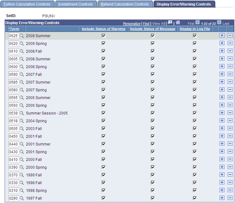

Access the Display Error/Warning Controls page (Set Up SACR, and then Product Related, and then Student Financials, and then Tuition and Fees, and then Tuition Calculation Controls, and then Display Error/Warning Controls).
This example illustrates the fields and controls on the Display Error/Warning Controls page. You can find definitions for the fields and controls later on this page.
The default setting is ON to display warnings and messages. If you do not have a row for the term with these controls cleared, you will continue to receive errors and warnings. Insert a row for every term in which you want to clear warnings and messages.
If an equation contains the equation keyword Message, or the equation produces an error, the message is written to the Tuition Calc log file.
The equation keyword Message may affect performance and should be used primarily in your test environment to verify the results of the equation.
Term
Select the term for the error and warning controls that you are defining.
Include Status of Warning
Select to have warning messages appear in CALC_ERROR. If you do not select this check box, warnings do not appear.
Include Status of Message
Select to have messages appear in CALC_ERROR. If you do not select this check box, messages do not appear.
Display in Log File
Select during your installation process when you want to review log file information. This feature is typically disabled after installation and testing has been completed.
