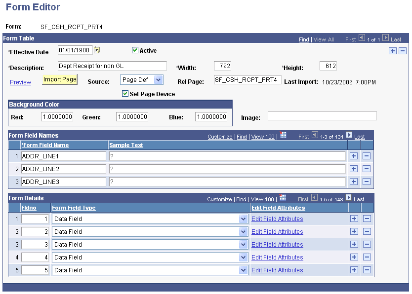

Using Form Editor to Change a Receipt Title and Add an Image
Access the Form Editor page (Set Up SACR, and then Common Definitions, and then Forms Engine, and then Setup, and then Form Editor).
This example illustrates the fields and controls on the Form Editor page. You can find definitions for the fields and controls later on this page.
Form Editor page
Changing a Receipt Title
To change a receipt title:
  1. Scroll to the row with a Fldno (field number) of 12.
  2. Click the Edit Field Attributes link to open the Form Text Attributes page.
  3. Edit the title in the Form Text field.
  4. Click OK and save your changes to the form.
Adding a Cachable Image to a Receipt
To add a cachable image to a receipt:
  1. Insert a row in the field number grid.
  2. Entered a form field type of Image.
  3. Click the Edit Field Attributes link to open the Form Image Attributes page.
  4. Locate and select the desired image.
  5. Specify a start position.
    X is the horizontal distance from the left side of the page, in units of 1/72 of an inch. Y is the vertical distance from the bottom of the page, in units of 1/72 of an inch. For example, if X is 504 and Y is 684, the start position would be 1.5 inches from the upper right corner of an 8.5-inch by 11-inch page.
  6. Specify a scaling factor.
    For example, if the unscaled image is roughly 3 inches square, use an X and Y scaling factor of 0.3 so that the image comes out as one square inch.
  7. Click OK and save your changes to the form.
Adding a Noncachable Image to a Receipt
To add a noncachable image to a receipt:
  1. Enter the name of the image in the Image field.
  2. Save your changes to the form.
