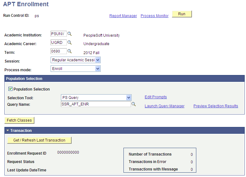

Access the APT Enrollment page (Records and Enrollment, and then Program Enrollment, and then APT Enrollment).
This example illustrates the fields and controls on the APT Enrollment page. You can find definitions for the fields and controls later on this page.
APT (Academic Progress Tracker) Enrollment page
The following values determine the keys that are used to fetch rows from the CLASS_TBL for this run and also determine the values that are used as prompts when defining the student population. If the run control values are Institution: PSUNV, Term: 0690, then the Population Selection query (or a manually entered list of students) must use the same values to select rows from APT (SSR_APT_SCHD).
Field or Control Description
Academic Institution
Select an Institution value.
Academic Career
Select an Academic Career value.
This value is required for prompting against the TERM_TBL (which is keyed by INSTITUTION, ACAD_CAREER and STRM).
Term and Session
Select a Term and Session value. These values, along with the Institution value are used to fetch rows from the CLASS_TBL.
APT Enrollment can be used to create (and process) enrollment requests or to save classes so that they are accessible for the student to enroll in, using Self Service.
Process Mode
Enroll: Select this mode to create an Enrollment Request (one request per run) which can be processed directly from this component, or retrieved, adjusted if necessary and posted using the Block Enroll component.
Schedule Builder: If you select this mode, classes are saved directly to the SSR_REGFORM table where the student can retrieve them using the self-service Schedule Builder component to complete the enrollment process.
The Population Selection group box is a standard group box that appears on run control pages when the Population Selection process is available or required for the transaction. Selection tools are available based on the selection tools that your institution selected in the setup of the Population Selection process for the application process and on your user security. Fields in the group box appear based on the selection tool that you select. The fields behave the same way from within the group box on all run control pages and application processes. If your institution uses a specific delivered selection tool to identify IDs for a specific transaction, you must use it.
See Campus Community Fundamentals: Using the Population Selection Process
This query is delivered as a sample: SSR_APT_ENR. It is intended as an example and is therefore based on very broad criteria. When you create queries for use with APT Enrollment, you must use the bind record SSR_APT_ENR_TGT.

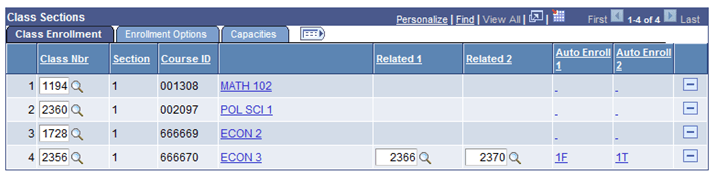

Here is an example of the Class Sections grid:
APT (Academic Progress Tracker) Enrollment Class Sections grid
Results are ordered by CLASS_SECTION. The process returns the lowest CLASS_SECTION value when multiple sections of a class exist. The process also evaluates the CLASS_COMPONENT parts of the selected section for required related components and returns any related sections (related 1 and 2). Here again the lowest section number is used for each related component.
Class Enrollment tab:
Class Nbr
Displays the CLASS_NBR value for the lowest CLASS_SECTION value with a CLASS_TYPE of E. You can select a different value if other sections are available.
Class Description
Click the Class Description link (SUBJECT and CATALOG_NBR) to access the Class Detail page and view enrollment capacity and totals.
Related 1 and Related 2
Displays the CLASS_NBR value for the lowest CLASS_SECTION value for related components (a maximum of two, neither of which is auto-enroll). You can select different values if they are available.
Auto Enroll 1 and Auto Enroll 2
Click the links to access the Class Detail page and view enrollment capacity and totals.

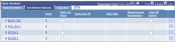

Enrollment Options tab:
This example illustrates the fields and controls on the APT Enrollment Class Sections grid – Enrollment Options tab.
APT (Academic Progress Tracker) Enrollment Class page Sections grid: Enrollment Options tab
Units
Displays the unit value for the class. The value is editable for variable unit/credit classes.
Wait List OK
When this check box is selected, the enrollment engine attempts to wait list students in this class if the class is closed at the time when enrollment is processed. When the class(es) are processed by the enrollment engine, the User ID that creates the Run Control is checked for access to the Wait List OK function. If the User ID does not have this access, the wait list option is ignored and a closed class error is returned.
Instructor ID
You can edit this field if the class allows a choice of instructor.
Start Date
You can edit this field if the class is scheduled in the OEE session.
Take RD Option
You can edit this field if the Requirement Designation is optional.

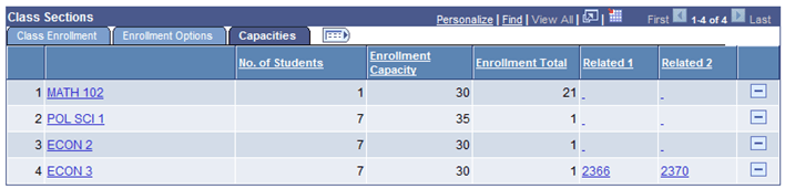

Capacities tab:
This example illustrates the fields and controls on the APT Enrollment Class Sections grid – Capacities tab.
APT (Academic Progress Tracker) Enrollment page Class Sections grid: Capacities tab
No. of Students
Displays the total number of students in the selected population that need to be enrolled in the section of this course.
Enrollment Capacity
Displays the enrollment capacity of the selected enrollment section.
Enrollment Total
Displays the current enrollment total for the selected enrollment section.

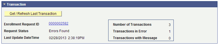

View APT Enrollment transaction data in the Transaction group box:
This example illustrates the fields and controls on the APT Enrollment Transaction group box. You can find definitions for the fields and controls later on this page.
APT (Academic Progress Tracker) Enrollment Transaction group box
Get / Refresh Last Transaction
Click to retrieve the last enrollment request generated for this Run Control/User ID (can be used when the same Run Control is used for multiple runs).
Enrollment Request ID
Displays the last enrollment request generated for this Run Control/User ID. An enrollment request is generated only when the Process Mode is Enroll.
Request Status
Displays the status of the Enrollment Request (ENRL_REQ_HEADER.ENRL_REQ_PROC_ST).
Last Update Date Time
Displays the time stamp value for the enrollment request (ENRL_REQ_HEADER.DTTM_STAMP_SEC).
Number of Transactions
Displays the number of Enrollment Request detail rows (the number of Student/Class number combinations within the request).
Transactions in Error
Displays the number of Enrollment Request detail rows that resulted in error (ENRL_REQ_DETAIL.ENRL_REQ_DETL_STAT = E).
Transactions with Message
Displays the number of Enrollment Request detail rows that were processed successfully but for which an informational message was returned (ENRL_REQ_DETAIL.ENRL_REQ_DETL_STAT = M): for example, a student was added to a wait list or a student was enrolled in a class but the repeat check process returned a repeat warning.

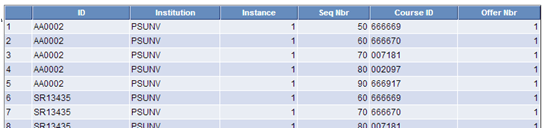

The Population Selection (or Manual Entry) populates a result table (SSR_APT_ENR_TGT) with the following values returned from the APT Item Attempt table for items where the item type is COURSE and where the APT Item Schedule (SSR_APT_SCHD) term (and session if the enrollment cohort uses session level) match the run control term value:
This example illustrates the fields and controls on the APT Enrollment Result Table. You can find definitions for the fields and controls later on this page.
APT (Academic Progress Tracker) Enrollment Result Table example
Institution and Instance
Displays the Institution and Instance values for the selected instance.
Seq Nbr
Displays the SSR_APT_ATT.SSR_APT_ITEM_SEQ value.
Offer Nbr
Displays the Course Offering value if it exists (not required).
