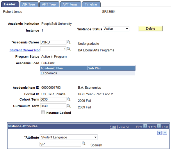

Attributes are assigned using the Instance Attributes scroll area:
Header page example: attributes
Field or Control Description
Attribute
The name of the attribute. This value comes from the description entered for the attribute on the Common Attribute component.
Value
This field changes depending on the type of attribute. This could be a numeric, date, time or text field. Alternatively, the field could prompt against a list of values if one has been defined for the attribute.
See Campus Community Fundamentals: Defining a Common Attribute
See Campus Community Fundamentals: Associating a Common Attribute to a Record
