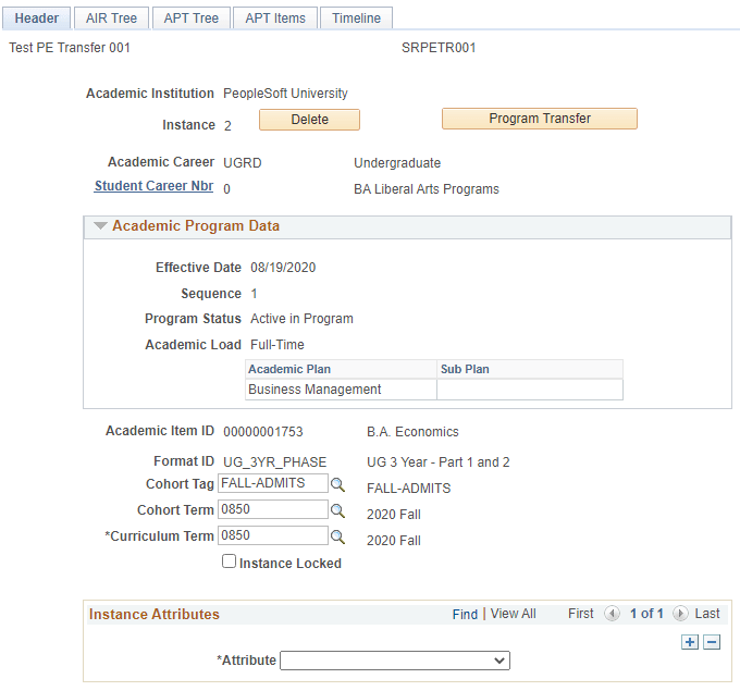

Adding an APT Instance
Access the Header page (Records and Enrollment, and then Program Enrollment, and then Academic Progress Tracker, and then Header).
This example illustrates the fields and controls on the Header page. You can find definitions for the fields and controls later on this page.
Header page
An APT Instance is created by EMPLID, INSTITUTION and SSR_APT_INSTANCE. In addition to providing a link to the student’s program stack, the Instance Header record also captures key high level data about the student’s program of study.
Field or Control Description
Delete
You can delete an instance if no Instance Number exists on the Student Program page and no result rows exist for which the Include in Calculation check box is selected on APT Items page and the Result Status is Undetermined.
See Linking an APT Instance to the Student Program
See Managing APT Items
Program Transfer
This button appears if a student has multiple APT instances, and it’s enabled when the APT instance is active.
Click to access the APT Transfer page. See Managing APT Program Transfer.
Academic Career
Select an academic career. A student must have an active STDNT_CAREER row for the selected career.
Student Career Nbr
Select a student career number. The field prompts against all active student program stacks for the selected academic career. Click the related link to access the Program Plan component for the selected career number.
Effective Date and Sequence
Displays effective date and sequence of the current row for the student's program/plan stack.
Program Status
Displays the status of the program associated with the selected career number.
Academic Load
Displays the approved academic load for the program.
Academic Plan/Sub Plan
Display only.
Academic Item ID
Select an academic item ID. The prompt lists all valid academic items with an academic item type of Program (SSR_AIR_HDR.SSR_ITEM_TYPE = ‘PRG’). This is a delivered academic item type value.
Format ID
Displays the program format ID attached to PRG Academic Item. This value is used to assign an enrollment cohort to a student (see Cohort Term).

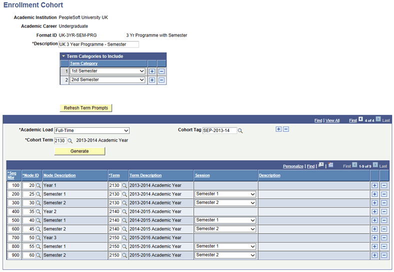

Cohort Tag
This value is obtained in the application process and indicates the point within a term (typically a session) that the applicant is expected to enroll. If present, this value is used to assign an enrollment cohort to a student (see Cohort Term).
Cohort Term
The admit term of the student (ACAD_PROG.ADMIT_TERM) appears by default but can be changed. This value is used to assign an enrollment cohort to a student. The system uses the institution, career, program format ID, approved academic load, cohort term and cohort tag (if it exists - it is not required) to point to an enrollment cohort definition for the student. If a student does not have a Cohort Tag, the system looks for matches in the Enrollment Cohort Table where the Cohort Tag value is null.
See Setting Up Enrollment Cohorts
Curriculum Term
The value of the requirement term for the selected career number appears by default. You can change the value.
Instance Locked
Select this check box to lock the entire APT instance, preventing any updates.
Note: This feature is planned for the future.
Instance Attributes
The scroll area allows you to assign attributes and values to an APT instance. Associate instance attributes for use with APT Instances on the Common Attributes – Record Context page.
See Campus Community Fundamentals: Associating a Common Attribute to a Record
Generate
Click this button to launch the process that fetches all academic items that are attached to the PRG academic item ID. The following documentation explains the generate process.
Generating Academic Items
As mentioned previously, the process of adding an APT instance involves two steps. The first is the creation of a header record using the fields described above. The second step is the generation of the academic items or program requirements for a selected program item. This could be a single item (for the program itself) if the program item is a shell for a customized student specific program, or it could be an extensive list of requirements that are nested under the program item in a series of layers or levels. The item generation process does the following:
  1. Evaluates the TERM_TBL to find the start date of the student’s Requirement Term (SSR_APT_HDR.REQ_TERM).
  2. Using that date, it retrieves the maximum active effective dated row for the PRG item (from SSR_AIR_HDR) where the effective date is less than or equal to the Curriculum Term start date.
  3. Retrieves all Academic Item rows for the PRG item and its children, all child items of the PRG’s children and so on.
The list of items returned (on the AIR Tree page) represents a view of all the items that are tied to the PRG academic item in the header. These are the items that can be added from AIR to the student’s APT instance.

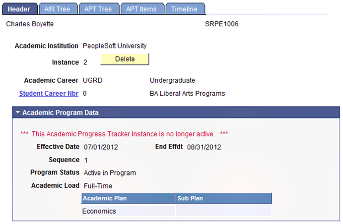

Managing APT Instance Statuses
An APT Instance is essentially an extension of the student’s program/plan stack, and the status of the instance (active or inactive) is conferred by the most current effective dated row on the program stack.
When an APT instance is inactivated, the instance is marked as inactive and an end effective date is displayed as in the following example:
Header page example of inactive instance
An APT instance can be rendered inactive when one of the following events occurs on the program/plan stack:
  • An effective dated row is added which inactivates the program stack (for example, the program row is discontinued or suspended).
  • A change occurs in the program stack data (such as a program or plan change) which initiates the creation of a new APT instance as of a certain date.
    For example, Student A has instance 1, which is active as of 07/01/2012. Student A changes Plan with an effective date of 08/01/2013. This plan change maps to a new AIR program which leads to the creation of a new instance for the student, instance 2. In this case, the APT Header data would look like this:
    Instance Effective Date End Effective Date
    1
    07/01/2012
    07/31/2013
    2
    08/01/2013

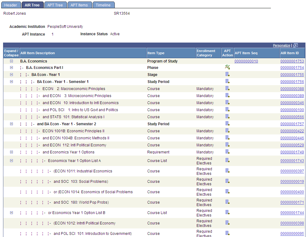

Using the AIR Tree

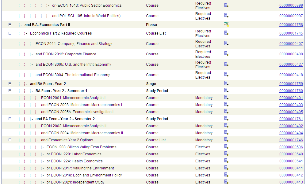

The AIR Tree provides a view of a student’s program requirements as they are defined in the Academic Item Registry. When you click Generate on the Header page, all of the academic items attached to the student’s academic program item (that is, the value in the Academic Item ID field on the Header page) are rendered in a view that represents both program structure and content.
See Setting Up Academic Item Registry Entries, Item Details, and Item Security
Access the AIR Tree page (Records and Enrollment, and then Program Enrollment, and then Academic Progress Tracker, and then AIR Tree).
This example illustrates the fields and controls on the AIR Tree page (1 of 2). You can find definitions for the fields and controls later on this page.
AIR (Academic Item Registry) Tree page (1 of 2)
This example illustrates the fields and controls on the AIR Tree page (2 of 2). You can find definitions for the fields and controls later on this page.
AIR (Academic Item Registry) Tree page (2 of 2)

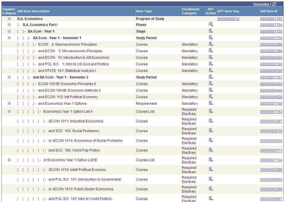

Using the Create Planning Node Function
The Create Planning Node function simulates the APT Request action of Create Plan Node(s) by inserting all of the academic items for the first or subsequent sections of a student’s program of study by adding academic item(s) identified as Planning Nodes (in the Program Format definition).
See Setting Up Program Formats
The placement of the planning node (and selected child items) will open that particular section of the program–for example a stage, year or semester–for planning and enrollment.
The Create Planning Node function adds:
  • The selected item (that is, the item identified as a Planning Node and where the icon appears).
  • All ancestors in the lineage that are not already in APT.
  • AND
  • All non-COURSE immediate child items (for example a ‘stage’ or ‘study period').
  • Any descendent items that have an enrollment category for which SSR_ENRL_CAT.SSR_AUTOMOVE_APT = 'Y'.
In the following example, each phase is a Planning Node. The Enrollment Category of Mandatory is defined as one for which items should be automatically moved to a student’s APT:
AIR (Academic Item Registry) Tree page example 1
When Phase 1 is created, the following items will be added to APT:
AIR Item Description Item Type AIR Item ID
BA Economics
Program of Study
00000001753
Part 1 – BA Economics Program
(Program Phase)
00000001754
Year 1 B.A Economics
Stage
00000001755
Year 1 – Semester 1
Study Period
Plus all Mandatory items, in this case all courses
00000001756
Year 1– Semester 2
Study Period
Plus all Mandatory items: all three mandatory courses plus the mandatory Economics Year 1 Options item (but not its children, which do not have the Automatically move to APT check box selected on the Enrollment Category page, because the student needs to choose.)
00000001757
See Setting Up Enrollment Categories for Program Requirements

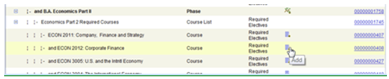

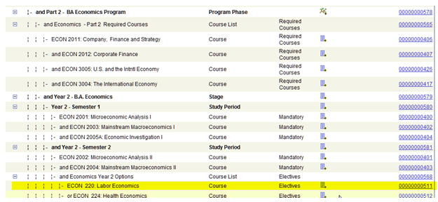

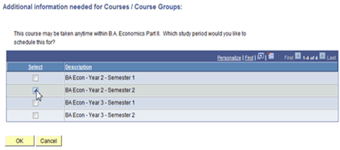

Using the Add Function
You can also add academic items to an APT instance on an individual basis using the Add function. For example the Add button can be used to add courses when you must select one or more courses from a list. When items are added to a student’s APT in this way however, the relationship of that item to other items in the AIR tree must be recorded in order to maintain the structure of the program at an individual student level. Because it is possible to add an item without also adding its parent, the ancestors of an item are also added if they have not themselves been added to the APT instance.
In most cases the Add function adds the selected item to APT as well as all ancestors in the lineage, up through the PRG root, that do not already exist in APT. The exception is course items that are not associated with an item that equates to Term.
See Assigning Term Values to Courses
This example illustrates the AIR Tree as explained below.
AIR (Academic Item Registry) Tree example 2
In the example above, if you added course ECON 220 (highlighted in the example page) and no other items had been added to the APT for Part 2 B.A. Economics, the following items would also be added:
  • ECON 220 (00000000511– selected item)
  • Economics Year 2 Options (Course List: 00000000568 – parent of selected item)
  • Year 2 - Semester 2 (Study Period: 00000000581 – parent of Course List)
  • Year 2- B.A. Economics (Stage: 00000000579 – parent of Study Period)
  • Part 2 - BA Economics Program (Phase: 00000000578– parent of Stage)

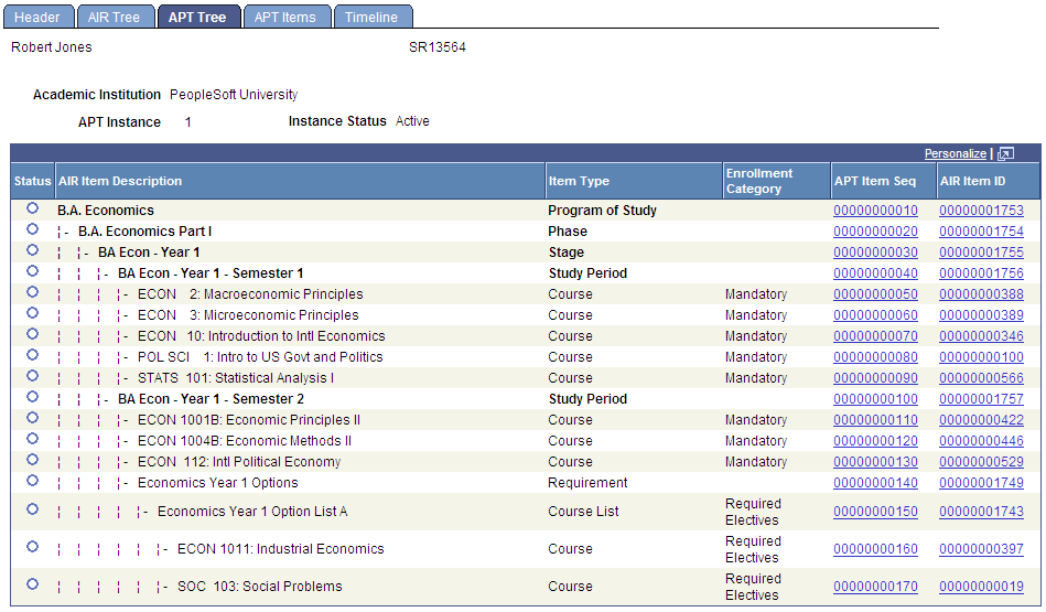

Using the APT Tree
The APT Tree provides a view of all of the academic items within a particular APT instance, the status of those items (completed or not completed) and the relationships between those items. Although APT data is sourced from data that is defined in a tree-like structure (AIR) it is possible that these relationships can be changed after the items are placed in an APT instance. A course could be moved from one stage to another, for example, such that the parent item is changed from STAGE 1 to STAGE 2. The individual student program tree structure presented in this way is used to calculate results at various levels in the program. Note. This feature is planned for the future.
Access the APT Tree page (Records and Enrollment, and then Program Enrollment, and then Academic Progress Tracker, and then APT Tree).
This example illustrates the fields and controls on the APT Tree page. You can find definitions for the fields and controls later on this page.
APT (Academic Progress Tracker) Tree page
Status
Indicates whether an item is Completed or Not Completed. This value will ultimately be set based on the APT item status (planned for the future). For now, the status can be set manually at the APT item level.
Completed icon
Indicates the status of the item is Completed.
Not Completed icon
Indicates the status of the item is Not Completed.
For information about the Enrollment Category, APT Item Seq, and AIR Item ID columns, refer to the previous documentation about these fields for the AIR Tree page.

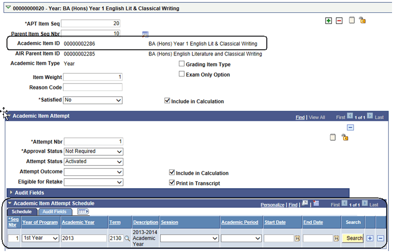

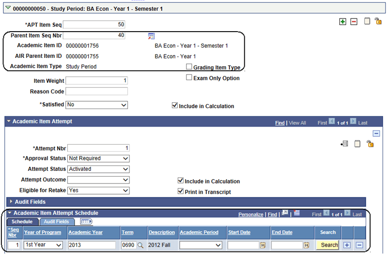

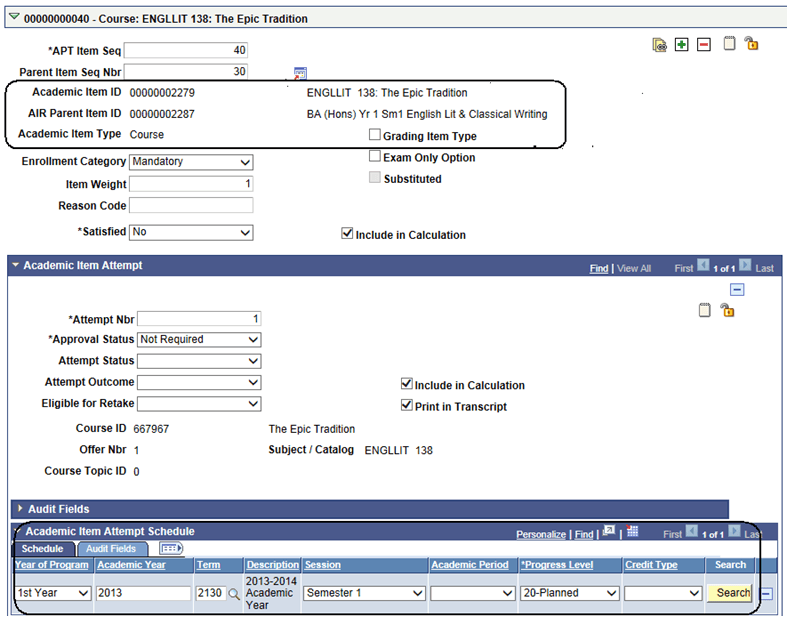

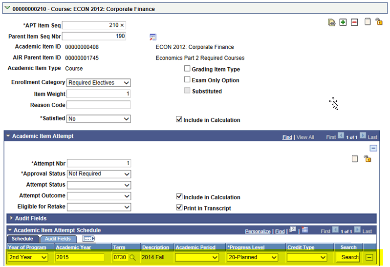

Managing APT Items

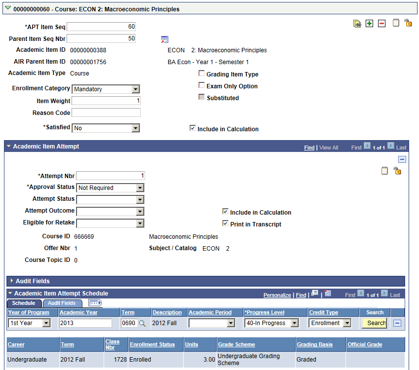

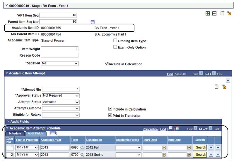

The APT Items page provides a view of all items in an APT instance and their related detail. The three levels of data for an APT item are:

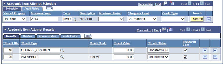

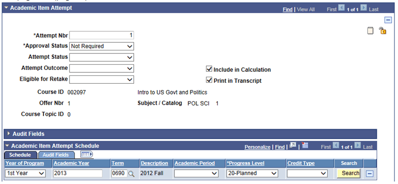

  1. The APT Item Sequence level (SSR_APT_ITEM) which holds high level data such as the item sequence, weight, and status.

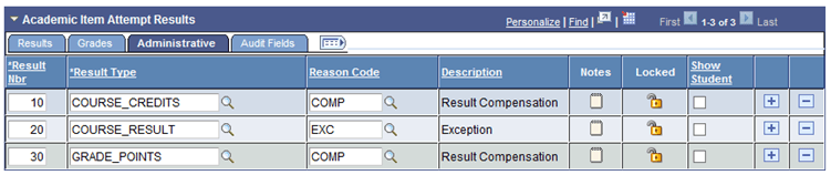

  2. The Academic Item Attempt level: An academic item can have multiple attempts attached to it. An item such as COURSE can be repeated without altering the structure of the program. For example, a first year course can be repeated during the second year, but the outcome/credits apply to the first year requirements. Data such as academic year and term are also tracked at this level.
  3. The Academic Item Attempt Results level: Each attempt can have multiple results associated with it. There can be multiple Result Types and the structure also accommodates multiple instances of the same result type. This structure allows you to define your own result profile – where the institution determines what type of data is used to track results. It also allows for different versions of results – for example, preliminary, board approved.
As you can see in the following page example, an Academic Item Attempt can have Attempt Schedule data (sibling) and can have multiple Results rows. The same structure is available for all academic items - the course item shown in the example page has the same basic APT structure as the Study Period item shown above it on the example page.
Access the APT Items page (Records and Enrollment, and then Program Enrollment, and then Academic Progress Tracker, and then APT Items).
This example illustrates the fields and controls on the APT Items page (1 of 3). You can find definitions for the fields and controls later on this page.
APT (Academic Progress Tracker) Items page (1 of 3)
This example illustrates the fields and controls on the APT Items page (2 of 3). You can find definitions for the fields and controls later on this page.
APT (Academic Progress Tracker) Items page (2 of 3)
This example illustrates the fields and controls on the APT Items page (3 of 3). You can find definitions for the fields and controls later on this page.
APT (Academic Progress Tracker) Items page (3 of 3)

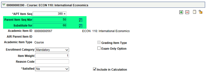

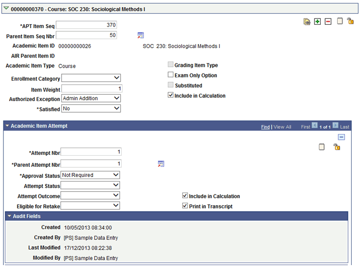

APT Items Page: APT Item Sequence Level

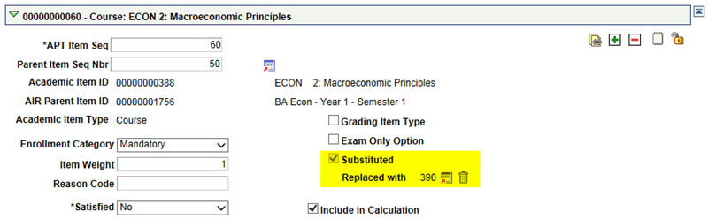

Process Substitution iconProcess Substitution
See: Substituting APT Items
Add (for APT (Academic Progress Tracker) Items) icon Add
See: Adding Child Items
Delete (for APT (Academic Progress Tracker) Items) icon Delete
Item Delete is available for all APT items, however delete is prevented on save if the item being deleted has child items.
Add Notes icon Add Notes
Click to access a secondary page Item Notes where you can add notes and comments.
Lock icon Lock
Click to lock the item and all of its child items. A locked item cannot be updated: all fields at the item, attempt and result level are display only.
Unlock icon Unlock
Click to unlock the item and child items that are locked.
APT Item Seq
The APT Item Sequence is assigned as items are added to an APT Instance. You can change the value to reorder items when required.
Parent Item Seq Nbr
This value is the APT Item Seq value of the parent item. You can change this value if you need to move an item to a different area of a student’s program (for example, from one stage to another).
Go icon Go
Use the Go icon to quickly navigate to the parent academic item.
Academic Item ID and Academic Item Type
Displays the Academic Item ID and Academic Item Type of the item copied from the AIR program structure to the student’s APT.
Grading Item Type
Display only. This check box is selected when the APT row was created to represent a (child) grading item from AIR.
Item Weight
If an item has a weighting value (in the context of its parent), it is moved to this field when the item is saved to APT. You can change this value, to override the contribution of a particular item to a higher level calculated result.
Authorized Exception
This field displays only when an item that has been added to the instance does not exist in the Academic Item Registry as an item for the student’s program. There is currently only one value: Admin Addition.
Satisfied
Select Yes, No, or Waived.
A value of Yes indicates that the requirements for an item have been satisfied and that the item (in combination with the Include in Calculation check box) can be used towards program completion/results calculation.
Exam Only Option
Select this check box to indicate that an item (and all child items) will be satisfied by exam only – that is, no course enrollment is required.
When this check box is cleared, all attempts/results for this item are ignored for result calculation purposes by the Rules Engine and system calculated results. Note: This feature is planned for the future.

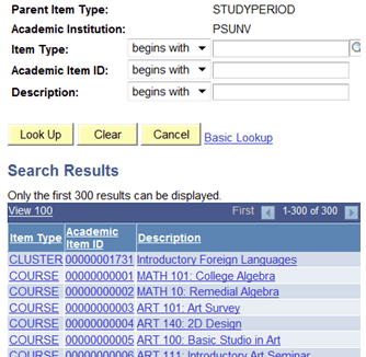

When you add an item, you are presented with a list of values that is compiled as follows:
  • If the current item is a Program Format Tree Node, the prompt lists all academic items that have an academic type specified as a valid child item in the Academic Item Type Matrix.
    See Identifying Child Item Types and Syncing Entities
  • The prompt also excludes those items that have an item type defined as a Program Format Tree Node. This ensures that any changes to the program structure conform to the Program Format for the item.
  • All available COURSE items (unless the item is being added as a child of a COURSE – except where the current item is a Course Group, in which case a secondary page will list the courses that match the Course Group parameters).

APT Items Page: Substituting APT Items
The APT Item structure supports the need to substitute prescribed program content (academic items) with courses or other types of academic items. The substitution process typically involves the swapping of one course for another, but it is also possible to substitute different types of academic items, as well as the replacement of one item with many items. It is also possible to replace an item of one type with one (or more) of a different type.
Not all academic items can be substituted: the Process Substitution button is hidden when an item has an academic type identified as a program format tree node, or if the item itself has been replaced with another APT item. The button is also hidden for any item that has child items in APT. For example, a Course List item, from which child item courses have been placed in APT cannot be substituted.
The Process Substitution button invokes a look up against Academic Item Registry for the institution attached to the student’s APT instance.
Process Substitution example
The prompt lists all non-program format tree node academic items (with effective dated logic) that are valid child items (according to item type matrix) of the parent item of the item which is being substituted.
After an item has been selected, the Substitution function performs the following actions:
Substituted Item
  • Selects the Substituted check box for the item.
  • Creates a pointer on the substituted item to the Replaced with items.
This example further illustrates process substitution:
Process Substitution Example 2
The Replaced with item is inserted into the APT Instance:
  • Sets the parent value of the item to that of the substituted item.
  • Ties the new item to the substituted item by recording that APT Item Sequence number of the substituted item.
  • Note: The Process Substitution button is not available for the replacement item(s).
Process Substitution Example 3
Reversing an APT Item Substitution
To reverse a substitution:
  • On the substituted item: Delete the Replaced with value(s) using the Replaced with delete button.
  • Delete the replacement item using the Item Delete button.
APT Items Page: Academic Item Attempt Level
An APT item can have multiple attempts. For example, if a student needs to retake a Year 1 course during Year 2, you could add a new attempt row under the Year 1 item, rather than moving that item from year to year. Each attempt has attributes attached to it.
This example illustrates the fields and controls on the APT Items page (Academic Item Attempt level). You can find definitions for the fields and controls later on this page.
APT (Academic Progress Tracker) Items page: Academic Item Attempt level
Create New Attempt icon Create New Attempt
This button is available if the attempt Eligible for Retake check box is selected (see information about this check box later in this section). When you click this button, a new attempt row is created for this item. The system also creates new attempts for any unlocked child item attempts for which the Eligible for Retake check box is selected. This is optional.
Transfers to a secondary page Item Attempt Notes where you can add notes and comments.
Lock icon
Locks the attempt. A locked item attempt cannot be updated: all fields at the attempt and result level are display only.
Unlock icon
Unlocks the item attempt.
Attempt Nbr
A system assigned value. Multiple attempts can exist for an APT item.
Approval Status
This field is used when approval is required for enrollment planning - that is, when an advisor must approve the course entries in the student’s APT for a particular stage/study period before the student enrolls. The approval requirement is based on the Requires Approval check box on the Academic Item Registry page.
Attempt Status
This field indicates that enrollment/credit requirements for an item attempt have been completed (20: Completed) and when the attempt can be counted towards satisfying the item itself and for result calculation (60: Finalized).
Attempt Outcome
This field will indicate whether the item attempt was successfully completed.
Print in Transcript
This value can be used to determine if an item attempt is included in user defined transcript or report.
Eligible for Retake
If the value in this field is Yes, the item can be retaken. This field is used to determine whether a new attempt is created.
Refer to the “Managing Retake Processing” documentation section later in this topic.
When multiple attempts exist, select this check box to indicate which attempt should be used to determine the status/result for an academic item. The check box is selected by default.
Course ID, OfferNbr, and Course Topic ID
These values display for Course academic items
Academic Item Attempt Schedule grid:
For information about Personalized Timeline,
See Using the APT Timeline
Seq Nbr
A system assigned number. An academic item attempt can have more than one schedule sequence. This could happen if a student completes an item over a number of terms. A typical example might be where a program is organized into Year 1, Year 2 and so on and where a part time student could take more than the prescribed 2 semesters to complete the requirements.
Year of Program
This field is populated when:
  • APT row has an Academic Item Type which is equated to Year of Program (in the program format definition for the program).
  • APT row has an Academic Item Type which is equated to Term (in the program format definition for the program).
  • APT row has an Academic Item Type of COURSE.
Academic Year
  • The student’s APT header has an Enrollment Cohort value which been mapped to term values (this is not required) or a Personalized Timeline has been established and
  • APT row has an Academic Item Type which is equated to Term (in the Program Format definition for the program).
Term
Session
  • The student’s APT header has an Enrollment Cohort value which been mapped to term and session values (this is not required) or a Personalized Timeline has been established and
  • APT row has an Academic Item Type which is equated to Term (in the Program Format definition for the Program).
See: Assigning Year of Program, Academic Year and Term (STRM) Values to Academic Items added to APT later in this section.
Academic Period
This field is for future use.
Start Date and End Date
The start and end dates for the academic item. These fields are intended primarily for non-course based academic items that might not necessarily be scheduled in term/session–an internship for example. These dates can be used to provide a time frame for an item that is not tied to a formal academic teaching period.
For course items, the Start Date and End Date fields are replaced with the other fields as in the following example page.
This example illustrates the fields and controls on the APT Items Page (Course item example). You can find definitions for the fields and controls later on this page.
APT (Academic Progress Tracker) Items Page: Course item example
Progress Level
Indicates the status of the COURSE being applied to this item/attempt.
When a course item is added to APT, this value is set to Planned. After a student is enrolled in a class section of the course, the value is set to In Progress. If the student subsequently drops the class section and it is deleted from STDNT_ENRL or retained in 'Dropped' status, the Progress Level value is set to Dropped. The level is set to Completed after a grade is present in STDNT_ENRL (the grade must earn credit).
See Managing APT Enrollment
See the Student Enrollment Event document in My Oracle Support (ID 1400723.1).
Credit Type
Indicates whether the course is being completed or was completed through class enrollment or from transfer credit.
Search
Launches a process to find a match for the COURSE item in STDNT_ENRL or Transfer Credit Model (including Test and Other Credit).
Career
Displays the student’s career for the matching STDNT_ENRL row (as opposed to the course career).
Values appear in the remaining fields based on the matching STDNT_ENRL row.
Here is an example in which the Credit Type is Transfer Credit:
This example illustrates the fields and controls on the APT Items page (Credit Type example). You can find definitions for the fields and controls later on this page.
APT (Academic Progress Tracker) Items page: Credit Type example
Values in the fields such as Career, Transfer Model Nbr and so on appear based on the matching Transfer Credit row.

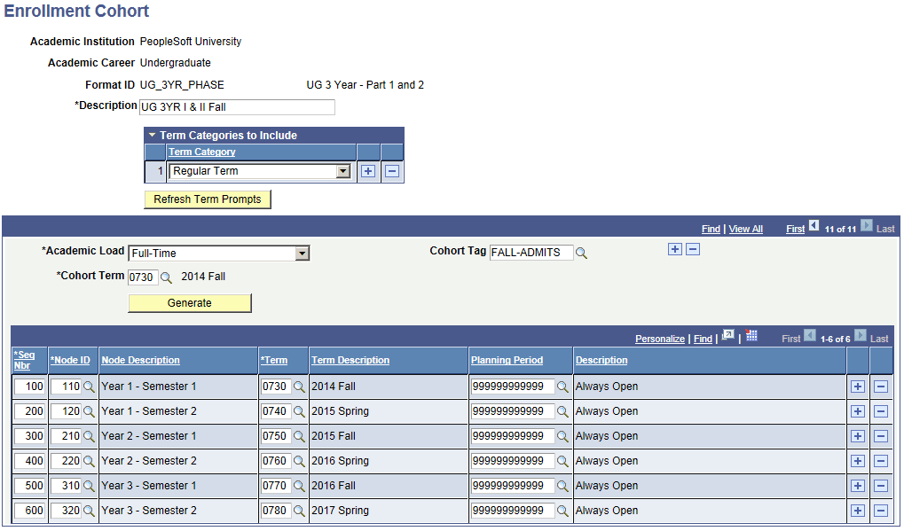

APT Items Page: Assigning Year of Program, Academic Year and Term (STRM) Values to Academic Items added to APT
Although the APT data is not defined by term, you still need to track data by academic year/term as well as by the Year of Program (YOP) attribute. Using a combination of the Program Format definition attached to the PRG item and (if one exists) the Enrollment Cohort term and definition for the student, data is recorded as items are added to the APT so that you can query the data by academic year, term, or a student’s year of program.
Here is an example of Program Format/Enrollment Cohort data:
Program Format data:
Program Format / Enrollment Cohort example 1
Program Format / Enrollment Cohort example 2
The Program Format nodes which are equated to Year of Program and Term determine which academic items will be used to record year of program, academic year, and term data in APT.
A session level can also be defined for use in term configurations where a term (STRM) value represents an academic year and a session (SESSION_CODE) is used to represent ‘term’ (for example, semester 1, semester 2). See: Academic Year and Term Data with Session Level section below.
Equates to Year of Program Items: Year of Program Data:
Equates to Year of Program example:
APT (Academic Progress Tracker) Items page: Equates to Year of Program example
  • A year of program value is assigned as the academic items equated to Year of Program (in the Program Format definition) are added to the APT.
    Academic Year, Term and Session (if applicable) values are also assigned. In this case the term value is assigned based on the term values that are assigned to the child equates to term item (BA Econ Year 1 - Semester 1 - see below).
  • The example above shows Year 1 – B.A. Economics. When Year 2 is added (as a result of seeding or a course being added to APT) this will be assigned to 2nd Year and so on.

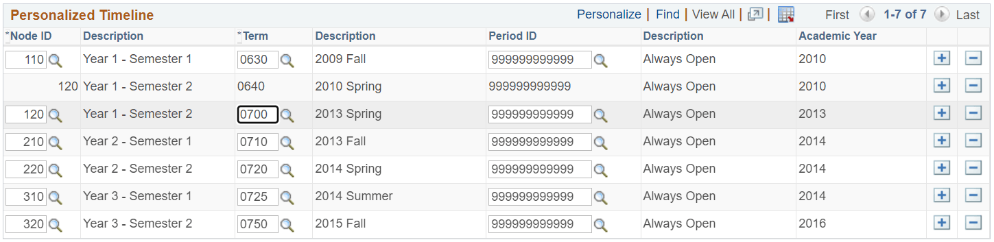

Equates to Term (EQT) Items: Year of Program, Academic Year and Term Data:
This data is recorded for the following:
  • Academic Item(s) equated to Term (in the program format definition for the program).
  • All COURSE academic items.
A year of program, academic year (derived from the term) and term are recorded for each of these.
Equates to Term example:
APT (Academic Progress Tracker) Items page: Equates to Term example
Year of Program
If the item is also equated to year of program, this value is taken from the Program Format definition; otherwise the value is determined using the program definition value for a parent, grandparent and so on. In this example, the YOP value from the parent STAGE item is used to determine the value for the STUDYPERIOD.
Academic Year
The TERM_TBL.ACAD_YEAR value for the term value (STRM) returned from the Enrollment Cohort or Personalized Timeline (see Term).
Term
Uses the Node ID associated with the Academic Item Type in the Program Format definition, to fetch the term value from the student’s Enrollment Cohort or Personalized Timeline (if one exists). In this example, the STUDYPERIOD academic item has been identified as equating to term. A look-up is performed on the Enrollment Cohort using the Node IDs defined in the Program Format (this should be consistent if programs are defined using Build Program by Format).
Session
If the Program Format includes session level and the Enrollment Cohort or Personalized Timeline has Equates to Term nodes mapped to combinations of Term and Session, a session value will also be assigned.
Academic Year and Term Data with Session Level:
Year of Program and Equates to Term (and Session) levels can be tracked separately if the program format is defined this way. The following example shows an enrollment cohort based on a program format that has distinct equates to term (YEAR) and session (SEMESTER) items and how this data is recorded in APT:
Program Format example:
Program Format and Enrollment Cohort using Session Level example 1
Enrollment Cohort example:
Program Format and Enrollment Cohort using Session Level example 2
With this configuration, the Year of Program and Equates to Term values are tracked at different levels because term can now be tracked down to the session level:
Equates to Term item:
Equates to Term Item
Equates to Session Level item:
Equates to Session Level Item

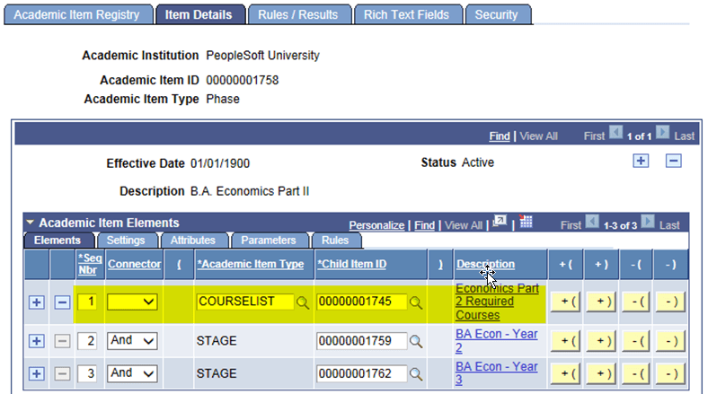

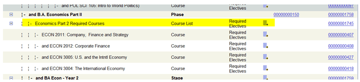

APT Items Page: Assigning Term Values to Courses
This section discusses choosing a “term” for a COURSE item that is not associated (according to lineage) with an academic item equating to term.
An AIR COURSE, COURSELIST, COURSEGROUP or any user defined grouping of courses can be placed at any level in a program structure. A COURSELIST could be situated in the structure in such a way that while a student is required to complete them, they may do so at any point in the program. The program used in this example has a basic structure like this:
AIR (Academic Item Registry) Program Structure example
Any COURSE items that are associated with STUDYPERIOD items can be assigned a term using the Enrollment Cohort or Personalized Timeline (if one exists). However, you cannot know the term in which a COURSE associated with items above that level (PRG, PHASE, STAGE) is to be taken until the student actually plans/enrolls. In the example program used in this document, “Part 2” is comprised of two stages (Year 2 and 3) but there is a list of courses that the student must complete at some point during those two years.
This example illustrates the Item Details page (assigning term values to courses).
Item Details page: example for assigning term values to courses
This will be represented in APT as follows:
APT (Academic Progress Tracker) example: assign term values to courses
The Course List is a direct child of Part 2 and is not associated with a Stage (which equates to Year of Program) or Study Period (which equates to Term).
When a student (or advisor/administrator) selects a course that is placed in a program structure in this way, it ultimately must be assigned to a term for planning and enrollment purposes. To do this, the system must:
  • Evaluate the children of the item where the course is situated.
  • Determine which of those child items equates to term (this is determined by Program Format, where an Equates to Term value is required).
  • Return a list of those items and prompt the user to assign one to the course.
In the example above, the courses are tied to the Phase level of the program structure. The immediate children of the PHASE item (other than the COURSELIST itself) are STAGE items, which equate to YOP. So in this particular case the system must go down another level. The STAGE items each have two child STUDYPERIOD items, which equate to term. All four of these must be available to the user, because this is the level at which enrollment will take place:
  • User adds a course to APT:
    This example illustrates adding a course to APT (step 1).
    APT (Academic Progress Tracker) example: add course step 1
  • Child items equating to term are retrieved
    The choices can be presented with user defined (message catalog text)
    This example illustrates adding a course to APT (step 2).
    APT (Academic Progress Tracker) example: add course step 2
  • The item is saved to APT. The lineage (as defined in AIR) is preserved, in this example BA Econ = Year 2 – Semester 2.
    For Year of Program/Term reporting purposes however, the course selection is associated with 2nd Year, Term 0730.
    This example illustrates adding a course to APT (step 3).
    APT (Academic Progress Tracker) example: add course step 3
The Eligible for Retake field determines whether an academic item can be repeated at a future point in a student’s program of study.
If the Item is a Program Format tree planning node: the APT Request process can be used to build a new attempt for that planning node as well as any child program format tree nodes and other child items (such as courses) that are eligible for retake. If a student needs to re-take an entire program node, such as a year or semester, we recommend the following steps:
  • Set the Eligible for Retake field to Yes on the Planning Node and any child Equates to Term/Session nodes (if applicable). Also identify all child items (courses, course lists etc.) that must be retaken.
  • Create a Personalized Timeline and adjust the term mapping as required. For example, if a student attempted Year 1 in term 2014 Academic year (term code 2014) and is required to re-take Year 1 during the next academic year, the personalized timeline would need to be adjusted such that Year 1 is now mapped to the term code for 2015 Academic Year, with any subsequent years adjusted accordingly.
  • Use the APT Request process to create a new attempt against the Year 1 planning node. This creates new attempts for all eligible academic items and assigns those items to the appropriate term/session.
    See Creating and Managing APT Instances Using the APT Request Process
A course retake can be handled in one of two ways, depending on whether or not the retake needs to occur at a specific point in the remainder of the student’s program of study:
  • Retake at a specific point: if a student needs to retake the item at a set point in time, for instance retaking Year 1 course during Year 2:
    • Set the Eligible for Retake field to Yes on the original attempt.
    • Use the Create New Attempt button to create a new attempt against the course in APT.
    • Enter Academic Item Attempt schedule data for the new attempt.
    • Create and activate the next planning node (Year 2 , to use the same example) using APT Request.
    In student self-service, this makes the course available as an item to be retaken in the specified term/session node on the My Education Plan component once the term/session node for the original attempt has been finalized.
  • Student is allowed to retake at any point during the remainder of the program:
    This option allows the student to select the course on the My Education Plan in any subsequent (active) term node once the term/session node for the original attempt has been finalized. When the course is selected, a new attempt is created for the course, with the schedule data for the term node where it was selected. If the student decides not to take the course at that point, the attempt and associated schedule data are removed from APT when the course is de-selected and the My Education Plan component is saved.

APT Items Page: Academic Item Attempt Results Level
The APT structure is not delivered with a predefined set of fields for statistics and results (total units, grade points and so on). You must define the types of statistics and results that you want to track for your students, using the Result Type component. The number and type of results associated with a particular academic item (for example, a course, semester) are determined by the academic item definition (in AIR), where you indicate which results will be tracked for a particular academic item.
See Setting Up Result Types
This level of the structure allows you to track multiple versions of the same result type. For example, a Year of Program might have a Result Type of Weighted Average Mark associated with it. An institution might need to record the calculated version of this result (that is, the result calculated by a rules engine or uploaded from an external source) and the finalized version (which could be different from the calculated version) delivered from an exam or other review board. In this case, the Results grid would have two rows for the result type Weighted Average Mark. Obviously only one of the results would be used for calculating higher level results and for transcript purposes, but both results would be recorded.
Select the Results tab:
This example illustrates the fields and controls on the APT Items page: Results tab. You can find definitions for the fields and controls later on this page.
APT (Academic Progress Tracker) Items page: Results tab
An academic item attempt can have multiple result types associated with it.

Select the Administrative tab:
This example illustrates the fields and controls on the APT Items page: Administrative tab. You can find definitions for the fields and controls later on this page.
APT (Academic Progress Tracker) Items page: Administrative tab
Reason Code
You can enter a reason code for a result row. For example, a student may be granted a higher result and compensation due to ill-health or other mitigating circumstances or a result may be excluded due to plagiarism.
See Setting Up APT Reason Codes
Show Student
This field can be used when defining the logic of the XMLP Results Template, which is user-defined. The logic within this template could use this field to determine whether the result should be displayed for the student.

When an item is added to an APT instance, Academic Item Attempt Result rows are created for all result types linked to that academic item in AIR.
Access the Timeline page (Records and Enrollment, and then Program Enrollment, and then Academic Progress Tracker, and then Timeline).
This example illustrates the fields and controls on the Timeline page. You can find definitions for the fields and controls later on this page.
Timeline page
View a student’s enrollment cohort data and override that data if necessary.
Create Personalized Timeline
If you click this button, the enrollment cohort is copied down to the APT level and you can change term/session data. After it is created, the personalized timeline is used to assign YOP, Term and Session in APT.
Here's an example of a personalized timeline:
Timeline page: personalized timeline example
If there are multiple rows with same node ID in Academic Progress Tracker (APT) Timeline (in Enrollment Cohort Timeline or Personalized Timeline), then the APT component and APT Request process retrieve the term from the maximum sequence number. The maximum sequence number row term will be the term in the corresponding APT schedule of an APT item when the item is created.
