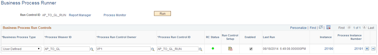

This example illustrates the fields and controls on the Business Process Runner page. You can find definitions for the fields and controls later on this page.

Field or Control Description
Run Control, Report Manager, Process Monitor, and Run
These are common fields that exist on other Process Scheduler run control pages. When you click the Run button, you can schedule and run the Application Engine process, BPW_PRCRUN, which then starts the business processes that you have specified.
Business Process Type, Business Process ID, and Business Process Run Control ID
Specify the business process run controls to be executed. They are set on the Business Process Run Control page and are all required fields.
RC Status
Indicates whether the selected Business Process Run Control ID exists
Run Control Setup
Opens the Business Process Run Control page as a modal component. It is available if the Business Process Type, Business Process ID, and Business Process Run Control ID fields are populated. If the selected Business Process Run Control already exists, it will be opened. If not, a new one with the selected run control ID will be created.
Note: The new run control is not saved automatically; you must make changes and save.
Enabled
Select to enable a particular business process run control.
Last Run, Instance
If the business processes have been executed previously, these fields indicate the date/time stamp and the Process Instance. The Instance link takes you to the Process Monitor (as modal component).
Business Process Instance Number
The instance number of the business process instance of the previous execution. It is a link that takes users to the Business Process Instance (as modal component).
