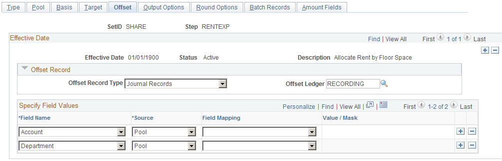

This example illustrates the fields and controls on the Define Allocation Step - Offset page. You can find definitions for the fields and controls later on this page.

Offset Record Type
Select Journal Records or Any Table. For journals, specify theOffset Ledger name. The system uses this definition to determine the journal line record name and other characteristics (such as calendar, multibook, and base currency). If the value in the Offset Record Type field is a table, specify the record name in theTable edit box that becomes available.
Note: If the allocation step does not require an offset, leave this field blank.
Specify Field Values
Specify the offset field values. The offset fields can be directed to the pool record or a particular target table, but the purpose of the offset is always to prevent double counting.
