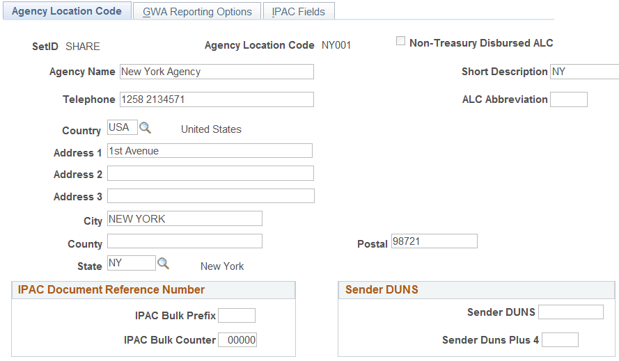

Agency Location Code Page
Use the Agency Location Code page (AGENCY_LOC_CD ) to define agency location codes by SetID for federal payment schedules and reporting purposes and provides for ALC name, location, address, and telephone information.

This example illustrates the fields and controls on the Agency Location Code page.
Field or Control Description
Enter an 8-digit numeric value for the ALC.
Non-Treasury Disbursed ALC
Click if the ALC does not use the US Treasury to carry out payments or if the ALC is authorized to create its own payments outside the U.S. Treasury.
Note: If you set this option incorrectly for an ALC and save it, the incorrect ALC and option remains because you cannot delete the rows online. You must define a new ALC with the appropriate option.
IPAC Document Reference Number
IPAC (Intra-governmental Payment and Collection system) is designed to transfer funds between government agencies and provide the capability to include descriptive information related to each transaction. This descriptive information assists with monthly reconciliation.
IPAC Bulk Prefix
Enter a 3-digit alphanumeric prefix to be used by PeopleSoft in creating unique document reference numbers (to differentiate from the Department of Treasury document reference numbers) for those Agency Location Codes that are used to send payments and collections.
IPAC Bulk Counter
Enter the beginning number from which to increment the sequential counter for the document reference number.
See PeopleSoft Payables: Processing Outbound IPAC Transactions.
See PeopleSoft Receivables: (USF) Submitting Transactions Between Agencies Using the IPAC System.
Sender DUNS
Sender DUNS and Sender DUNS Plus 4
Enter a Sender DUNS and optionally a Sender DUNS Plus 4 value for the Sender Agency Location Code (ALC). These fields may be required as defined on the IPAC Fields page. (The Receiver DUNS and DUNS Plus 4 values are stored on the Customers - Additional General Information page).
If the Sender DUNS and Sender DUNS Plus 4 are defined as required on the IPAC Fields page, the system uses these values as the Sender information defaults on the Receivable IPAC Transactions page.
Note: The Sender and Receiver DUNS and DUNS Plus 4 fields will only appear as defaults on the IPAC transactions if they are marked as required on the IPAC Fields Page. This applies to items created online and from an external interface (therefore derived from the AR Posting program).

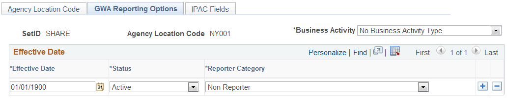

Agency Location Code - GWA Reporting Options Page
Use the GWA Reporting Options page (AGENCY_LOC_CD2) to assign a Business Activity and one or more effective dated Reporter Categories to an Agency Location Code.
When an agency system is ready to pass the BETC code to the U.S. Treasury, the agency will select the appropriate Reporter Category.

This example illustrates the fields and controls on the GWA Reporting Options page.

Business Activity
Select the business activity type for this agency location code. Values are:
  • AP Payments Only
  • AP Payments and AR
  • AR Only
  • IPAC Only (Intra-Governmental Payment and Collection only)
  • IPAC and AP Payments
  • IPAC and AR
  • IPAC, AR, and AP Payments
  • No Business Activity Type
The GWA Business Activity that you specify for each ALC drives the following functionality related to the Partial SF 224 and CTA reports:
  • Identifies the type of cash activity that is applicable for the ALC for reporting to the U.S. Treasury.
  • Limits the data extracted for the Partial SF224 and CTA reports based on the specific Business Activity code defined for the ALC.
  • Drives the Business Exception Activity report so actual data that is not applicable for a particular ALC is presented on the exception report to be identified and corrected by the Agency.
Reporter Category
Select a GWA reporter category code for this agency location code. The reporter category can be equivalent to the business activity type, a subset of the business activity type, or a nonreporter. For example, if you select the IPAC and AP Payments business activity type, the valid selections are IPAC Only, AP Payments Only, IPAC and AP Payments, or Non Reporter.
If either the Sender or Receiver ALC has one of the following four IPAC Reporter Category values, then that ALC agency is a GWA reporter for IPAC:
  • AP Payments Only
  • AR Only
  • IPAC and AR
  • Non Reporter
The GWA Reporter Category code is specified to identify those interfaces, such as IPAC, CA$HLINK and SPS/PAM, that have been modified to interface the Business Event Type Code (BETC) to cash activity with the U.S. Treasury.
The GWA Reporter code that you define for each ALC drives functionality in the software related to the Partial SF 224 that:
  • Identifies which agency systems and ALC are ready to interface the BETC with its cash activity to the US Treasury.
  • Limits the data extracted for the Partial 224 based on the specific GWA Reporter Category code defined for the ALC.
  • Determines whether cash reclassification from one Treasury Symbol to another needs to be reported on the Partial 224
The GWA Reporter category has no impact on CTA reporting.
Business Activity and Reporter Category Combinations
The system requires that the business activity type and reporter category codes are a valid combination. The system displays a warning message if the combination is invalid.

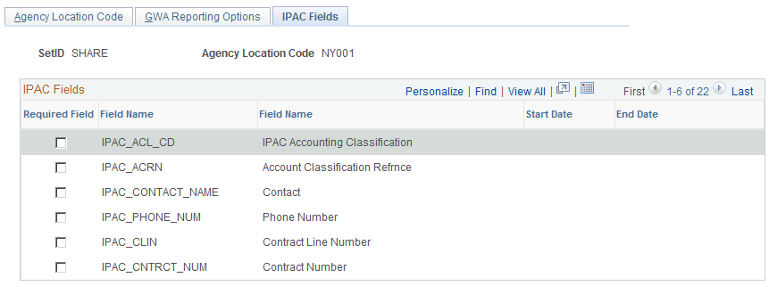

IPAC Fields Page
Use the IPAC Fields page (ALC_IPAC_FLDS) to assign a Business Activity and one or more effective dated Reporter Categories to an Agency Location Code.
When an agency system is ready to pass the BETC code to the U.S. Treasury, the agency will select the appropriate Reporter Category so that the data can be excluded from the SF224 report.
Navigation:
Set Up Financials/Supply Chain, and then Common Definitions, and then Agency Location Codes, and then Agency Location, and then IPAC Fields
This example illustrates the fields and controls on the IPAC Fields page. You can find definitions for the fields and controls later on this page.
IPAC Fields page
Required Field and Field Name
Select the Required Field check box to define the selected field as required for this ALC. The IPAC fields available here are delivered as optional; fields that are by default required in PeopleSoft Financials are excluded.
Start Date and End Date
For each Required Field that you select, you must also enter Start Date and End Date values. Effective dating enables an agency to designate fields as optional or required in the future, based on the agency’s business case needs. If you deselect a Required Field check box, the system clears the start and end dates.
