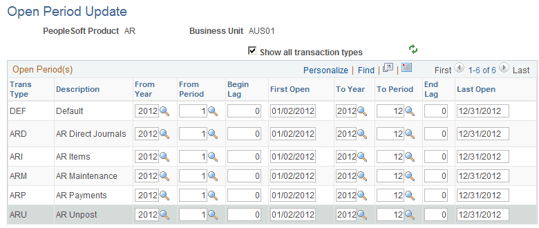

This example illustrates the fields and controls on the Open Period Update page for PeopleSoft Receivables. You can find definitions for the fields and controls later on this page.

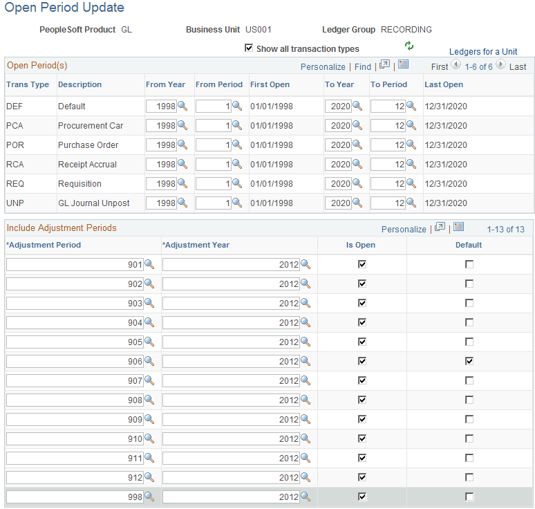

This example illustrates the fields and controls on the Open Period Update page. You can find definitions for the fields and controls later on this page.
You can post journal entries only to the open periods that you specify on the Open Period Update page.

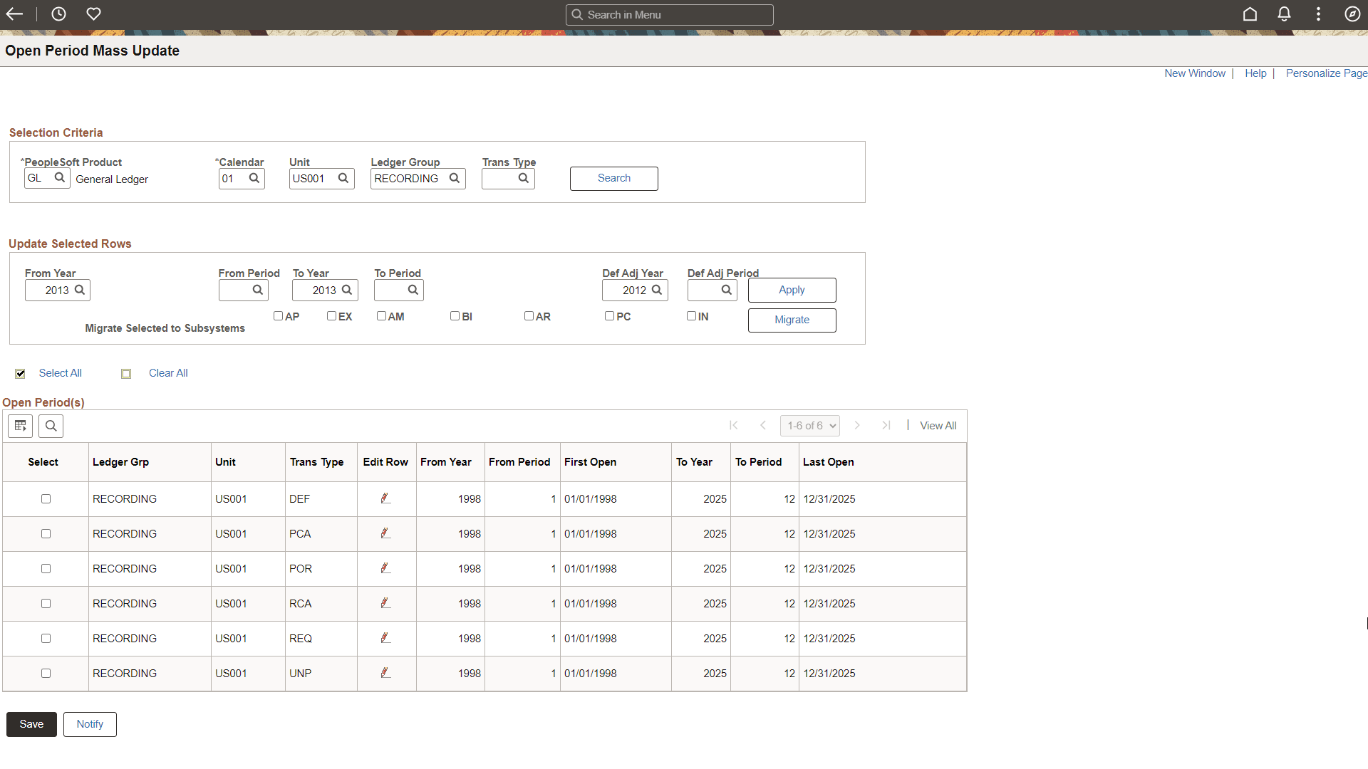

This example illustrates the fields and controls on the Open Period Mass Update page for General Ledger.

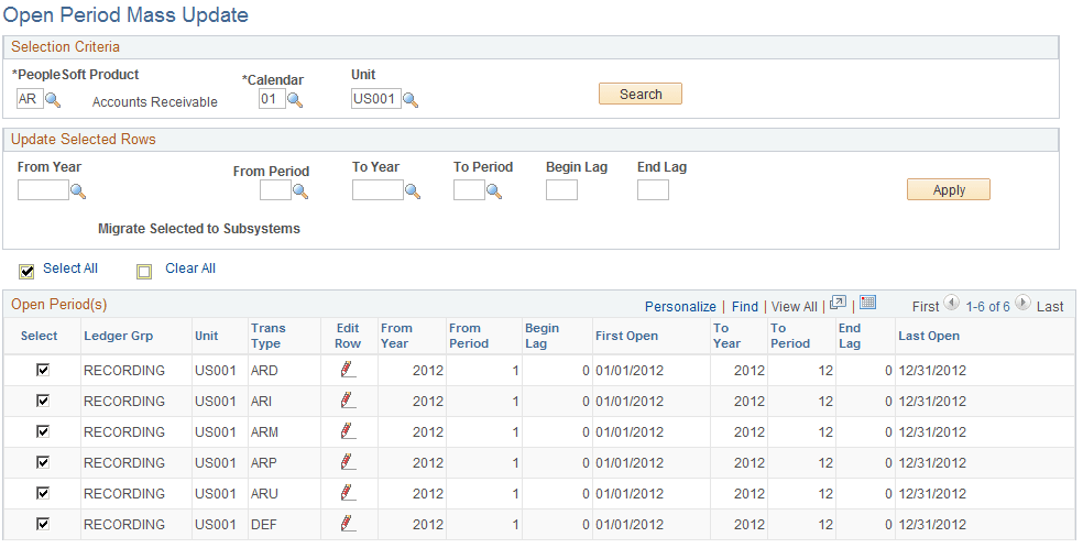

This example illustrates the fields and controls on the Open Periods Mass Update page for Receivables. .
Performing a Mass Update
To perform a mass update:
  1. Enter the selection criteria for General Ledger on the Open Periods page.
    Use a wildcard (%) to select all business units and all ledger groups, or select a specific business unit and enter a wildcard for all ledger groups, or enter a wildcard for all business units and a specific ledger group. Click the Search button. A list of open periods appears based on your selection criteria.
  2. Click the Select All button to select every open period on the list for mass update.
    Click the Clear Allbutton to reverse this action and select rows individually.
  3. Enter the open period changes in the Update Selected Rows group box, and click the Apply button.
    The system applies the changes to each selected business unit and ledger group.

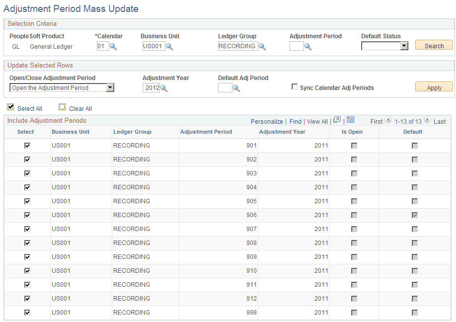

Adjustment Period Mass Update Page
Use the Adjustment Period Mass Update page (OPEN_ADJ_MASS_UPD) to make mass changes to adjustment periods for general ledger business units and ledger groups.
Navigation:
Set Up Financials/Supply Chain, and then Business Unit Related, and then General Ledger, and then Open Periods, and then Mass Update Adjustment Periods
This example illustrates the fields and controls on the Adjustment Period Mass Update page. You can find definitions for the fields and controls later on this page.
Selection Criteria
The page is applicable only to General Ledger. You must select a calendar code for the Calendar field. All other criteria fields are optional and serve to narrow the range of adjustment periods returned in the adjustment periods section at the bottom of the page after you select the Search button.
In this section you can choose to:
  • Open or close an adjustment period or periods.
  • Change the adjustment year for an adjustment period or periods.
  • Change the default adjustment period to another period.
  • Synchronize the adjustment periods for the selected business unit and ledger group with the adjustment periods from an updated detail calendar.
    While you can add and remove adjustment periods using the Detail Calendar component (DETAIL_CALENDAR), this type of change is not automatically reflected, or synchronized with the GL business unit and ledger group adjustment periods. You can synchronize this type of change by selecting the Sync Calendar Adj Periods check box, and then selecting the check box for each Business Unit and Ledger Group to be change. If you added an adjustment period to the detail calendar, it is added to the business unit and ledger group you selected. If you deleted an adjustment period from the detail calendar it is removed from the business unit and ledger group.
After selecting the Select check boxes for the rows you want to change, click the Apply button to update the selected rows.
