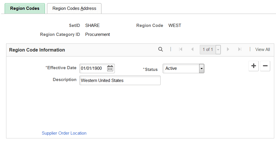

This example illustrates the fields and controls on the Region Codes page.
Region Codes page
Regions can be physical entities or geographical areas. When a region represents a physical entity, the region code has the same characteristics as a business, that is, address and language.
When you create a new region code, the system prompts you for a region category ID. The Region Category ID determines which fields display on the Region Codes page. PeopleSoft provides the following Region Category ID values:

Use the Procurement value for regular procurement regions. If you want to set up alternative region types for the region codes, use the Region Types page.
For Manufacturer and Distributor contract types, use the Contract Domain Region Category ID. You may consider this option when creating separate regions for multiple applications like PeopleSoft Purchasing and PeopleSoft Services Procurement.
Field or Control Description
Description
Enter a unique description for the region code.
Supplier Order Location
Click this link to access the Procurement Region Supplier Order Location, where you can select an appropriate supplier SetID, supplier ID, and supplier location for a specific region.
This link appears when you select Procurement for Region Category ID.

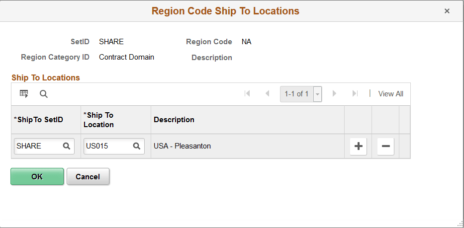

Ship To Location
Click this link to access the Region Code Ship To Locations page, where you can identify multiple Ship To locations within a designated contract domain.
This information helps control access and pricing on contracts by business unit, contract domain, and ShipTo.
This link appears when you select Contract Domain Region Category ID.

Region Code Ship To Locations Page
Use the Region Code Ship To Locations page (REGION_SHIPTO) to identify multiple Ship To locations within a designated contract domain.
Navigation:
Click the Ship to Location link on the Region Codes page.
This example illustrates the fields and controls on the Region Code Ship To Locations page.
Add a line for each Ship To location you wish to include with the contract domain. Include the Ship To SetID and Ship To Location for each line.
