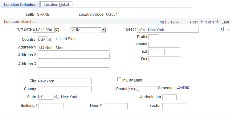

Location - Definition Page
Use the Location Definition page (LOCATION_TBL) to define a location code, such as a branch office or shipping office.
Navigation:
Set Up Financials/Supply Chain, and then Common Definitions, and then Location, and then Setting Up Locations, and then Location Definition
This example illustrates the fields and controls on the Location Definition page. You can find definitions for the fields and controls later on this page.
Enter a description and populate the fields for the telephone and address information.
The address fields that appear are defined on the Address Format page.
Field or Control Description
In City Limit
Select if you use a third-party tax provider product and if you need to access additional city tax information.
Note: The In City Limit is not used by the Vertex O Series tax solution.
Alternate Character Set
Click to access a page where you can enter or display (or both) field values in an alternate character set. This button appears only if you selected the Alternate Character check box on the User Preferences - Overall Preferences page.
Address 2 and Address 3
If not used at this location, you can enter values in these fields to provide more information about the location, such as Printing Division or Western Annex.
Address 4
The space available to display addresses on a page is limited. The Address 4 field will not appear if you select some of the optional address fields on the Address Format page, such as Number 1 or House Type.
GeoCode
This value is used by third-party tax applications to link a location definition to their tax calculation algorithms. If no geocode has been selected, this field displays a Lookup link. Clicking the geocode value or Lookup link accesses the Tax GeoCode Selection page, where you select a geocode value for the location definition.
You must select a geocode for each location definition in order to integrate properly with your third-party tax application.
Error messages that appear for this field are issued by the third-party application, and more information is provided in the third-party application documentation.

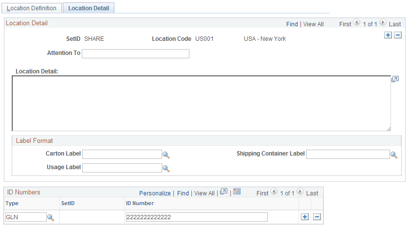

Use the Location Detail page (LOCATION_TBL2) to add details to a location definition.
Navigation:
Set Up Financials/Supply Chain, and then Common Definitions, and then Location, and then Setting Up Locations, and then Location Detail
This example illustrates the fields and controls on the Location Detail page. You can find definitions for the fields and controls later on this page.
Attention To
Enter the name that appears in the attention area of correspondence for this location.
Location Detail
Enter additional information that you want to maintain for this location.
Carton Label
Select the default format for printing carton labels for this location.
Shipping Container Label
Select the default format for printing shipping container labels for this location.
Usage Label
Select the default format for printing item usage labels for this location.
ID Numbers
Use this section to specify any additional types of identifiers for the location. The system supports a list of number types, such as GLN (a 13-digit numeric value) or DUNS number. Except for GLNs, other ID numbers entered here are not validated at save.
The SetID field is not available for edit for all ID types. For each location specified in the system, you can only enter one ID number for any given type.

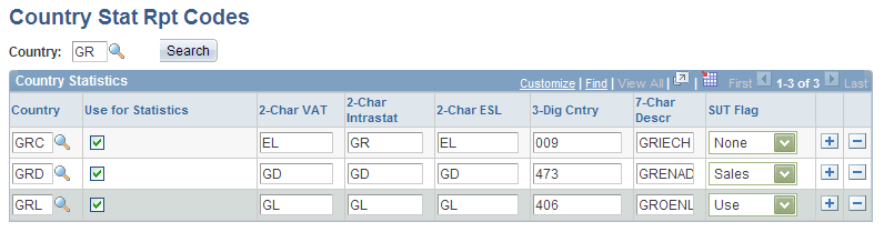

Country Stat Rpt Codes Page
Use the Country Stat Rpt Codes (country statistics report codes) page (COUNTRY_STAT_PNL) to enter country codes requiring reporting as well as reporting options for each country code that you specify.
Navigation:
Set Up Financials/Supply Chain, and then Common Definitions, and then Location, and then Country Statistics, and then Country Stat Rpt Codes
This example illustrates the fields and controls on the Country Stat Rpt Codes. You can find definitions for the fields and controls later on this page.
Use for Statistics
If you select this check box, the country recognized by the International Standards Organization (ISO) is also recognized by the European statistical offices as a country. If Use for Statistics is not selected, the country is recognized by the ISO but not by the European statistical offices. If this is the case, the European statistical offices assume that the country is a part of another country for the purposes of producing statistical data such as the GNP. For example, for ISO, the Principality of Monaco has its own country code, while for statistical purposes, Monaco is assumed to be part of France, and therefore has the same statistical country code as France.
2-Char VAT (two character value added tax)
Enter a 2-character country code to meet special value added tax (VAT) requirements for certain countries. This is useful for some countries that are not using the ISO 3166 country code in conjunction with their VAT registration ID. When appending the 2-character country code to the VAT registration ID, Financials accesses this separate country code. The VAT registration ID is a 20-character number to meet VAT requirements.
2-Char Intrastat (two character intrastat)
Displays the country identifier for the European statistical offices. This code is printed on some of the Intrastat Layout forms.
2-Char ESL (two-character European Sales List)
Used for countries that are members of the European Union. This code is usually printed as part of the VAT Registration Information on the European Sales List (ESL).
3-Dig Cntry (three-digit country)
Used as a country identifier for the European statistical offices, the code is usually printed on the Intrastat report to identify source or destination countries to or from which goods are shipped.
7-Char Descr (seven-character description)
Used for the German international EFT layout to identify countries into or from which electronic funds are sent or received.
SUT Flag (sales and use tax flag)
Informational only.
