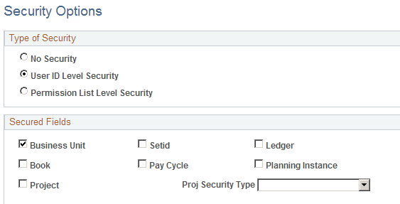

This example illustrates the fields and controls on the Security Options page. You can find definitions for the fields and controls later on this page.
Type of Security
Field or Control Description
No Security
Select to disable PeopleSoft application security. All users authorized to access a page can select any SetID, business unit, or ledger.
User ID Level Security
Select to enable security by user ID. Users are limited to accessing application pages or prompt values associated with the SetIDs, business units, projects, and ledgers specified by their user IDs.
Permission List Level Security
Select to enable security by permission list. Users are limited to key fields specified by the primary permission list to which you assign their user IDs. This means that all users assigned to a particular permission list have the same level of security.
The selection must be either user ID or permission list and the selection is across all products.
Secured Fields
Business Unit
Select to implement security on the Business Unit field. This is the primary key for all transaction data.
Setid
Select to implement security on the Setid field. This is the primary key for all accounting structure and rules tables.
Ledger
Select to implement security on the Ledger field. This is the key for all ledger balances.
Book
Select to implement security on the Book field. This code is specific to a business unit. This field refers to Book as used in Asset Management.
Pay Cycle
Select to implement security on the Pay Cycle field. Pay cycles can be daily, weekly, monthly, or at other intervals.
Planning Instance
Select to implement security on the Planning Instance field.
Project
Select to implement security on the Project field. This is the primary key for all PeopleSoft Projects Costing data.
Proj Security Type Project Security Type
Determines how a project will be selected when defining security for a user and permission list. Select Use list to select from a list of projects. Select Use tree to select from a tree detailing projects.
