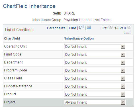

ChartField Inheritance Page
Use the ChartField Inheritance page (CF_INHERIT) to maintain the Inheritance Options for an Inheritance Group.
Navigation:
Set Up Financials/Supply Chain, and then Common Definitions, and then Design ChartFields, and then ChartField Inheritance, and then Define CF Inheritance Options
This example illustrates the fields and controls on the ChartField Inheritance page. You can find definitions for the fields and controls later on this page.

ChartField
The page is pre-populated with the fully and partially configurable ChartFields other than Account, Alternate Account and the Affiliates.
Account and Alternate Account are not available for inheritance and Affiliate values are automatically supplied by the system.
Inheritance Option
The following ChartField Inheritance options apply to all Inheritance Groups:
  • Do Not Inherit– When this option is selected, you can specify a value for the ChartField on the product specific Accounting Entry Template or you can leave the value blank. This option would usually not be selected for a balanced ChartField, unless you select the Intra Unit Balancing Entries check box on the Detail Ledger Group - Balancing page.
  • Use Unit Default– When this option is selected, the ChartField value is the default value that you enter in the Inheritance Defaults for the business unit on the General Ledger Definition − Inter/IntraUnit page. With this option, you do not enter a value for this ChartField on a product specific Accounting Entry Template.
  • Inherit within Unit– If this option is selected, the ChartField value is inherited from one of the other entries on the transaction, but only if the other entry is in the same business unit. Otherwise, the business unit Default is used. You may want to select this option if the ChartField values are not shared across all business nits. With this option you do not enter a value for this ChartField on the product specific Accounting Entry Template page.
  • Always Inherit– If you select this option, the ChartField value is always inherited from one of the other entries that make up the transaction, regardless of whether it is in the same business unit. This option should only be selected if all business units share the same ChartField values; otherwise, the inherited value might be invalid. With this option, you do not enter a value for the ChartField on the product specific Accounting Entry Template or setup page.
Some Inheritance Groups have edits that restrict which inheritance options are valid for each ChartField, often based on whether or not the ChartField is balanced. Refer to the next section for details.
Refer to the documentation for ChartField Inheritance for each product for variations in functionality or information specific to that product.
