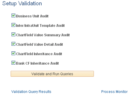

Inter/Intraunit - Setup Validation Page
Use the Setup Validation page (IU_AUDIT) to run the application engine audit program and specify desired queries to review audit data.
Navigation:
Set Up Financials/Supply Chain, and then Common Definitions, and then Inter/Intra Unit, and then Validate Inter IntraUnit Setup
This example illustrates the fields and controls on the Setup Validation page. You can find definitions for the fields and controls later on this page.
To preclude the same errors being reported multiple times in subsequent audits, you might begin by running the audits one at a time, in the following order and correct any errors prior to running the next audit:
  1. Business Unit Audit—Identify business units that require an InterUnit or IntraUnit Template but do not have them defined. It also lists business unit pairs that are not defined when the interunit balancing method is pairs.
  2. Inter/IntraUnit Template Audit—Identify missing InterUnit and IntraUnit Templates, Transaction Codes, Account Balance Groups and Entry Types.
  3. ChartField Value Summary Audit—Identify missing SetID/ChartField values. Each SetID/ChartField value is listed only once.
  4. ChartField Value Detail Audit—Identify missing SetID/ChartField values for a combination of Transaction Code, Account Balance Group and Entry Type for the GL BU (general ledger business unit) pair or Inter/IntraUnit Template indicated.
  5. ChartField Inheritance Audit—Identify missing ChartField Inheritance Groups and, if also missing, their corresponding SQL Definitions based on installed products.
  6. Bank ChartField Inheritance Audit—Identify missing external bank account ChartField inheritance SQL Definitions.

Validate and Run Queries
Click this button to initiate the application engine process (IU_AUDIT) to create audit results and run the queries you select.
Validation Query Results
Select to view the results of the queries in Excel worksheets.
Process Monitor
Select to view the progress of the application engine process (IU_AUDIT).
