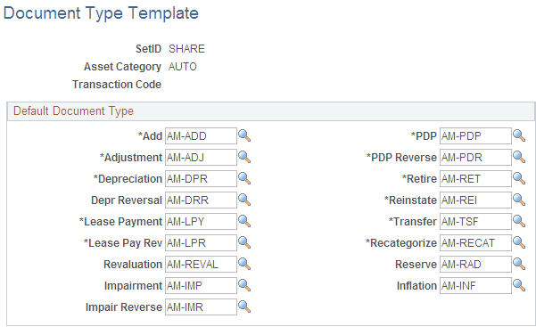

Document Type Template Page
Use the Document Type Template page (AM_DOCTYPE_TMPL) to assign document types to each accounting entry type in Asset Management.
Navigation:
Set Up Financials/Supply Chain, and then Product Related, and then Asset Management, and then Accounting, and then AM Document Type Template, and then Document Type Template
This example illustrates the fields and controls on the Document Type Template page. You can find definitions for the fields and controls later on this page.
Assign document types to be used by default by document sequencing for asset categories and asset transaction codes.
If you are using revaluation, you need to define a template for the revaluation transaction code.
