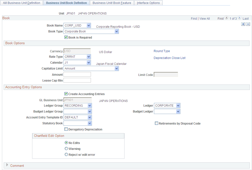

Business Unit/Book Definition Page
Use the Business Unit/Book Definition page (BU_BOOK_DEFN_01) to if the Create Accounting Entries check box is selected, the ChartField Edit Options group box appears.
Select to receive a warning message, to reject the transaction or to perform no ChartField combination edits for the business unit and book.
Navigation:
Set Up Financials/Supply Chain, and then Business Unit Related, and then Asset Management, and then Asset Management Definition, and then Business Unit/Book Definition
This example illustrates the fields and controls on the Business Unit/Book Definition Page. You can find definitions for the fields and controls later on this page.
See Business Unit/Book Definition Page.
WARNING:
Changes to the original ChartField combination editing rules may result in invalid ChartField combinations for subsequent Asset Management processes, such as depreciation. Some transactions such as retirements cannot be done at all (if the Combination Edit option is set to Reject) if you invalidated previously accepted combinations. A similar situation occurs when you deactivate a ChartField that is assigned to an asset. In this case, you would have to reactivate the ChartField and include those combinations again, or set the Combination Edit Option to Warning or No Edits.

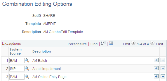

Combination Editing Options Page
Use the Combination Editing Options page (AM_CEDT_SSRC) to select the system source or sources of the processes for which you want to enable ChartField combination editing.
Navigation:
Set Up Financials/Supply Chain, and then Product Related, and then Asset Management, and then Financials, and then AM Combination Editing Options
This example illustrates the fields and controls on the Combination Editing Options Page. You can find definitions for the fields and controls later on this page.
Field or Control Description
Template
The combination editing process uses the record template for structural information to perform ChartField combination edits. The record templates have a unique name that is applicable to a particular PeopleSoft application.
Exceptions
System Source
Enter the trusted sources that do not need ChartField combination validation. Select the system source code as it appears in the interface tables.
