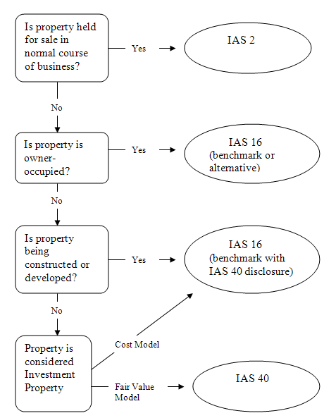

The following diagram summarizes the classification process and treatment of investment property for International Accounting Standards (IAS):
Classification process and treatment of investment property for International Accounting Standards (IAS):
Summarization of Investment Property Classification and Treatment
