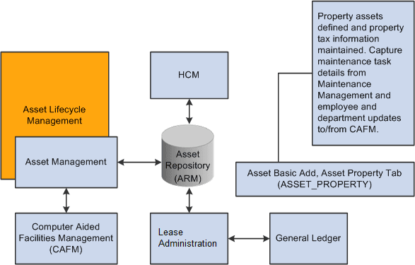

Understanding How to Integrate with Lease Administration
Asset Management integrates with Lease Administration by managing the defined property assets associated with Lease Administration in the Asset Repository and by providing the integration with third-party CAFM software suppliers to manage employee/department to property assets information.
Lease Administration utilizes Asset Management centralized Asset Repository Manager as the source of all operational and financial property asset information. The repository provides property tax tracking against each site or building stored. Using existing functionality in Asset Management, including express capitalization from Project Costing, enables companies to perform project management and then capitalize or expense the costs related to their properties accordingly.
Asset Management provides third-party CAFM integration through the centralized asset repository. The financial asset from the repository is used along with employee and department information from PeopleSoft Human Capital Management (HCM) as the source to the CAFM solution for space management. The property floor and space information and the employee space assignments performed in the CAFM solution are then updated automatically and sent back to the repository to provide a single source of information about accurate measurements of spaces within properties and timely assignments of employees in spaces. This information can then be passed to General Ledger for facility cost allocations based on square feet or meters per department as well as for providing an up-to-date space utilization model.
When creating a lease in Lease Administration, you use the Asset Management centralized asset repository for property information. You can select the property from a list or enter the property information manually. For you to select the property from the list, properties must already exist in the repository through either manual entry or through the third-party CAFM integration. The properties are known to be valid as they are generated and stored in the repository in a controlled manner: through the capitalization processes between Project Costing and Asset Management, through the asset entry as a new acquisition, or through the third-party CAFM integration. The integration between Asset Management and the third-party CAFM provider also enables Lease Administration to use information about the property assets captured in the Asset Repository such as size of spaces, location of assets within these spaces, and employee assignments to spaces.
The following list provides a high-level overview of the actual integration steps between Asset Management and the third-party CAFM provider:
  • CAFM provides a listening connector for PeopleSoft Integration Broker that resides on the PeopleSoft web server.
  • The predefined messages and transactions are tailored to the functional analysis of the data transmissions.
  • Incoming messages to the PeopleSoft server that are from CAFM are directed to the connector by the Gateway server, which then sends the messages to PeopleSoft Target Connectors.
  • In turn, the PeopleSoft Target Connectors deliver the messages to either Component Interfaces or are embedded directly into the corresponding tables.
The following information is exchanged between the two systems:
  • Organizational information including the employee names and identification numbers, department assignments, and organizational hierarchy using the PeopleSoft department trees.
  • Asset information for properties residing in the Asset Management centralized asset repository.
    The CAFM solution then builds sites and buildings to the lower levels of floors and spaces, and updates any measurement and occupancy information.
  • Employee or department assignments to properties.
    Once assigned and returned from CAFM to Asset Management, this data is used to update the custodians of the various property assets. A department can be assigned to the custodian for a building, floor, space, and so on, but if an employee is assigned to a particular space, his or her department can override the default department set as the custodian. This information can then be used by General Ledger as the basis for cost allocations using tables residing within the asset repository.
    For more complex facility allocations factoring in common or shared space, the third-party CAFM provider reports can be imported into the general ledger as the space allocation basis.
The following diagram displays the process flow for Lease Administration integration:
Process flow for Lease Administration integration.
Asset Management and Lease Administration integration points
Exchanging Asset Data with CAFM
Asset Management shares the asset repository with Lease Administration. The asset repository integrates with a third-party computer aided facilities management (CAFM), sending space allocation information for defined property assets as well as employee and department information. In turn, the CAFM application passes updated space allocation information for existing assets as well as new "sub" assets, such as floor, space, and area, with the measurements from the CAFM application, and the employee assignments to the "sub" assets, back to the PeopleSoft application.
The asset repository supports integration with Lease Administration by enabling asset property records (ASSET_PROPERTY) to have asset components. A one-to-one relationship exists between an asset and the asset property. During asset creation, when the asset type Property is selected, the Property Information tab is enabled. Information relating to the property asset as well as property tax information is stored here.
Defining an asset as property is available only from the Asset Basic Add component.

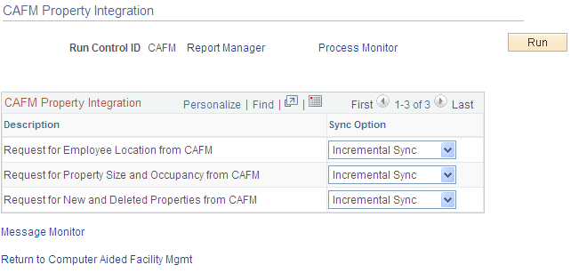

CAFM Property Integration Page
Use the CAFM Property Integration page (RE_REQ_SYNC_RUN) to .
Navigation:
Asset Management, and then Send/Receive Information, and then Computer Aided Facility Mgmt, and then CAFM Property Integration
This example illustrates the fields and controls on the CAFM Property Integration page. You can find definitions for the fields and controls later on this page.
Each process name to be run and its description is displayed.
Field or Control Description
Sync Option
Select the integration broker message type to use. The options are:
  • FullSync
    A full synchronization message exchanges all information even if it has not changed since the last time the information was requested. The exception for this rule is that when you are requesting new properties, full sync will act like an incremental sync.
  • Incremental Sync
    An incremental synchronization message exchanges only information that has changed since the last time the information was requested.
When you run the process, the requested CAFM data updates the following PeopleSoft tables:
  • ASSET
  • ASSET_CUSTODIAN
  • ASSET_LOCATION
  • ASSET_PROPERTY
  • ASSET_ACQ_DET

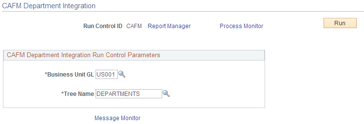

CAFM Department Integration Page
Use the CAFM Department Integration page (RE_PUB_DEPT_RUN) to exchange department information with the CAFM application using the RE_PUB_DEPT process: This application engine process is a Full Sync of Department Tree that transfers the department tree specified for the selected business unit to CAFM so that their system understands the general departmental breakdown.
With that information, the CAFM system can properly assign custodians to property assets and employees to spaces. CAFM cannot modify department data, because the FSCM tables are considered the master data.
Navigation:
Asset Management, and then Send/Receive Information, and then Computer Aided Facility Mgmt, and then CAFM Department Integration
This example illustrates the fields and controls on the CAFM Department Integration page. You can find definitions for the fields and controls later on this page.
Business Unit GL
Select the associated GL business unit from which employees are selected to exchange information.
Tree Name
Select the appropriate Department tree from which employees selected are to exchange information.
Note: If you select a tree other than Department, the process will fail.
