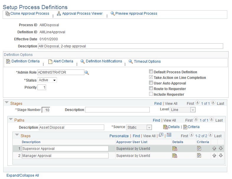

Setup Process Definitions Page
Use the Setup Process Definitions page to define the stages, paths and steps of the approval definition process.
Navigation:
Enterprise Components, and then Approvals, and then Approvals, and then Approval Process Setup, and then Setup Process Definitions
This example illustrates the fields and controls on the Setup Process Definitions Page. You can find definitions for the fields and controls later on this page.
Setup Process Definition page
Business analysts use this page to define approval definition processes. The process is made up of stages and their paths and steps. The approval steps that you place on the approval path represent the approval levels that are required for a transaction. The approval process definition provides the details of application approval rules. Asset management delivers the following demo Setup Process Definitions for AMDisposal:
  • AMLineApproval (multi-level approvals)
  • SHARE (single level approval)
Click the Details icon to access the Approval Step Definition Pageand view or modify the User List selection and other approver details.
Note: These definitions are available in the demo database. You may clone and modify them accordingly.

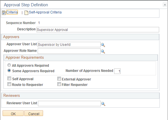

Use the Approval Step Definition page to define approval step details, such as approvers and approver requirements.
Navigation:
Click the Details icon within the Steps group box of the Setup Process Definitions page.
This example illustrates the fields and controls on the Approval Step Definition Page. You can find definitions for the fields and controls later on this page.
Approval Step Definition - Details
After adding a step (or steps) on the Setup Process Definitions page, use this page to set up additional parameters that determine how the system processes this approval step. The example pictured uses the Supervisor By Userid Approver User List and requires only one approver for the asset disposal.
