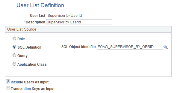

User List Definition Page
Use the User List Definition page to define user sources for use in the AF approval process (rules).
Navigation:
Enterprise Components, and then Approvals, and then Approvals, and then User List Setup, and then User List Definition
This example illustrates the fields and controls on the User List Definition page. You can find definitions for the fields and controls later on this page.
The approval user list defines user sources for use with steps in the approval processes (rules).
You can modify and use the delivered user list definitions or set up your own approver user list definition to accommodate your organizational needs.
PeopleSoft delivers the following User Lists for Asset Disposal.
Asset Disposal/User List Source
AMDisposalRequesters / SQL Definition
AMDisposalApprovers / Role
Supervisor by UserId / SQL Definition

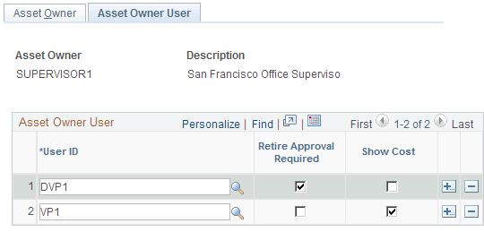

Asset Owner User Page
Use the Asset Owner User page to assign users to asset owners. This step is required when using asset disposal.
Navigation:
Set Up Financials/Supply Chain, and then Product Related, and then Asset Management, and then Financials, and then Define Asset Owners, and then Asset Owner User
This example illustrates the fields and controls on the Asset Owner User page.
The asset owner definition is required for asset disposal approval framework. When defining an asset owner user that will be used in the Approval Framework process, be sure to use an asset owner that is not considered a super user (such as MANAGER); otherwise, the disposal will be auto-approved.
See: Example of Approval Framework Setup for Asset Disposal.
