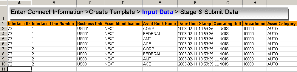

Here is a portion of the input page:
This example illustrates the fields and controls on the Example of Input Data page. You can find definitions for the fields and controls later on this page.
When the data input is complete, stage the data to the Stage & Submit tab. Data is transmitted to the database from the Stage & Submit page.
