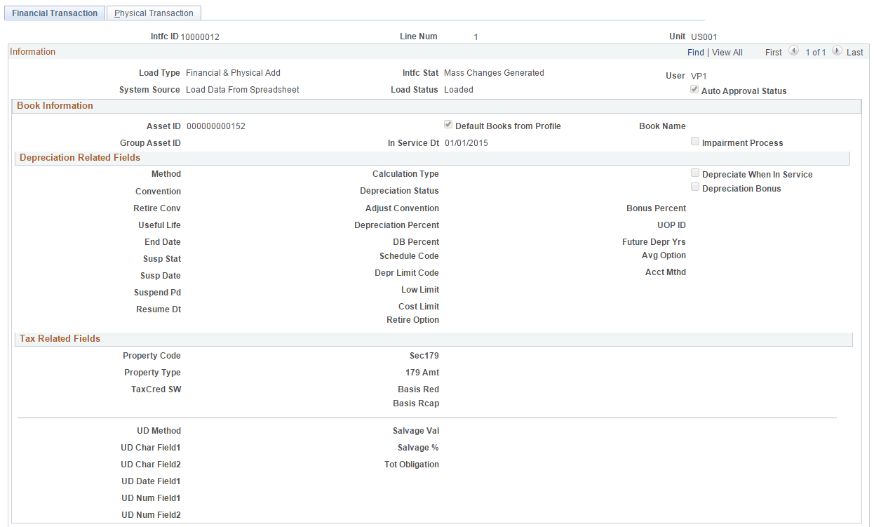

Financial Transaction Page
INTFC_FIN_SS
Use this page to review asset transaction data in the INTFC_FIN table.

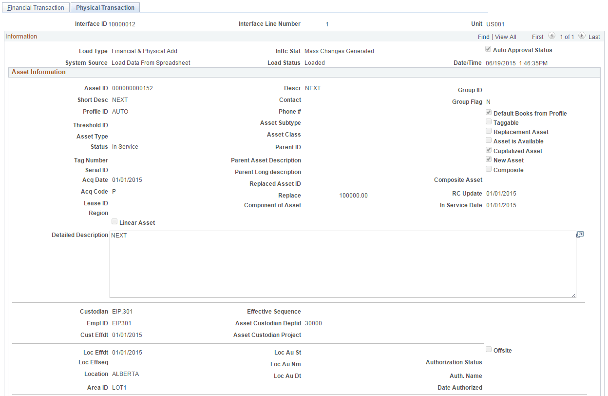

Physical Transaction Page
INTFC_PHY_A_SS
Use this page to review asset transaction data in the INTFC_PHY_A table.

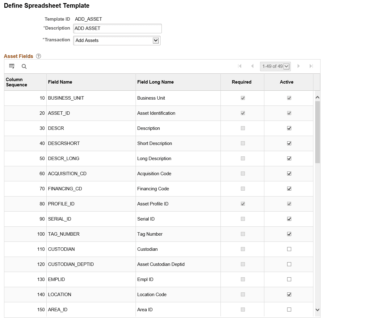

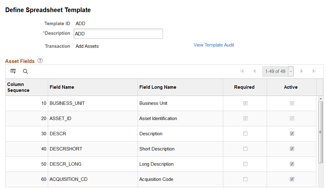

Adding Capitalized Assets Using the Delivered Spreadsheet Template
Add Assets Spreadsheet Template
Define Spreadsheet Template Page (Add Assets)

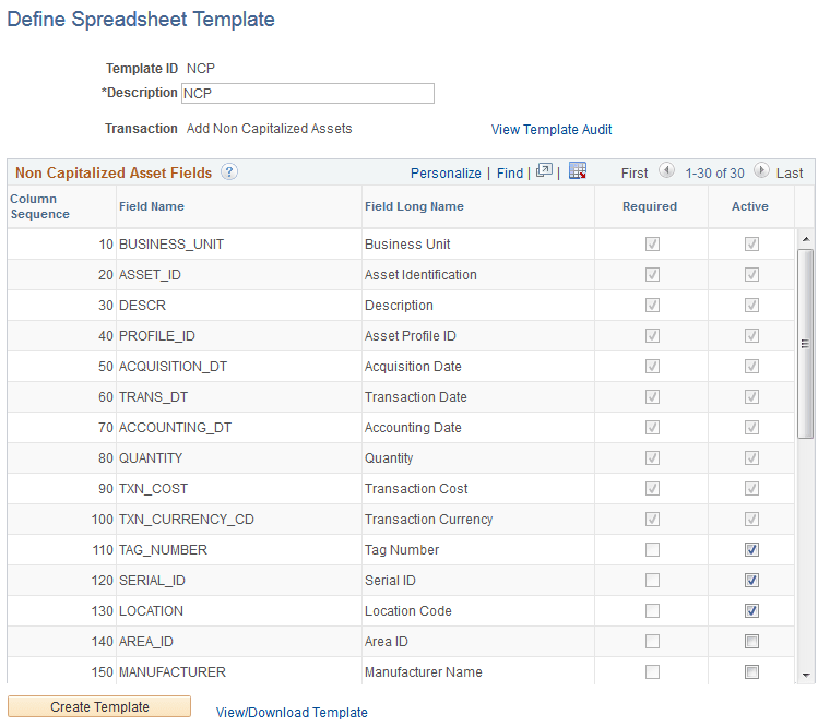

Define Spreadsheet Template Page (Add Non Capitalized Assets)
This template is designed for creating non-capitalized assets. When using this template, ensure you select asset profiles with the Capitalization switch turned off. If a capitalized asset profile is used, the system verifies the threshold ID details associated to that profile to determine whether the asset should be capitalized or non-capitalized.

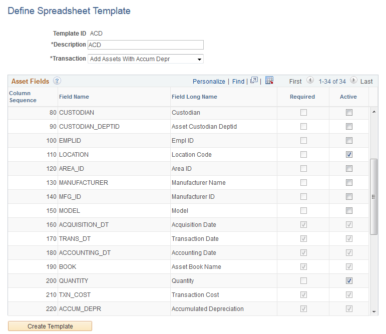

Adding Capitalized Assets with Accumulated Depreciation Using the Delivered Spreadsheet Template
Add Assets with Accumulated Depreciation Spreadsheet Template
Define Spreadsheet Template Page (Add Assets with Accumulated Depreciation)

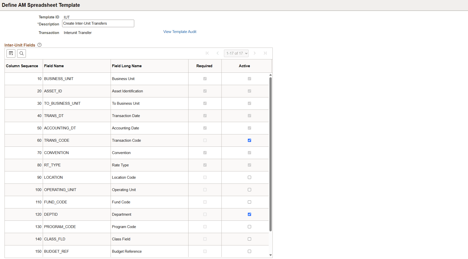

Transferring Assets Between Business Units (Interunit Transfer) Using the Delivered Spreadsheet Template
Inter-Unit Transfer Spreadsheet Template
Define Spreadsheet Template Page (Inter-Unit Transfer)

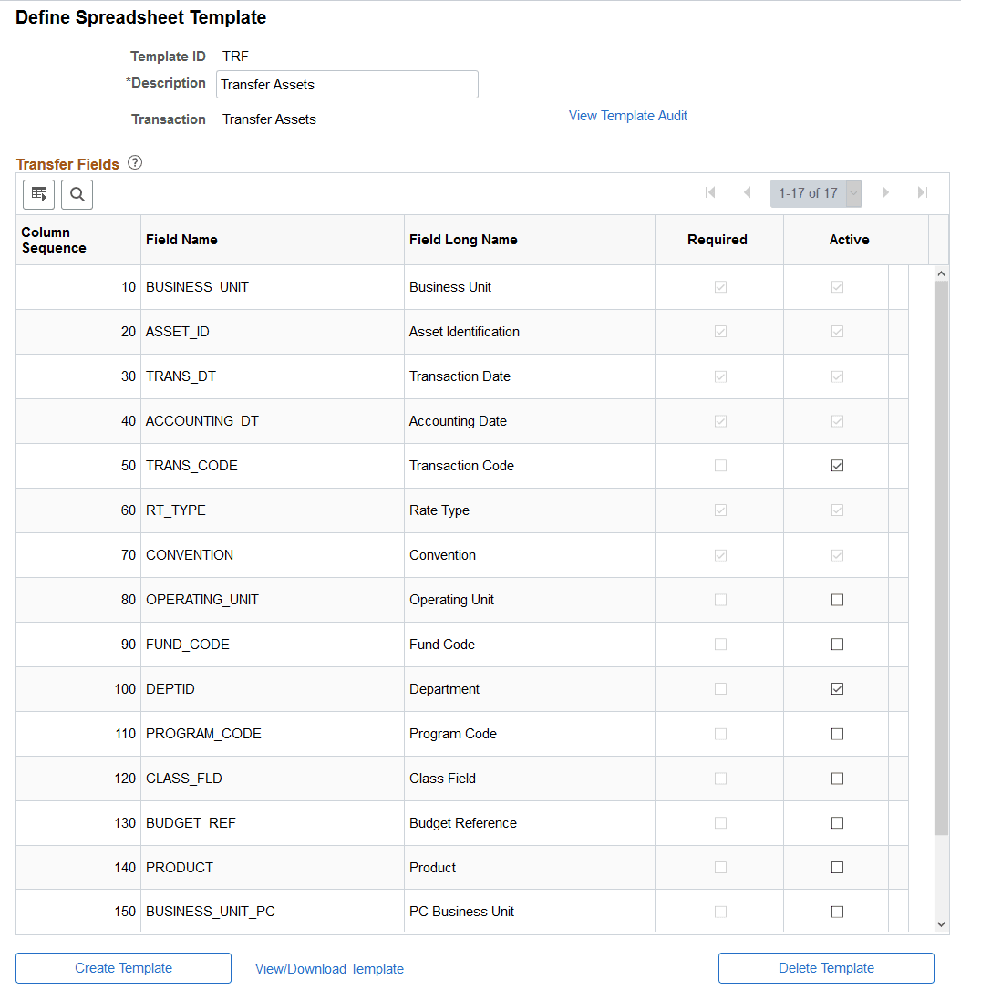

Transferring ChartFields Using the Delivered Spreadsheet Template
Transfer Assets Spreadsheet Template
Define Spreadsheet Template Page (Chartfield Transfer)

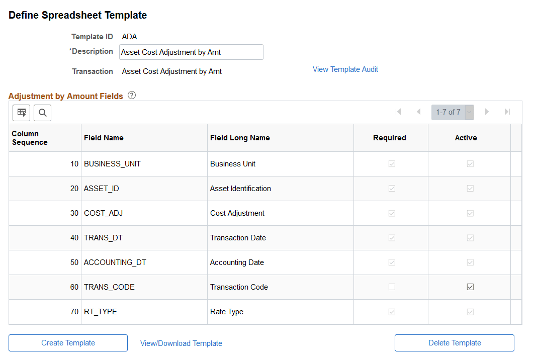

Adjusting Asset Cost Using the Delivered Spreadsheet Template
Adjust Asset Spreadsheet Template
Define Spreadsheet Template Page (Adjust Asset)
Adjusting Asset Cost by Amount Using the Delivered Spreadsheet Template
Asset Cost Adjustment by Amount Spreadsheet Template
Define Spreadsheet Template Page (Asset Cost Adjustment by Amount)

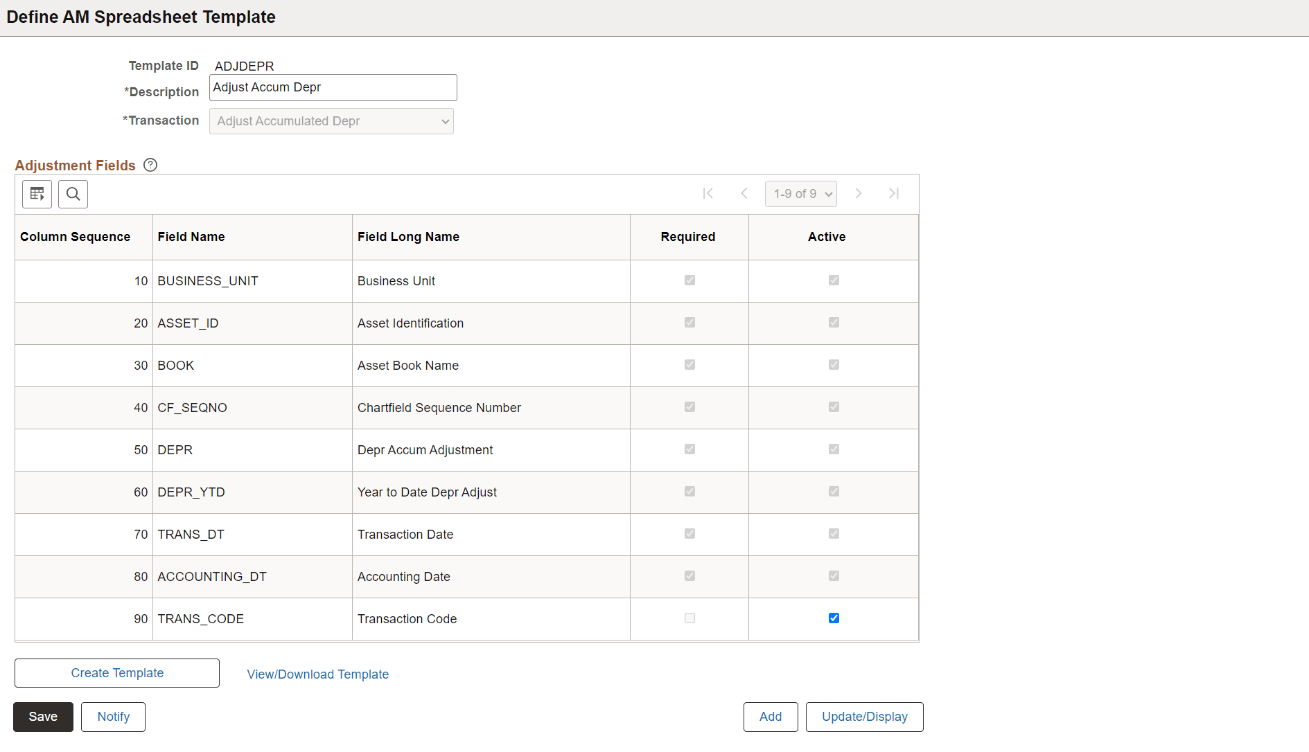

Adjusting Accumulated Depreciation of assets Using the Delivered Spreadsheet Template
Adjust Accumulated Depreciation Template
Spreadsheet Template Page (Adjust Accum Depr)

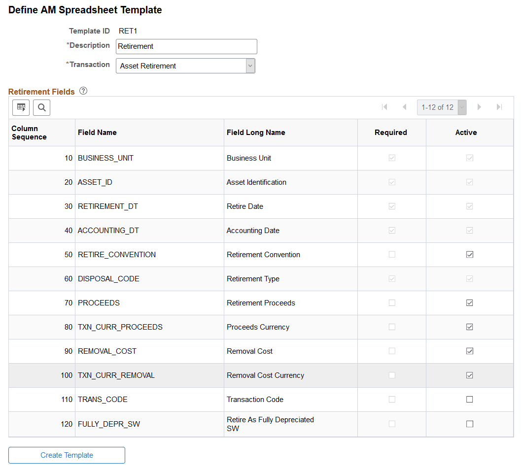

Retiring Assets Using the Delivered Spreadsheet Template
Retire Assets Spreadsheet Template
Define Spreadsheet Template Page (Retire Assets)
The Retirement Convention field is not required. If you do not provide a value for this field in the CSV file, the value automatically defaults from the asset profile. If you provide a value for this field, it overrides the value from the asset profile.

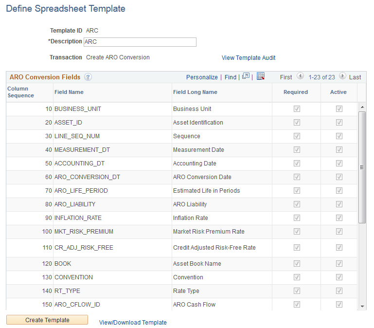

Creating ARO Conversion Using the Delivered Spreadsheet Template
Create ARO Conversion Spreadsheet Template
Define Spreadsheet Template Page (Create ARO Conversion)

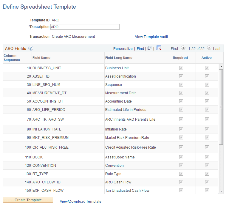

Creating Initial ARO Measurement Using the Delivered Spreadsheet Template
Create ARO Measurement Spreadsheet Template
Define Spreadsheet Template Page (Create ARO Measurement)

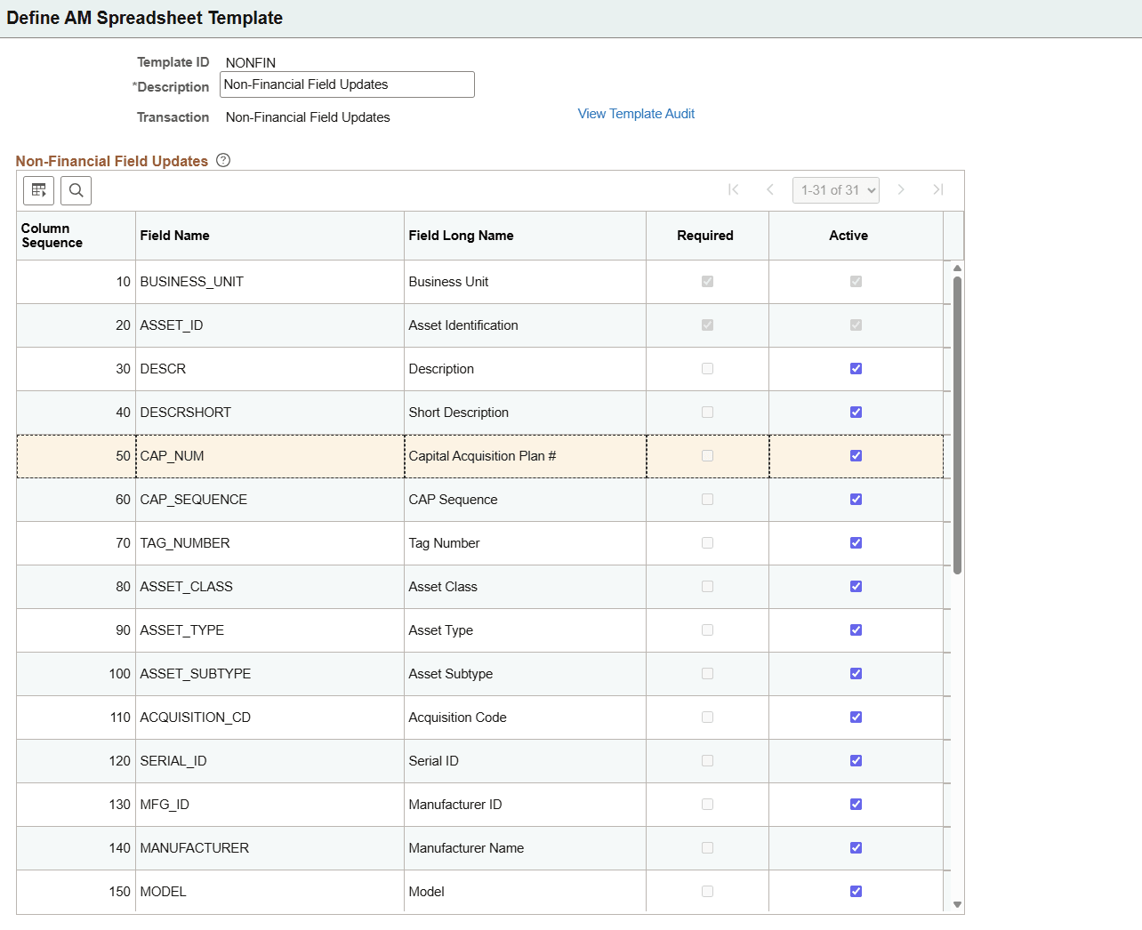

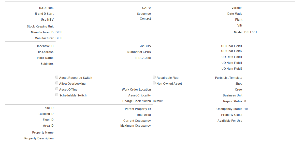

Updating Non-Financial Asset Fields Using the Delivered Spreadsheet Template
Non-Financial Field Updates Spreadsheet Template
Template Page (Non-Financial Field Updates)
This template is designed to update non-financial asset information in bulk, such as asset description, location, custodian, comments, etc. The location and custodian details fields, include an effective date column as an option, so you can specify when the update should take effect.
You can view the new updates on the Basic Add - General Information, Operation/Maintenance, Manufacture/License/Custodian, and Location/Comments/Attributes pages.

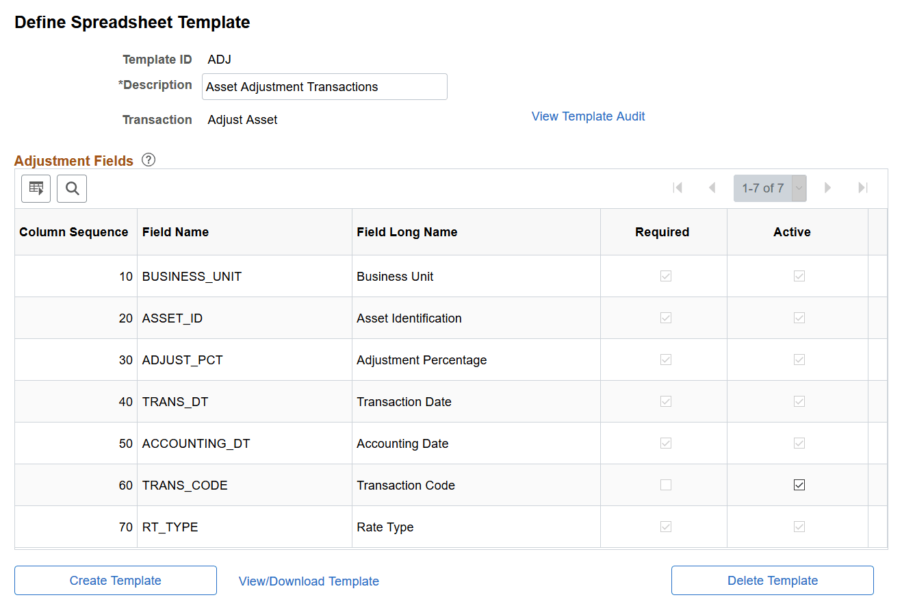

Use the Define Spreadsheet Template page (AM_TEMPLATE) to define spreadsheet template parameters and generate the template (which you will use to populate with your asset transaction data).
Navigation:
Set Up Financials/Supply Chain, and then Product Related, and then Asset Management, and then Import Spreadsheet Setup, and then Define AM Spreadsheet Template, and then Define Spreadsheet Template
This example illustrates the fields and controls on the Define Spreadsheet Template page.
Define Spreadsheet Template page (1 of 2)
Define Spreadsheet Template page (2 of 2)
Field or Control Description
Template ID
Displays the Template ID.
Description
Enter a description for the template CSV file.
This value will appear in the file name of the CSV file.
Transaction
Displays the asset transaction type for the spreadsheet template.
PeopleSoft provides three transaction types from which to choose:
  • Asset Addition (add capitalized assets)
  • Asset Addition With Accum Depr (add capitalized assets with accumulated depreciation)
  • Non Capitalized Asset Addition
  • ARO Conversion
  • ARO Measurement (create initial ARO measurement)
  • Asset Retirement
  • Adjust Accumulated Depr
  • Asset Cost Adjustment with %
  • Asset Cost Adjustment by Amt
  • Asset Recategorization
  • Interunit Transfer
  • Transfer Assets
  • Non-Financial Field Updates
View Template Audit
Click this link to view the Template Audit page and review Created by/Created on and Updated by/Updated on information for the template.
Note: This link does not appear until after you create the template.
View/Download Template
Click this link to view or save the CSV template.
If you are using Google Chrome as your web browser, you must download the file before you can view it.

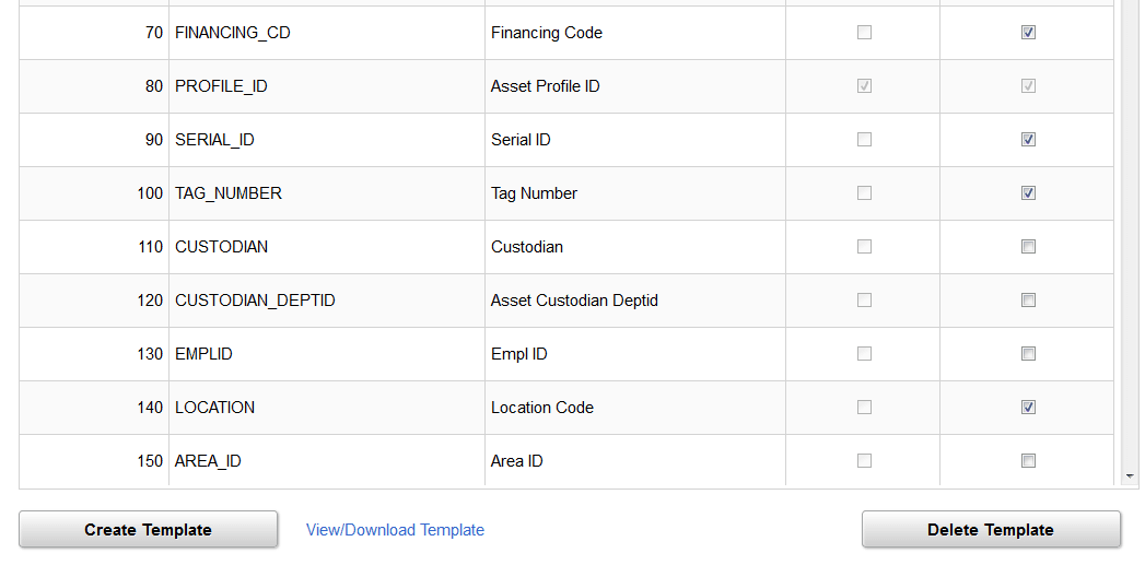

Asset Fields
Use the Asset Fields group box to select columns to appear in the spreadsheet and define the column order. PeopleSoft required columns are automatically selected and cannot be altered.
Column Sequence
Enter a numerical value for the column sequence. This value will provide the column order in the CSV file.
Note: PeopleSoft required fields are prepopulated with column sequence values and you cannot alter these values.
Field Name/Field Long Name
Displays the column name and long name.
Required
This option indicates which columns are required by PeopleSoft.
You cannot alter this option.
Active
Select this option to activate non required columns. Selected columns will appear in the generated CSV file.
Create Template
Click this button to create the spreadsheet template—a Comma Separated Values (CSV) file—based on the parameters you defined on this page.
This process runs the ‘AM_ATT’ application engine, creates the CSV file, and stores the file in the PV_ATT_DB_SRV table.
The CSV file name is automatically prefixed with ‘AM_TEMPLATE_’ for your convenience.
Note: Once you run the Create Template process, the View Template Audit and View/Download Template links appear, and the fields in the Asset Fields group box become unavailable for edit.
Delete Template
Click this button to delete the spreadsheet template and corresponding template CSV file from the file repository system.
You cannot delete the template if it is being used in an Upload Spreadsheet Data run control that has not been processed. To delete the template, you must first complete the Upload Spreadsheet Data process.
Note: This button does not appear during initial template creation; it appears only after you save the template and refresh the page.

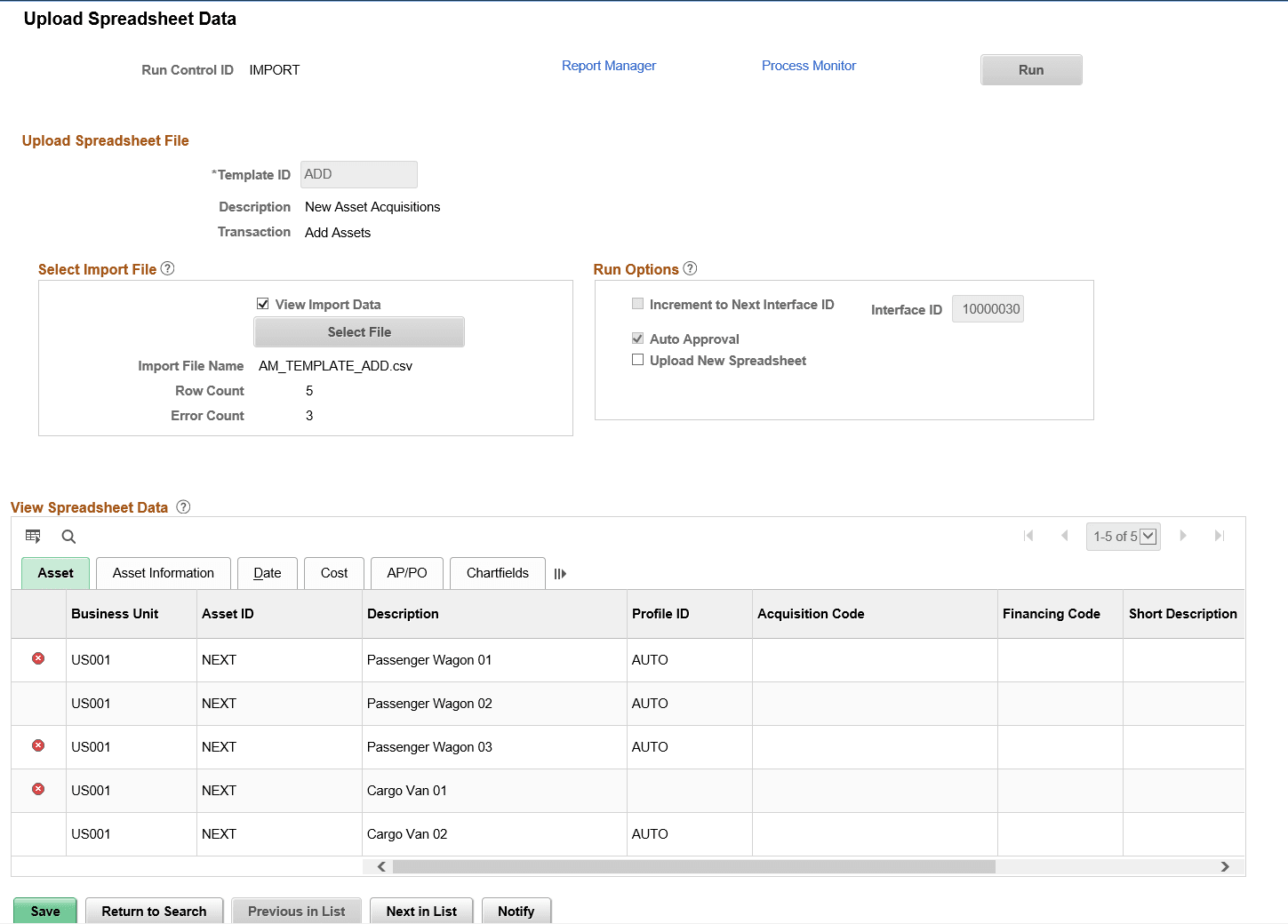

Upload Spreadsheet Data Page
Use the Upload Spreadsheet Data page (AM_LOAD_RQST) to audit and review asset transaction data stored in the CSV file, and load the data to the Asset Management interface tables.
Navigation:
Asset Management, and then Send/Receive Information, and then Import Data via Spreadsheet, and then Upload Spreadsheet Data, and then Upload Spreadsheet Data
This example illustrates the fields and controls on the Upload Spreadsheet Data page.
Run
Click to run the ‘AM_LOAD’ application engine and load asset transaction data in the CSV file to the Asset Management interface tables INTFC_FIN and INTFC_PHY_A.
You cannot run this process if there are error rows in the CSV file, or when the assets being uploaded are mixed approval—that is, some assets require approval and others do not. A validation error will be displayed to indicate this.
Template ID
Select a template ID for the run control.
The template determines what information displays in the View Spreadsheet Data grid.

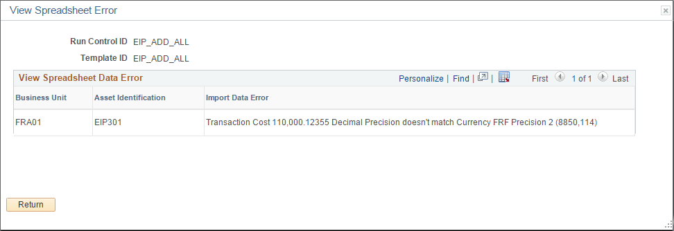

Select Import File
View Import Data
Select this option to display asset transaction data from the CSV file in the View Spreadsheet Data group box (after you have imported the file).
Error data will automatically display in the View Spreadsheet Data group box, even if you do not select this option.
Select File
Click to import the CSV file you created using the Define Spreadsheet Template page. When you click the Select File button, the File Attachment pagelet appears and enables you to navigate to your CSV file.
After selecting the file, click Upload. The system performs a data integrity check on the CSV file and flags errors such as decimal precision, blank fields, currency codes, and so forth. If an error is detected, the row displays within the View Spreadsheet Data group box and is flagged with an error icon. You cannot run the upload process until the error is corrected.
Note: The file chosen for upload must be a Comma Separated Values file and should be populated with your asset transaction data.
Import File Name
Displays the name of the CSV file you imported.
Row Count
Displays the number of rows contained in the CSV file you imported.
Error Count
Displays the number of error rows in the CSV file you imported.
Run Options
Interface ID
Displays the interface ID.
You can override this value with another if you choose.
Note: If you reuse an existing run control ID with the same Interface ID, the AM_LOAD process overwrites the interface data from the previous run.
Auto Approval
Select this option to automatically approve interface lines for the Transaction Loader process.
Use this group box to review asset transaction data from the CSV file you have imported. The group box displays detailed asset information, such as asset ID and location, along with related ChartField and cost information. You can also view whether approvals are required for each asset.
In addition, if a data integrity error is detected in the CSV file, the row is flagged with an error icon and displays here. You cannot run the upload process until the error is corrected. To review detailed error information for a row, click an error icon. Clicking the error icon enables you to access the View Spreadsheet Error page and view error information for the row:
View Spreadsheet Error pagelet
View Spreadsheet Error Page
Use the information on the View Spreadsheet Error page as an aid in correcting data in your CSV file.
This group box does not display on the page until you select the View Import Data option and import the CSV file. However, if a data integrity error is detected in the CSV file, the row displays here regardless of whether you have selected the View Import Data option.

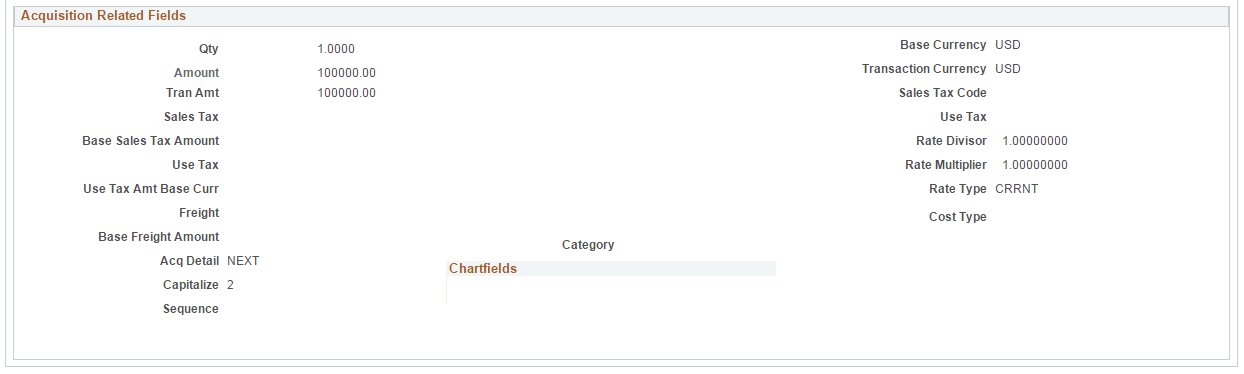

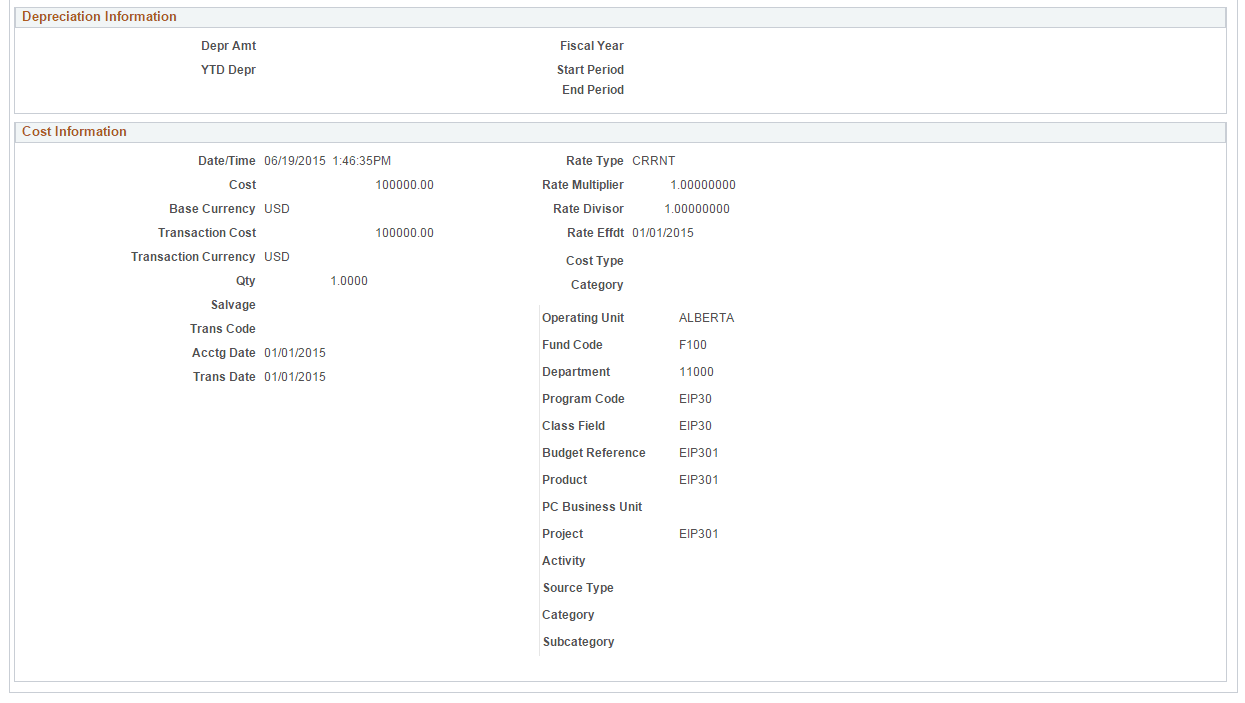

Use the Financial Transaction page (INTFC_FIN_SS) to review asset transaction data in the INTFC_FIN table (after running the ‘AM_LOAD’ process and uploading CSV file data to Asset Management interface tables).
Navigation:
Asset Management, and then Send/Receive Information, and then Import Data via Spreadsheet, and then View Financial & Physical Data, and then Financial Transaction
This example illustrates the fields and controls on the Financial Transaction page.
Financial Transaction Page (1 of 2)
Financial Transaction Page (2 of 2)
Information on this page is display only.
Use the Physical Transaction page (INTFC_PHY_A_SS) to review asset transaction data in the INTFC_PHY_A table (after running the ‘AM_LOAD’ process and uploading CSV file data to Asset Management).
Navigation:
Asset Management, and then Send/Receive Information, and then Import Data via Spreadsheet, and then View Financial & Physical Data, and then Physical Transaction
This example illustrates the fields and controls on the Physical Transaction page.
Physical Transaction Page (1 of 3)
Physical Transaction Page (2 of 3)
Physical Transaction Page (3 of 3)
