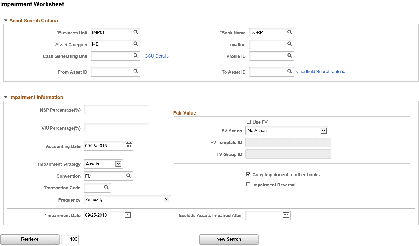

Impairment Worksheet Page
Use the Impairment Worksheet page (AM_IMPAIR) to select criteria to search for assets that can potentially be impaired, to process potential impairment, and to create loss adjustments automatically.
Navigation:
Asset Management, and then Asset Transactions, and then Financial Transactions, and then Impairment Worksheet, and then Impairment Worksheet
This example illustrates the fields and controls on the Impairment Worksheet page (1 of 2). You can find definitions for the fields and controls later on this page.
Impairment Worksheet (1 of 2)
Enter the asset search criteria and impairment information.
Field or Control Description
Business Unit
Select the business unit (required). The business unit is supplied from the search dialog box.
Book Name
Select the book name (required). The Book Name field is initially supplied by the default book (when the book is enabled for impairment processing). The valid values include only books for which impairment processing enabled.
Asset Category
Select the asset category to search for assets by category. The valid values include only categories for which impairment processing is enabled.
Location
Select the asset location to search for assets by location. The valid values include only locations for which impairment processing is enabled.
Cash Generating Unit
Select from the valid CGUs for this business unit, book, profile, or category if you want to impair at the CGU level.
Profile ID
Select the asset profile ID to search for assets by profile. The valid values include only locations for which impairment processing is enabled.
From Asset ID and To Asset ID
Select an asset ID or a range of asset IDs to be included.
ChartField Search Criteria
Click the link to supply more filter options by ChartField to further narrow the search.
NSP Percentage (%) (net selling price percentage)
Apply and enter a net selling price percentage to determine the actual NSP.
Net selling price is the amount that is obtainable from the sale of an asset in a bargained transaction (between knowledgeable, willing parties), less the costs of disposal.
For example, suppose the net book value of an asset is 10,000.00 USD. But the NSP is equal to 8,000.00 USD. The NSP percent is equal to 80 percent.
Copy Impairment to other books
Select if you want the impairment carried over to other books.
VIU Percentage (%) (value in use percentage)
Enter the value in use percentage that you expect to determine the actual VIU amount.
Value in use is the present value of estimated future cash flows that are expected to arise from the continuing use of an asset, and from its disposal at the end of its useful life.
For example, suppose the net book value of an asset is 23,500.00 USD. But the VIU is unknown. You can apply a percentage that you expect , such as 70 percent, and the system will calculate the actual amount to be 16,450.00 USD.
Impairment Reversal
Select if the potential impairment is a reversal of a prior impairment adjustment.
Note: This option appears only if impairment reversal is enabled for the business unit.
Accounting Date
Enter the accounting date of the impairment.
Convention
Select the depreciation convention. The valid values are derived from those that are defined for the business unit.
Impairment Strategy
Select the impairment strategy. Valid values are: Asset and CGU.
  • Asset: If asset is selected, the system makes the impairment adjustment asset by asset.
  • CGU: If CGU is selected, the system calculates the adjustment to the whole CGU as a body. Impairment is based on all assets that are part of CGU definitions. If CGU is selected, then a cash generating unit must be provided. The CGU field in the search criteria section is only used to find out specific groups but it does not say what kind of impairment will apply to them.
Frequency
Select the frequency for performing the impairment test. the options include Yearly, Semiannually, Quarterly, Monthly, and Other
Impairment Date
This is the transaction date on which the system calculates carrying cost (NBV). The depreciation for the impairment month is included in the NBV calculation. For example, if the impairment date is between December 12, 2003 and December 12, 2003, period 12 is included in the accumulated depreciation for the calculation:
NBV=Cost-ACCUM
Exclude Assets Impaired After
Enter the dates to exclude more recently impaired assets.
Use FV(use fair value)
Select to retrieve the fair values in the NSP amount or VIU amount fields instead of using the NSP Percentage(%) or VIU Percentage(%) fields for impairments. These fields become unavailable when selecting the Use FV field. If this check box is not selected, the fair values are retrieved from the NSP Percentage(%) or the VIU Percentage(%) fields for impairments.
FV Action(fair value action)
Select the action by which to update the fair value records from the NSP or VIU amount fields. Select from the following fair value actions:
  • No Action - (default) If Use FV is selected in conjunction with this action, the fair values are retrieved in the NSP or VIU amount fields but the fair values will not be updated.
  • Update From NSP - If Use FV is selected in conjunction with this action, the fair values are retrieved in the NSP Amount field to update impairments and fair values.
  • Update From VIU - If Use FV is selected in conjunction with this action, the fair values are retrieved in the VIU Amount field to update impairments and fair values.
  • Update Higher - If Use FV is selected in conjunction with this action, the fair values are updated from the higher value that is entered on the NSP or VIU Amount in the results grid.
FV Template ID(fair value template ID)
Select an existing fair value template to populate the fair value fields. When the Retrieve button is pushed, the FV Template ID and Group ID in the Asset Search Results will be defaulted from the values in the Impairment Information section.
FV Group ID(fair value group ID)
Select when the valuation premise from the FV Template is In-Use. You can override the default value from the template. This field is unavailable if the valuation premise from the FV Template is In-Exchange.
See Asset Lifecycle Management Fundamentals: Defining Fair Value Processing.
When you are finished entering search criteria and impairment information, initiate the retrieval process. On completion, the Search Criteria group box collapses. The Impairment Information group box is visible, but unavailable for entry. You can initiate a new search or refine search of your returned results.

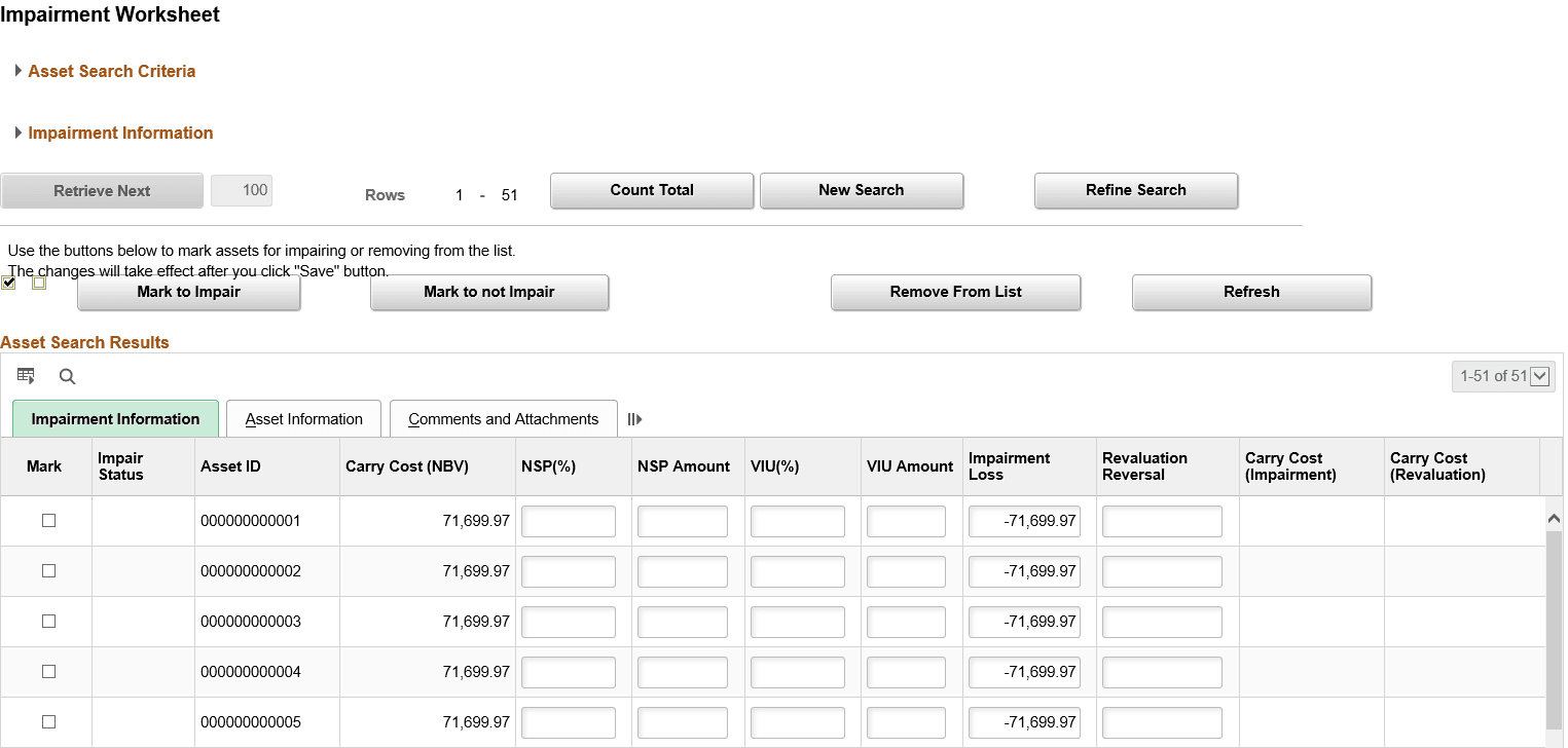

This example illustrates the fields and controls on the Impairment Worksheet page (2 of 2). You can find definitions for the fields and controls later on this page.
The results of the assets matching the criteria that are entered are displayed in the Asset Search Results grid on the worksheet. The grid contains three tabs:
  • Impairment Information
  • Asset Information
  • Comments and Attachments
Use the buttons to mark assets to be impaired and assets not to be impaired, to remove assets from the list, and to refresh the page.
Selected assets must already have been processed for depreciation and included in the load depreciation report table process before they are available to be reported in the impairment worksheet.
This section enables you to select or exclude selected assets for impairment.
Mark Check button
When you click the Check button, you will select all assets in the list. Use Mark to select the line.
Mark to Impair
Click Mark to Impair and the system will set Impair Status toImpair for all selected rows.
Mark to not Impair
Click Mark to Not Impair and the system will set Impair Status to Don't Impair for all selected rows.
Mark to Update FV
Click Mark to Update FV and the system will set Impair Status to FV for all selected rows.
Remove From List
Click Remove From Listto remove selected rows from Asset Search Results.
Refresh
Click Refresh to recalculate all impairment information.
Impair Status
Displays the status of selected assets to be impaired or not to be impaired. Impaired assets will be inserted into INTFC_FIN table and Impairment audit tables. Not impaired assets will be inserted into the impairment audit tables.
Asset ID
Displays the asset ID for all assets meeting the search criteria.
Carry Cost (NBV)
Displays the current carry cost (net book value) of the asset.
NSP%
Enter the net selling price percentage that is applied to the carry cost.
NSP Amount
Enter the NSP as an amount in the base currency.
VIU%
Enter the value in use percentage that is applied to the carry cost.
VIU Amount
Enter the VIU as an amount in the base currency.
Impairment Loss
Displays the calculated impairment loss, usually the disposal cost. Impairment loss = NBV- (greater than NSP or VIU). You can override this amount.
Revaluation Reversal
If this asset had a revaluation before, you need to reverse the revaluation before you allocate the loss.
Carry Cost (Impairment)
The remaining amount that is attributable to prior impairment loss.
Carry Cost (Revaluation)
The remaining amount that is attributable to prior impairment reversal.
Comments
Click the Comments link to access the Asset Comments page. Use this page to view or add relevant supporting comments to an asset transaction.
Click the Attachments link to access the Asset Attachments page. You can view or add relevant supporting attachments to an asset transaction.
When you have reviewed and selected assets to be impaired, save the worksheet. The saving process performs the following tasks:
  • The system creates a cost adjustment (with user define impairment loss cost type) for the impairment loss.
  • The system creates a cost adjustment (user defined impairment reversal cost type) for the impairment revaluation reversal.
  • The transaction date and the impairment date are inserted and is the same for this transaction.
  • If you do not provide an accounting date, the system looks for the last day of the open period and books the transaction against that date. This date is validated against the open period.
  • The system commits all validations at the time of the save.
  • Upon saving the worksheet, the system places the actual adjustment in the staging table INTFC_FIN.
    The system loads the adjustment in the main asset tables when the transaction loader (AMIF1000) is run.
  • The system automatically triggers the transaction loader (AMIF1000) to load the transactions if this option has been selected.
  • The system validates that the impairment date is less than or equal to the accounting date.
  • When the impairment reversal box is checked, the system processes impairment reversal instead of impairment loss.

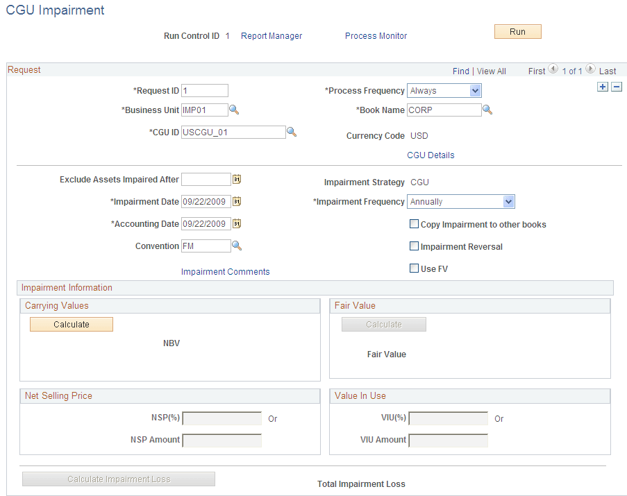

CGU Impairment Page
Use the CGU Impairment page (AM_CGU_IMP_RUN_CTL) to allocate impairment losses to individual assets on a CGU basis.
Navigation:
Asset Management, and then Asset Transactions, and then Financial Transactions, and then Cash Generating Unit Impairment, and then CGU Impairment
This example illustrates the fields and controls on the CGU Impairment page. You can find definitions for the fields and controls later on this page.
CGU Impairment page
Complete the applicable fields. When satisfied with the criteria, click Run. The batch process allocates CGU impairment data to each asset.
Request
Business Unit
Book Name
Select the book name (required). The book is initially supplied by the default book (when the book is enabled for impairment processing). The valid values include only books for which impairment processing is enabled.
Currency Code
The currency code as defined for the Book.
CGU ID
Enter dates to exclude more recently impaired assets.
Impairment Date
Enter the date of the asset impairment. This is the transaction date on which the system calculates carrying cost (NBV). The depreciation for the impairment month is included in the NBV calculation. The system uses the current date by default.
Impairment Strategy
CGU: Impairment based on all assets that are part of CGU definitions.
The impairment strategy CGU appears by default when you are processing impairment in batch mode.
PeopleSoft Asset Management copies the impairment amount to other books in the ledger group as long as the Keep Ledgers in Sync (KLS) option is selected. If the option Copy to Other Books is checked, PeopleSoft Asset Management copies the same amount to the books with impairment amount selected, for books that do not point to the ledger group. Depending on the selection of these options, when Copy Zero Impair/Revalue Rows is checked, then the system copies zero impairment data in all the remaining books.
For example: Suppose you have a business unit with six books (A, B, C, D, E, F), with the first three books, A, B and C pointing to a ledger group, the ledger group is synchronized with the general ledger business unit and book B is pointing to the primary ledger. However, the other three books, D, E and F do not point to general ledger and books A, B, C, and E have the impairment option enabled. PeopleSoft Asset Management processes impairment loss against the primary book B. The system then copies the impairment loss to book A and book C because they are in the same ledger group regardless of the status of the optionsCopy Impairment to other books and Copy Zero Impair/Revalue Rows . If Copy Impairment to other books is selected, the system copies the same impairment loss to book E because the impairment option is selected for that book. If the Copy Zero Impair/Revalue Rows option is selected, the system copies zero impairment loss into book D and F. If theCopy Impairment to other books option is not selected andthe Copy Zero Impair/Revalue Rows option is selected, the system copies zero impairment rows to books D and F. When both options are not selected, the system does not copy any impairment or revaluation row to books D, E and F.
See Application Fundamentals: Setting Up Cross-Application Installation Options, :Asset Management Page”.
See Asset Lifecycle Management Fundamentals: Creating PeopleSoft Asset Management Cash Generating Units.
Accounting Date
Impairment Frequency
Select the frequency for performing the impairment test. The options include Yearly, Semiannually, Quarterly, Monthly, and Other
Impairment Reversal
Select for the system to process impairment reversal instead of impairment loss.
Click the Calculate button to compute the net book value, prior impairment loss, and prior revaluation reversal.
Click the Calculate Impairment Loss button to calculate the total impairment loss.
Note: This option is available only if impairment reversal is enabled for the business unit.
Convention
Select to retrieve fair values that were previously captured. This selection enables the Fair Value group box and disables the Carrying Values group box.
Note: You are not allowed to update fair values using the CGU impairment process.
Carrying Values
The NBV is the equivalent to the carrying value.
Click the Calculate button to retrieve the current NBV for the selected assets.
Fair Value
Fair Value
Click the Calculate button to retrieve the current fair value for the selected assets.
Net Selling Price
Enter the net selling price percentage.
For example, suppose the net book value of an asset is 10,000.00 USD. But the net selling price (NSP) is equal to 8,000.00. The NSP percent is equal to 80 percent.
Net selling price is the amount obtainable from the sale of an asset in a bargained transaction (between knowledgeable, willing parties), less the costs of disposal.
NSP Amount) (net selling price)
Enter the net selling price amount.
Value In Use
VIU % (value in use percentage)
Enter the value in use percentage.
Value in use is the present value of estimated future cash flows that is expected to arise from the continuing use of an asset, and from its disposal at the end of its useful life.
For example, suppose the net book value of an asset is 10,000.00 USD. But the VIU is equal to 7,200.00 USD. The VIU percent is equal to 72 percent.
VIU Amount
Enter the value in use amount. Value in use is the present value of estimated future cash flows that are expected to arise from the continuing use of an asset, and from its disposal at the end of its useful life.
Click the Calculate Impairment Loss button to compute total impairment loss.

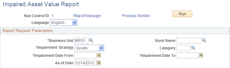

Reporting Asset Impairment Activity
Use the Impaired Asset Value Report page (AM_IMP_RPT_RUN_CTL) to generate reports by category or CGU ID of impaired asset values.
Navigation:
Asset Management, and then Financial Reports, and then Cost and Depreciation, and then Asset Impairment Report, and then Impaired Asset Value Report
This example illustrates the fields and controls on the Impaired Asset Value Report page. You can find definitions for the fields and controls later on this page.
Enter the report criteria for the report. You can have the report output sorted by asset category or by asset CGU ID. You can see the report formats in the Reports topic.
The business unit, impairment strategy and impairment date are required for the report.
You must run the load depreciation report process for the dates on which you plan to evaluate the assets or CGU in order to perform the impairment.
See Transaction Reports.
