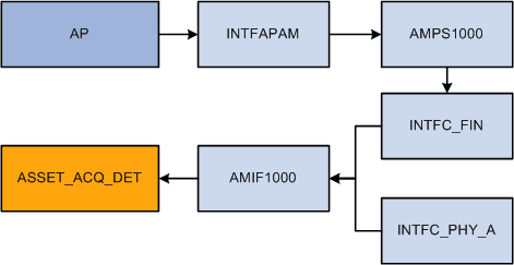

This diagram illustrates the interface process:
PeopleSoft Payables to PeopleSoft Asset Management GST process
