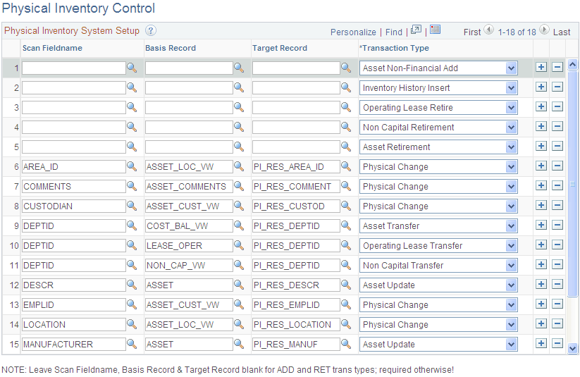

Physical Inventory Control Page
Use the Physical Inventory Control page (PI_SYSTEM_SETUP) to review relationships between physical inventory fields and Transaction Type.
Navigation:
Set Up Financials/Supply Chain, and then Product Related, and then Asset Management, and then Physical Inventory, and then AM Physical Inventory Control, and then Physical Inventory Control
This example illustrates the fields and controls on the Physical Inventory Control page. You can find definitions for the fields and controls later on this page.
When you generate the physical inventory results, the Structured Query Report (SQR) AMPI1000 uses data from this page to compare asset field values and determines the types of transactions that need to be generated. After the physical inventory is reconciled, the Transaction Loader process (AMIF1000), will then load transactions into PeopleSoft Asset Management.
The information on this page is prepopulated to work with the delivered physical inventory programs. Modify this page only if you have made alterations to the physical inventory system—for example, by creating new fields.

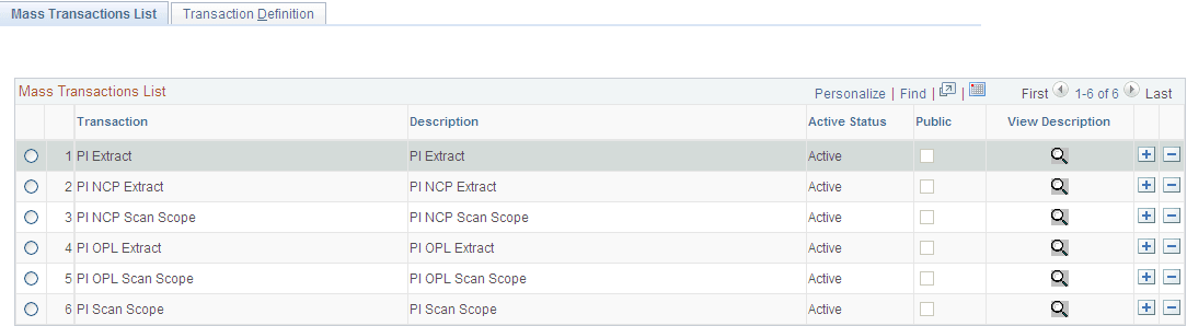

Mass Transaction Definition - Mass Transactions List Page
For classic physical inventory, use the Mass Transaction Definition – Mass Transactions List page (PSDMT_UNITS_01) to view the delivered Mass Transaction templates used in extracting and scanning asset physical inventory data.
For mobile physical inventory, use the Mass Transaction Definition – Mass Transactions List page (PSDMT_UNITS_01) to view the delivered Mass Transaction templates used in scanning asset physical inventory data.
Navigation:
Set Up Financials/Supply Chain, and then Product Related, and then Asset Management, and then Mass Transaction Manager, and then AM Mass Transaction Definition Mass Transactions List
This example illustrates the fields and controls on the Mass Transactions List page. You can find definitions for the fields and controls later on this page.
PeopleSoft delivers the following Mass Transactions that can be used in performing asset physical inventory:
  • PI Extract – Physical Inventory extract scope for capital assets (classic physical inventory only)
  • PI NCP Extract – Physical Inventory extract scope for non capital assets (classic physical inventory only)
  • PI OPL Extract – Physical Inventory extract scope for operating leases (classic physical inventory only)
  • PI Scan Scope – Physical Inventory scan scope for capital assets
  • PI NCP Scan Scope – Physical Inventory scan scope for non capital assets
  • PI OPL Scan Scope – Physical Inventory scan scope for operating leases
For the extract templates, the Mass Transaction Definition is used to extract asset data from multiple Asset Management tables into one physical inventory extract table. This extract data may be reviewed before downloading to a bar code scanner file.
It is not advisable to change these delivered transaction definitions.

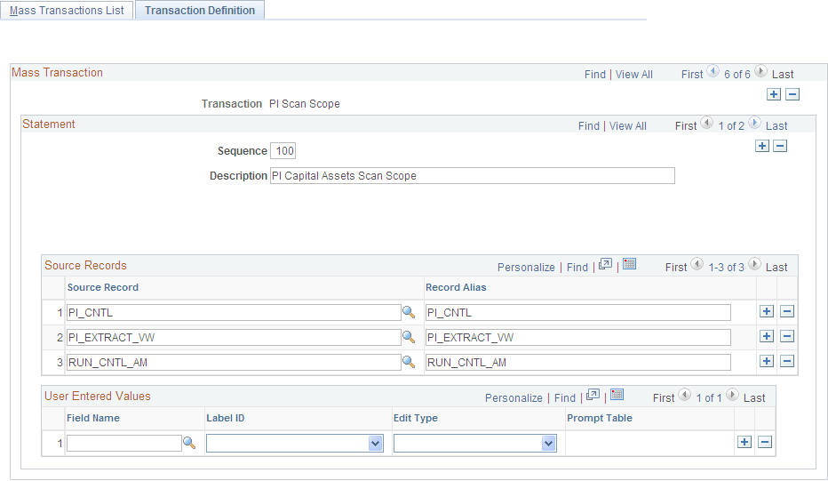

Mass Transaction Definition – Transaction Definition Page
Use the Mass Transaction Definition – Transaction Definition page (PSDMT_UNITS_02) to view, add to, or manage the delivered Mass Transaction Definitions used in performing asset physical inventory.
Navigation:
Set Up Financials/Supply Chain, and then Product Related, and then Asset Management, and then Mass Transaction Definition, and then Transaction Definition
This example illustrates the fields and controls on the Mass Transaction Definition - Transaction Definition page. You can find definitions for the fields and controls later on this page.
This page defines the source (selection) records, associated record alias, and any user entered values to be accessed in physical inventory processing. You should not change these values for the delivered definitions unless you have added records and views that are to be used in physical inventory processing.
Field or Control Description
Sequence
The sequence number Indicates the order in which the SQL statements will run.
Description
Describes the mass transaction definition.
User Entered Values
You can add record fields to the template for selection criteria to limit the extract or scan data.

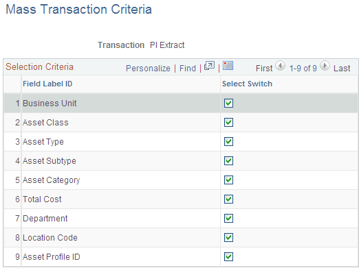

Mass Transaction Criteria Page
Use the Mass Transaction Criteria page (PSDMT_UDC) to enable the fields that are to be used for specifying selection criteria for the physical inventory process.
Navigation:
Set Up Financials/Supply Chain, and then Product Related, and then Asset Management, and then Mass Transaction Manager, and then AM Mass Transaction Criteria
This example illustrates the fields and controls on the Mass Transaction Criteria page. You can find definitions for the fields and controls later on this page.
Select the fields to appear on the Inventory Occurrence - Enter Criteria page. They are to be used for defining the selection criteria for the physical inventory extract and scan scopes.
See Define Inventory Occurrence – Enter Criteria Page
