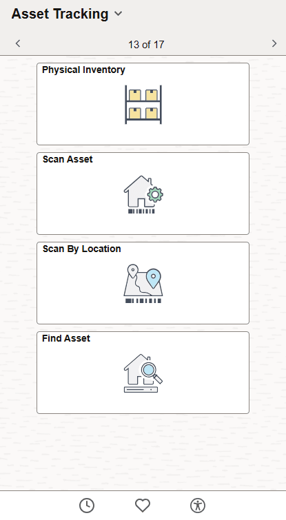

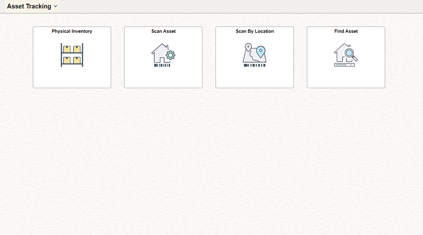

To support mobile asset tracking, the homepage includes three key tiles:
  • Scan Asset - Scan an asset’s code to access its general details, maintenance schedules, and work orders.
  • Scan By Location - Enter a location and scan assets in that area, with the option to update their location in PeopleSoft.
  • Find Asset - Search for assets by manually entering search criteria.
With these tools, users can efficiently track and manage assets from their mobile device or scanning device, improving visibility and data accuracy in Asset Management.

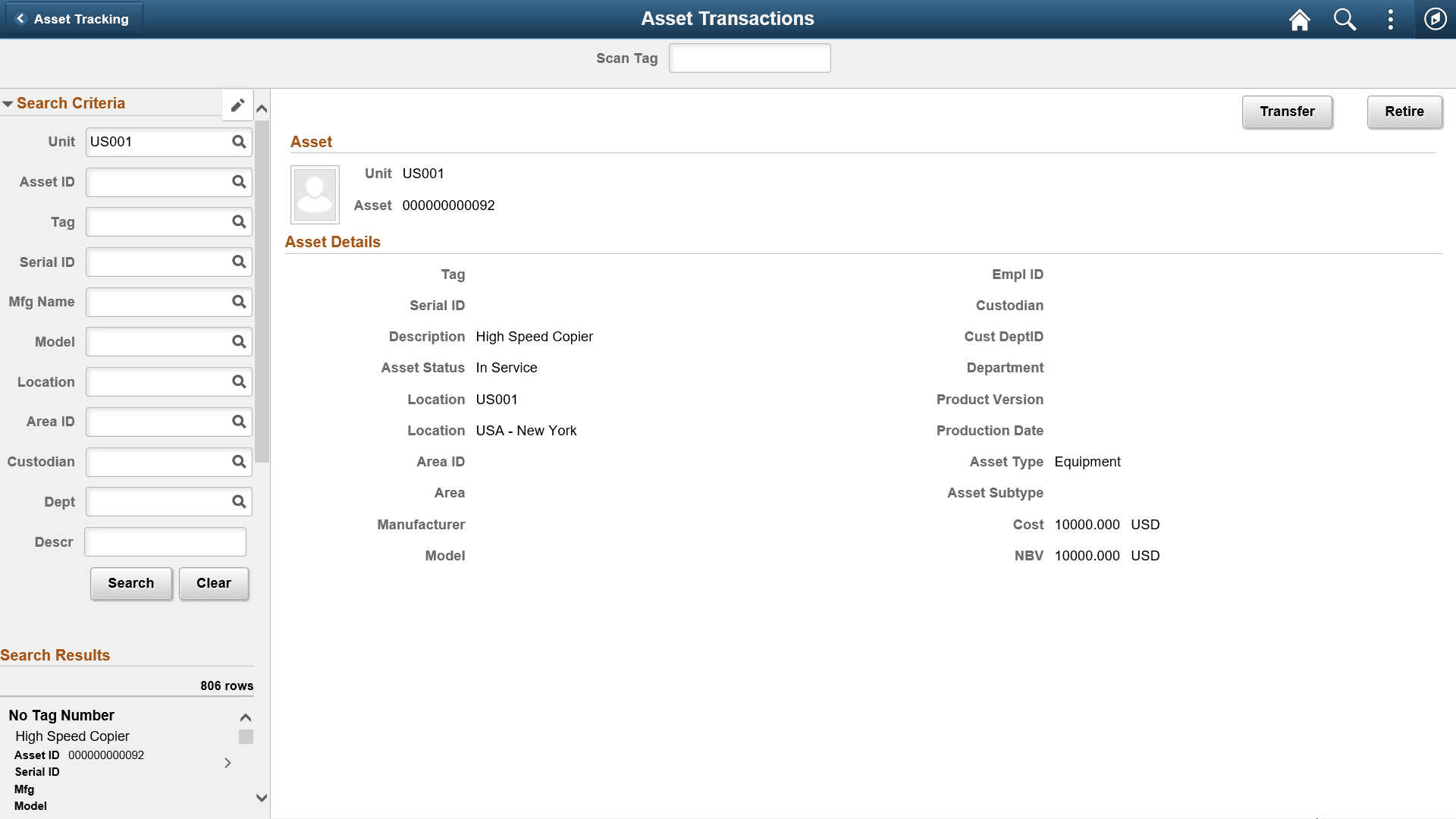

Asset Tracking tiles in the Asset Tracking homepage
Asset Tracking Fluid Home page_Smartphone
This example illustrates the fields and controls on the Asset Tracking home page. You can find definitions for the fields and controls later on this page.
The asset tracking tiles are part of the PeopleSoft Fluid User Interface and can be accessed from your mobile device or mobile scanning device.

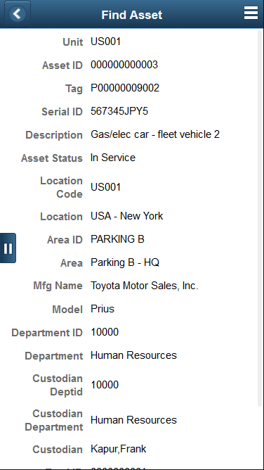

Use the Find Asset tile to retrieve information for assets without scanning a barcode.

Find Asset Page
AM_FIND_ASSET_FL
Retrieve information for assets without scanning a barcode. You cannot edit asset information on the Find Asset page.

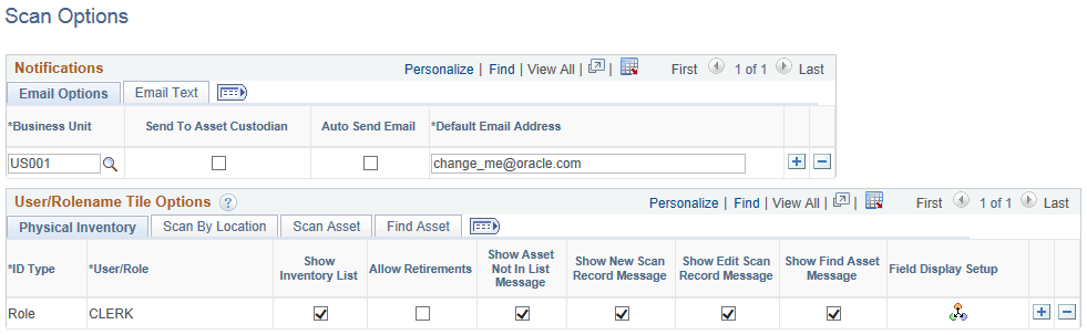

Scan Options Page
Use the Scan Options page (PI_SCAN_OPTIONS) to define email notification defaults and configure field level authorization for the pages within the Asset Tracking homepage.
Navigation:
Setup Financials/Supply Chain, and then Product Related, and then Asset Management, and then Physical Inventory, and then Asset Tracking Scan Options, and then Scan Options
This example illustrates the fields and controls on the Scan Options page (1 of 5). You can find definitions for the fields and controls later on this page.
This example illustrates the fields and controls on the Scan Options page (2 of 5). You can find definitions for the fields and controls later on this page.
This example illustrates the fields and controls on the Scan Options page (3 of 5). You can find definitions for the fields and controls later on this page.
This example illustrates the fields and controls on the Scan Options page (4 of 5). You can find definitions for the fields and controls later on this page.
This example illustrates the fields and controls on the Scan Options page (5 of 5). You can find definitions for the fields and controls later on this page.

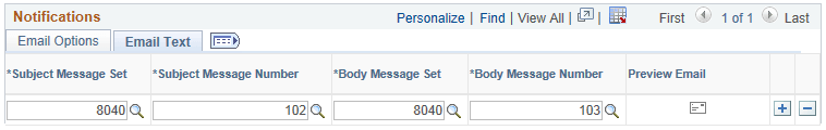

Notifications
Use this group box to define email notification defaults for all four tiles within the Asset Tracking homepage. The parameters you define here correspond to the Notify (email notification) option associated with the Actions List.
Field or Control Description
Business Unit
Select the business unit for which you will apply email notification defaults.
Send to Asset Custodian
Select this option to send notifications to the asset custodian (instead of the default email address) when you use the Notify feature in the Actions List.
When you select this option, the To field of the Email Notification pagelet is automatically populated with the email address of the asset custodian.
Asset custodian email address is defined on the PeopleTools User Profiles page. If custodian email address does not exist, the To field of the Email Notification pagelet is automatically populated with the default email address defined on this page.
Auto Send Email
Select this option to bypass the Email Notification pagelet and automatically send an email when you select the Notify feature from the Actions List.
Default Email Address
Enter a default email address that will automatically populate the To field of the Email Notifications pagelet when you use the Notify feature from the Actions List.
Use the Email Text tab to define subject line and message body default text for the Email Notifications pagelet when you use the Notify feature from the Actions List. PeopleSoft Asset Management delivers Message Catalog Set Number 8040 and Message Numbers 102 and 103.
You can modify the delivered messages, but you must ensure you accurately maintain the bind variables when doing so.

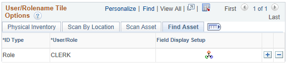

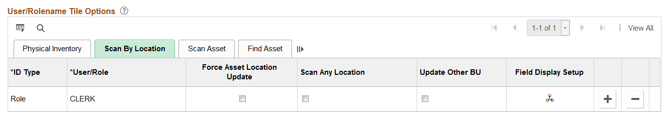

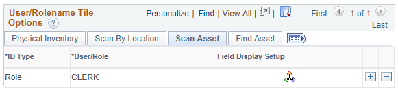

User/Rolename Tile Options
Use this group box to configure field authorization for the Asset Tracking homepage. You can configure field behavior at an individual (user) level or by role. There are four tabs in this group box, each corresponding to one of the four Asset Tracking homepage tiles.
If a user belongs to multiple roles, the superset of enabled options is used.
ID Type
Select the ID type for which you will configure field behavior. You can select User or Role.
User/Role
Select an individual user or role.
Scan Options - Field Display Setup icon
Click the Field Display Setup icon to access the Field Display Setup page and configure individual field display and edit properties.
Show Inventory List (Physical Inventory)
Select this option to display the asset inventory list on the Physical Inventory page.
If you do not enable this option, the asset inventory list is hidden from the Physical Inventory page.

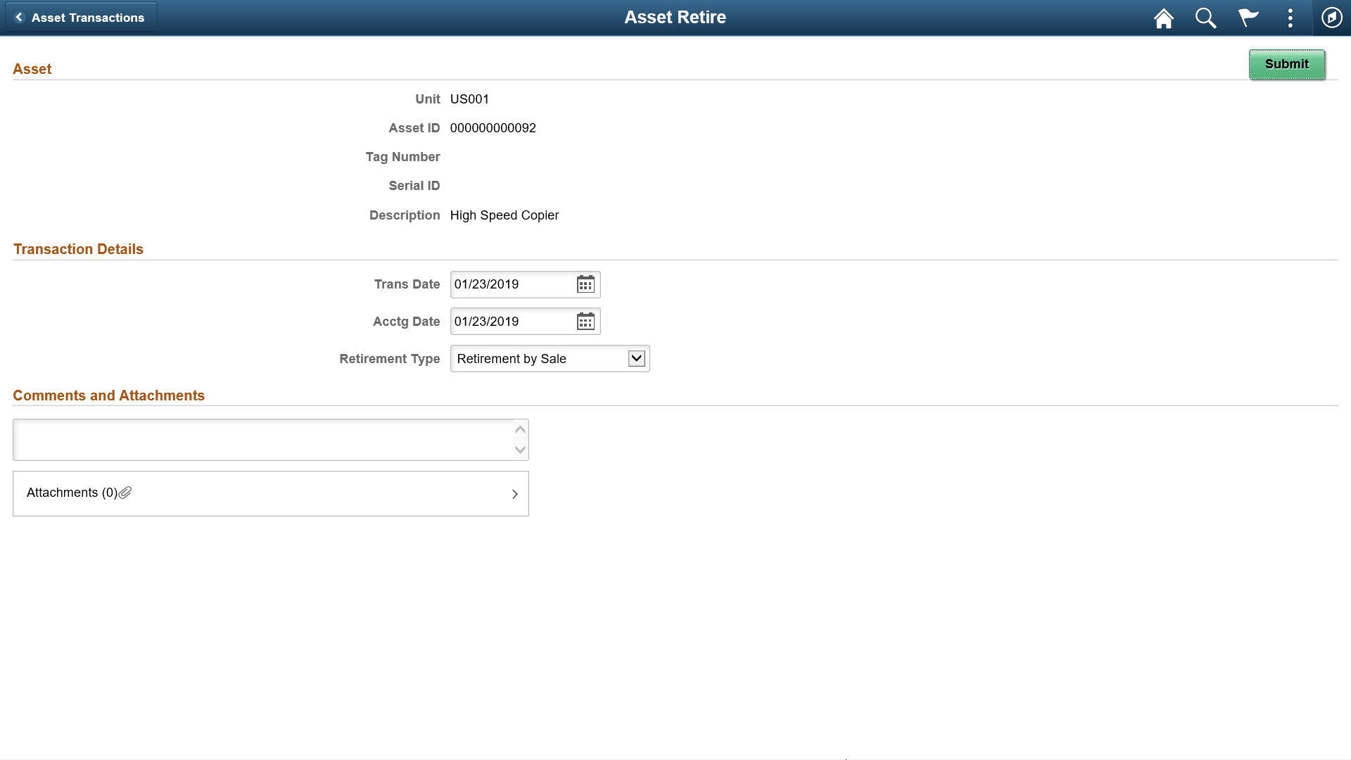

Allow Retirements (Physical Inventory)
Select this option to enable asset retirement using the Edit Scan Record page from the Physical Inventory tile.
Show Assets Not in List Message (Physical Inventory)
Select this option to display an alert on the Physical Inventory page when a scanned asset is not in the Scan Scope.
Show New Scan Record Message (Physical Inventory)
Select this option to display a confirmation message on the Physical Inventory page when you create a new asset and click the Done button in the New Asset Scan Record page.
Show Edit Scan Record Message (Physical Inventory)
Select this option to display a confirmation message on the Physical Inventory page when you edit an asset scan record and click the Done button in the Edit Scan Record page.
Show Find Asset Message (Physical Inventory)
Select this option to display a confirmation message on the Physical Inventory page when an asset is confirmed in the Find Asset page.
Force Asset Location Update (Scan By Location)
Select this option to automatically update the Asset Location (ASSET_LOCATION) table with the scan location in place of the current location. When set to ‘Yes,’ the system inserts an effective dated location record into the Asset Location table. Location attributes are also stored in the Scan History (PI_SCAN_HIST) table.
Scan Any Location (Scan By Location)
Select the check box to allow the user to select any scan location. The Business Unit default for the Scan By Location tile is the Business Unit value specified in the Define User Preferences page.  This value determines which Scan Location values are available (via Tableset Sharing).  When the Scan Any Location check box is selected, the Select Scan Location page will display a Business Unit field to allow the user to initially select a Business Unit value before selecting a Scan Location. The prompt values for the Scan Location field will be locations available for the selected Business Unit value.
Update Other BU (Update Other Business Unit)
Select this option to update the location for all assets sharing the same tag number, regardless of which business unit the asset originates. In other words, if a user updates a single asset location, the system will update all related assets sharing the same tag number across all business units.
If you do not select this option, the system only updates location for related assets within the same business unit.

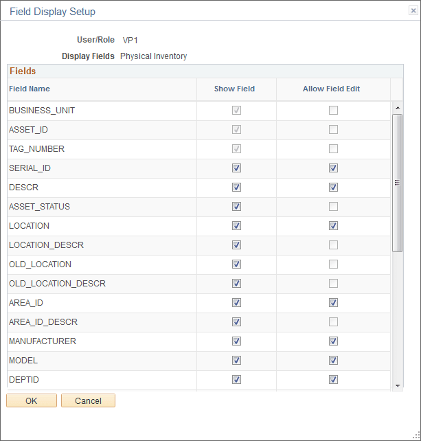

Field Display Setup Page
Use the Field Display Setup (PI_SCAN_OPT_FLD) page to configure individual field display and edit properties for the Fluid pages in the Asset Tracking homepage.
Navigation:
Setup Financials/Supply Chain, and then Product Related, and then Asset Management, and then Physical Inventory, and then Scan Options, and then Click the Field Display Setup icon on the Scan Options page.
Scan Options - Field Display Setup page
Physical Inventory Field Display Setup Scan By Location Field Display Setup Scan Asset Field Display Setup Find Asset Field Display Setup
The field display setup options for Physical Inventory include the Show Field and Allow Field Edit options.
The Allow Field Edit option is disabled for Business Unit, Asset ID, and Tag Number, and cannot be selected.
The field display setup options for Scan By Location include the Show Field and Allow Field Edit options.
The Allow Field Edit option is disabled for all fields except for Comment. Disabled fields cannot be selected.
The field display setup options for Scan Asset include the Show Field only.
The field display setup options for Find Asset include the Show Field only.

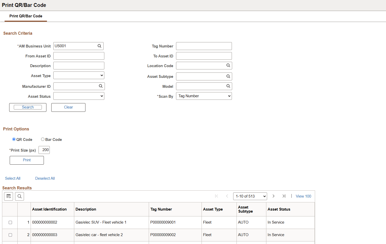

Print QR/Bar Code Page
Use the print QR/Bar Code (AM_PI_PRINT_QR_CD) page to generate asset tag in QR code or bar code formats that can be printed and affixed to an asset.
Navigation:
Asset Management, and then Physical Inventory, and then Print QR/Bar Code
This example illustrates the fields and controls on the Print QR/Bar Code page. You can find definitions for the fields and controls later on this page.
Print QR or Bar Code
This example illustrates a sample QR code generated.
Printed QR Code
This example illustrates a sample bar code generated.
Printed Bar Code
Use the search criteria to find and select the assets that need asset tags generated.
The Scan By field allows you to select the data type stored in to the QR or bar code. Select Tag number or Serial ID for asset tag printing.
Select Location from the Scan By field to store location in to the QR or bar code. When Location is selected, all other search fields are hidden except Business Unit and Location Code.
Choose the preferred asset tag format, QR Code or Bar Code from the Print Options.
Select Print to generate a PDF document containing asset tags for all selected assets or location tags.

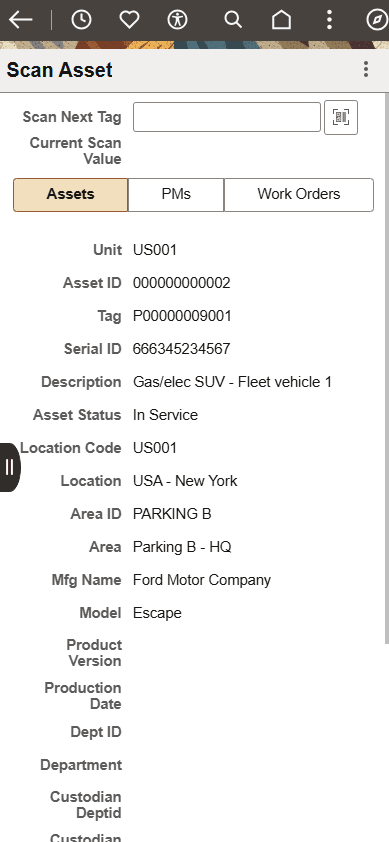

Scan Asset Page
Use the Scan Asset (PI_SCAN_ASSET_FL) page to retrieve general information, preventative maintenance schedules, and work orders associated with a scanned asset.
Navigation:
Fluid Home, and then Asset Tracking, and then Select the Scan Asset tile.
This example illustrates the fields and controls on the Scan Asset page - Assets.

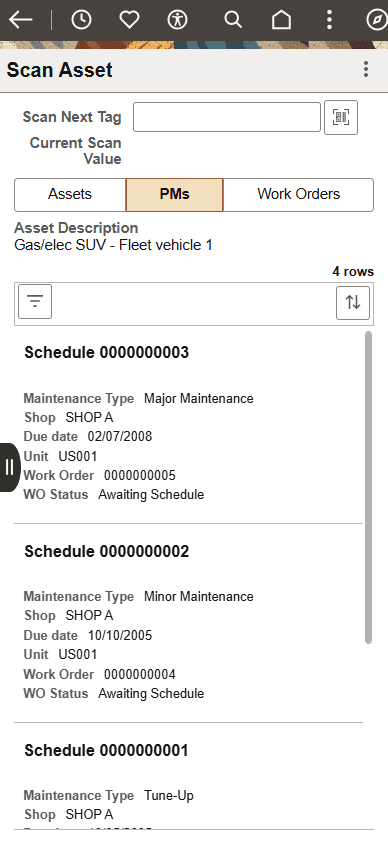

This example illustrates the fields and controls on the Scan Asset page - Preventative Maintenance.

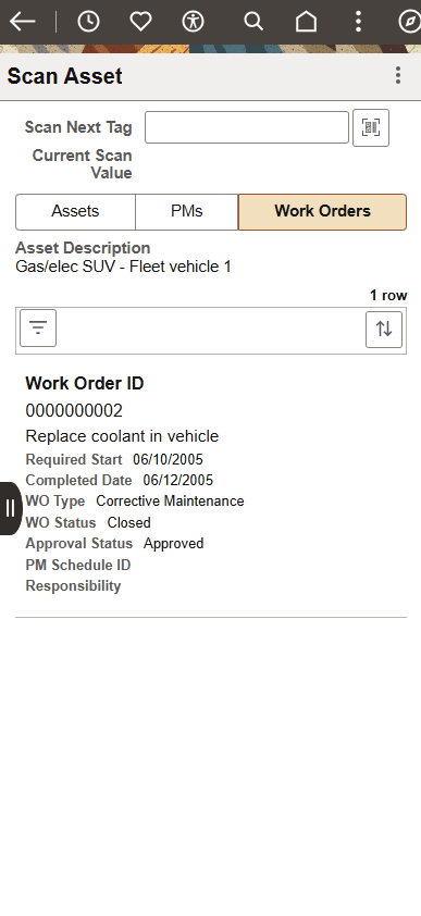

This example illustrates the fields and controls on the Scan Asset page - Work Orders.
Scan an asset barcode to retrieve general information, preventative maintenance schedules, and work orders associated with the asset. Asset information displayed on this page is retrieved from Asset Repository.
Select the Scan Icon Scan Icon to open the native camera of your device to scan the asset tag.
The user must sign in using SSL link on your mobile device to successfully scan an asset with the mobile device camera.
The scanner requires permission to access your device's camera in order to scan. You may be prompted to grant camera access.
The Scan By toggle switch is displayed based on the value entered in the Installation Options - Asset Management page. For details see Application Fundamentals: Setting Up Application-Specific Installation Options
Select the Assets tab to view general information about the asset. Hazardous assets, warranties, and asset hierarchies are indicated with icons when an asset has that attribute.
Select the PMs tab to view preventative maintenance schedules for the asset. Upcoming maintenance is indicated with an icon when an asset has that attribute.
Select the Work Orders tab to view work orders associated with the asset.
You cannot edit asset information on this page. If an asset does not have preventative maintenance or work orders associated with it, the related tabs are disabled.

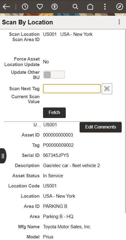

Scan By Location Page
Use the Scan By Location (PI_SCAN_LOC_FL) page to scan assets within a specific location and area ID to build an audit history for assets in that location.
Navigation:
Fluid Home, and then Asset Tracking, and then Select the Scan By Location tile.

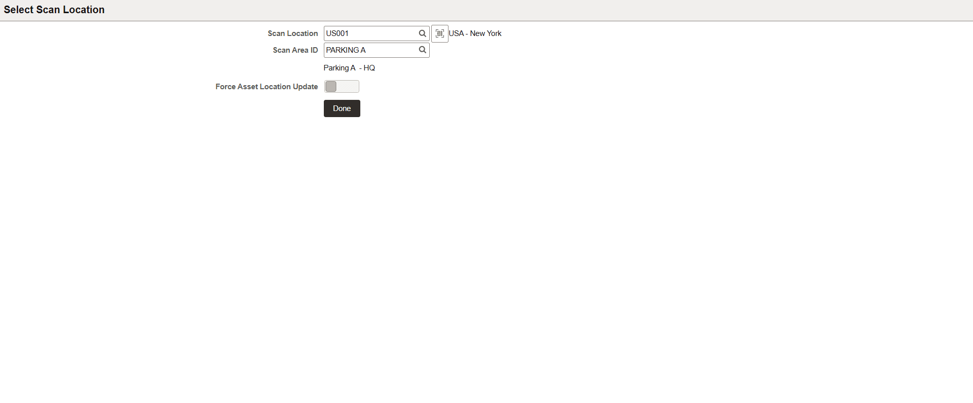

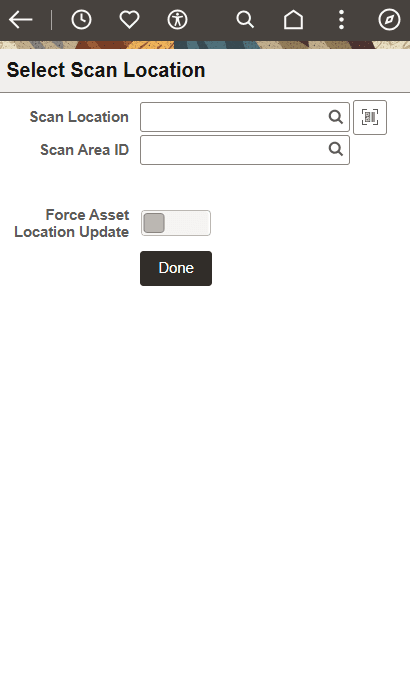

This example illustrates the fields and controls on the Select Scan Location page on a smartphone.
Select Scan Location page on Smartphone
This example illustrates the fields and controls on the Select Scan Location page. You can find definitions for the fields and controls later on this page.
Scan a location QR code or barcode to select location.
Select the Scan Icon Scan Icon to open the native camera of your device to scan the location tag.
When an asset’s location differs from the scan location, you can use the Force Asset Location Update toggle button to update the asset location and area ID. When set to ‘Yes,’ the system inserts an effective dated location and area ID record into the ASSET_LOCATION table. Location attributes are also stored in the PI_SCAN_HIST table. In addition, the system creates comments in the ASSET_COMMENTS table. The user can view the comments in the Basic Add Asset Comment page.
Select Done to retrieve a list of assets associated with the specific location and area ID.

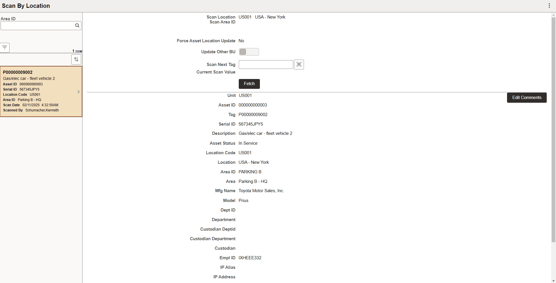

This example illustrates the fields and controls on the Scan By Location page on a smartphone.
Scan By Location page - Smartphone
This example illustrates the fields and controls on the Scan By Location Page. You can find definitions for the fields and controls later on this page.
Enter a valid tag number or use the Scan Icon Scan Icon to scan asset tag. The system displays the old and new location as well as the old and new area ID.

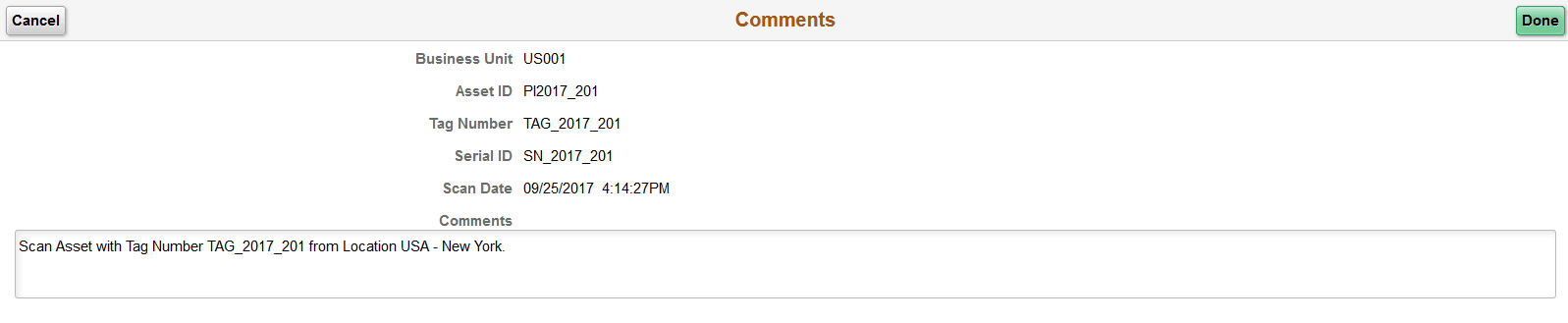

Select Edit Comments to edit comments for the asset.
This example illustrates the fields and controls on the Edit Comments. You can find definitions for the fields and controls later on this page.
Edit Comments Location Change
Make the required modifications to the comment displayed and save your changes.
You can view the new location, area ID, and asset comments on the Basic Add - Location/Comments/Attributes page.
For information about Basic Add - Location/Comments/Attributes page, see Location/Comments/Attributes Page.
Find Asset Page
Use the Find Asset (AM_FIND_ASSET_FL) page to retrieve information for assets without scanning a barcode.
Navigation:
Fluid Home, and then Asset Tracking, and then Select the Find Asset tile.
Find Asset page
FluidUI_AssetTracking_FindAssetTile
Enter search parameters, such as Business Unit,Asset ID, or Location, and select Search to retrieve information for scanned assets. Asset information displayed on this page is retrieved from the Asset Repository.

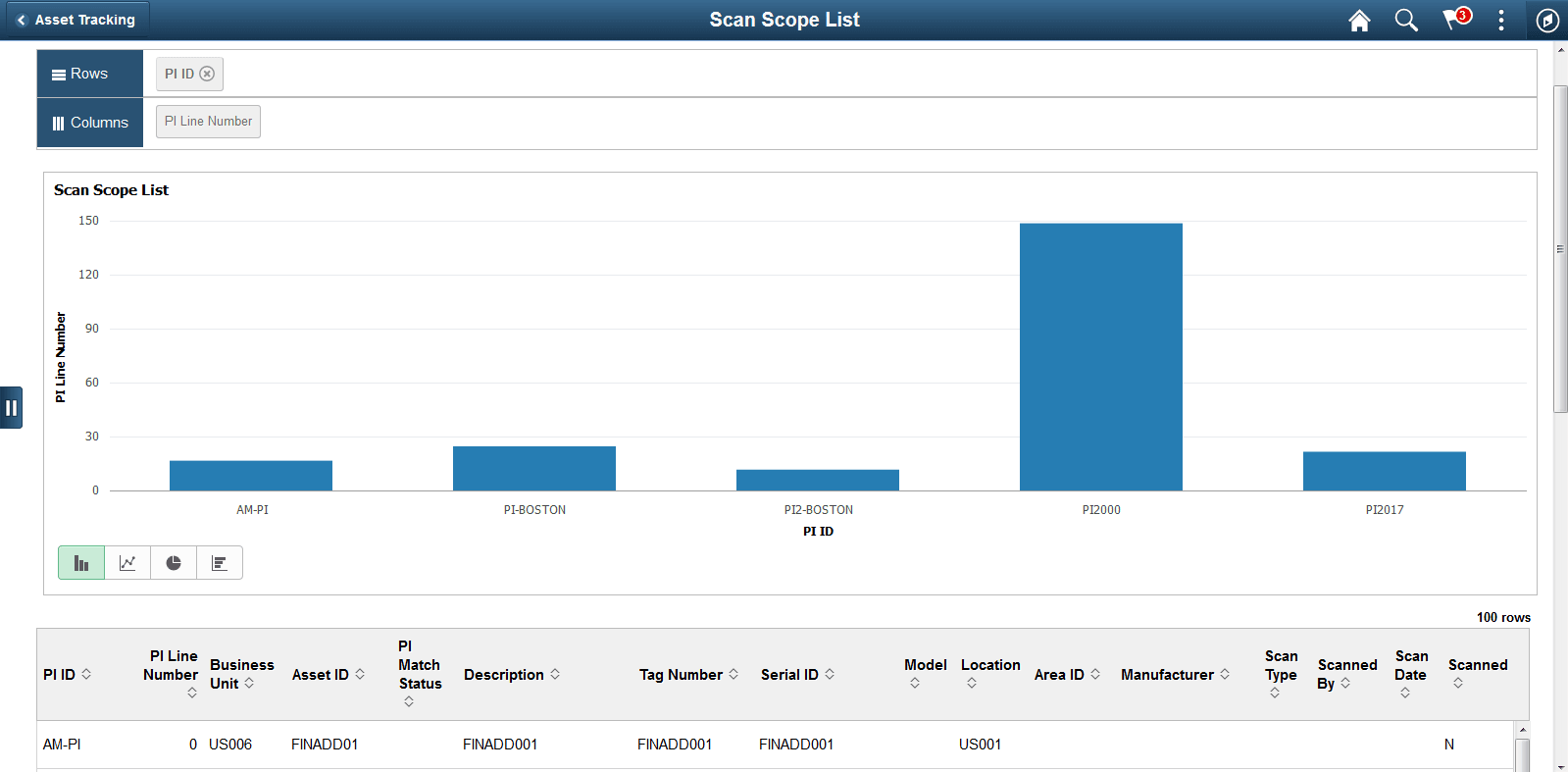

Scan Scope List Pivot Grid
Use the Scan Scope List pivot display to view the status of Physical Inventory IDs in progress and the list of assets scanned.
Navigation:
Select the Scan Scope List tile on the Asset Tracking Home page.
This example illustrates the fields and controls on the Scan Scope List Pivot Grid.

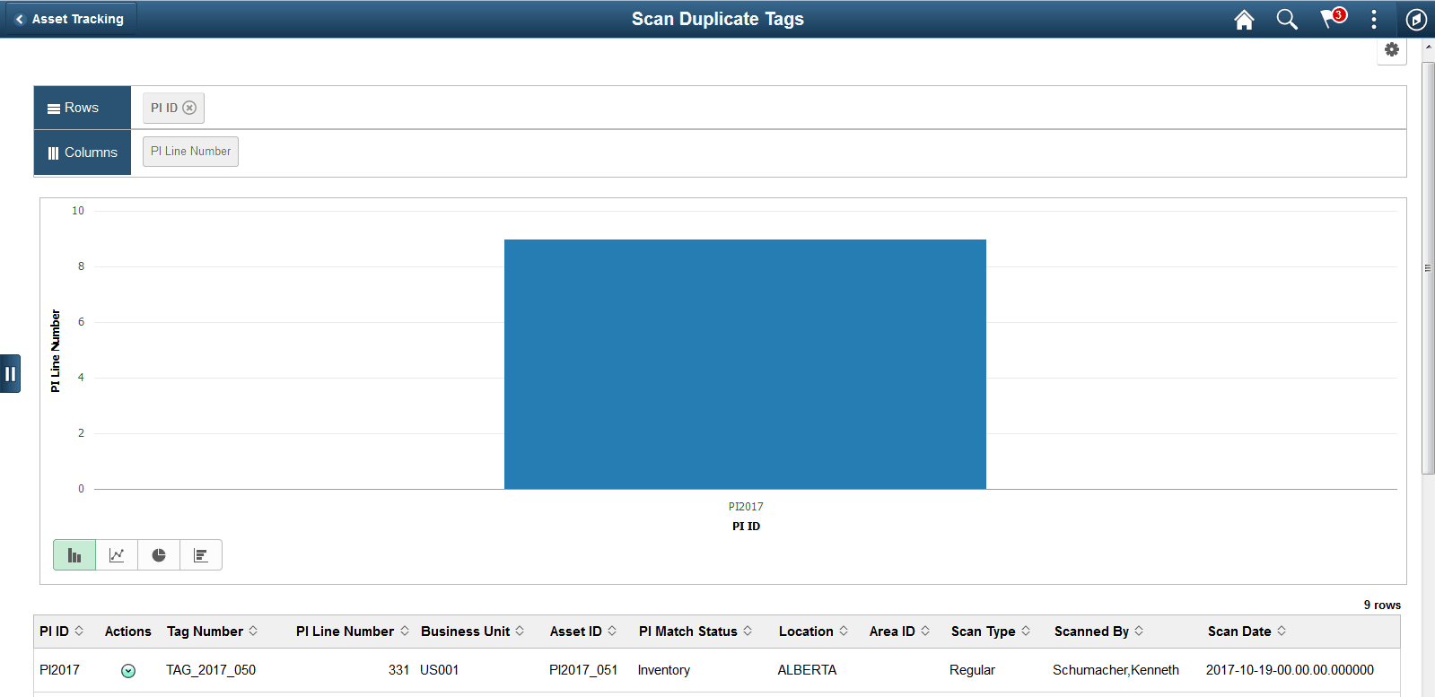

Scan Duplicate Tag Pivot Grid
Use the Scan Duplicate Tag pivot display to identify the assets with duplicate tags.
Navigation:
Select the Scan Duplicate Tag tile on the Asset Tracking Home page.
This example illustrates the fields and controls on the Scan Duplicate Tag pivot grid.
Scan Duplicate Tag Tile
Related actions iconRelated Actions Icon
Select this icon to navigate to the Verify Duplicate Tags page to verify duplicate tags. You can make changes to the tag number and save the changes.

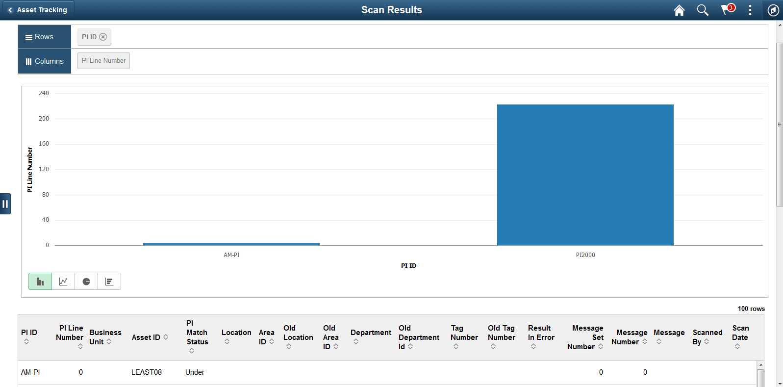

Scan Results Pivot Grid
Use the Scan Results pivot display to review the matching results and take the necessary actions.
Navigation:
Select the Scan Results tile on the Asset Tracking Home page.
This example illustrates the fields and controls on the Scan Results pivot grid.
Scan Results Pivot Tile
Select this icon to navigate to the Review Matching Results page and to review and make changes to the scan result.

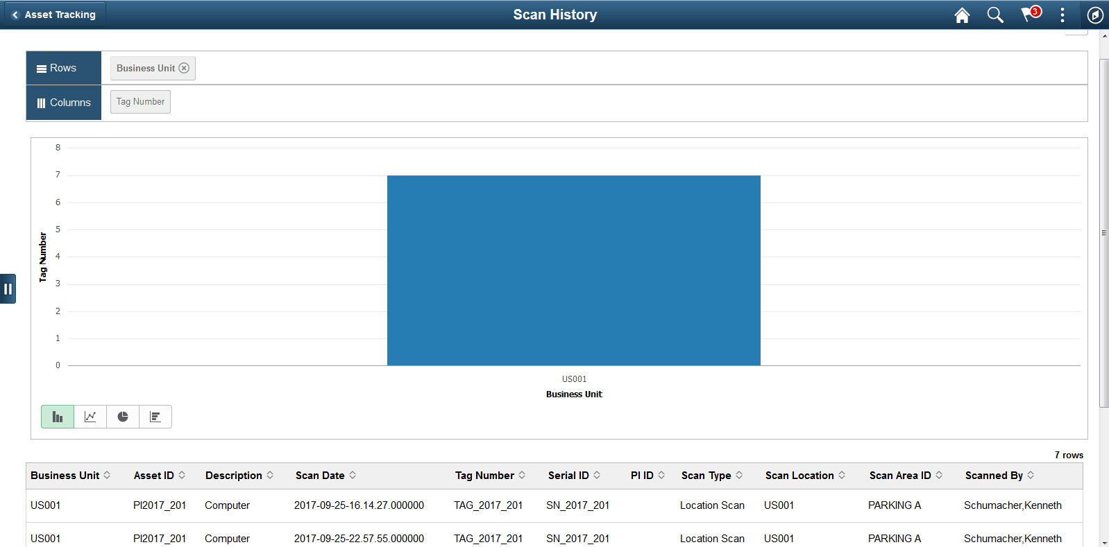

Scan History Pivot Grid
Use the Scan History pivot display to browse Scan History Audit trails.
Navigation:
Select the Scan History tile on the Asset Tracking Home page.
This example illustrates the fields and controls on the Scan History pivot grid.
Scan History Tile

Use the Asset Transactions page (AM_SS_ASSETS_FL) to perform asset physical transfer and asset retire transactions.
Navigation:
Fluid Home, and then Asset Tracking, and then Asset Transactions tile
This example illustrates the fields and controls on the Asset Transactions page. You can find definitions for the fields and controls later on this page.
Search Criteria
Enter the search criteria to perform manual search for assets, if an asset tag cannot be scanned. View the details and perform the transfer or retire transaction as required.
Edit icon
Select to configure the search criteria. The Edit option is available only in large form factor.
Scan Tag
Scan the tag number of the asset to view the details and perform the transaction.
Transfer
Select the Transfer button to navigate to the Asset Physical Transfer page. The page allows you to review the asset and transaction details, and modify the asset transfer location and custodian details if required.
Retire
Select the Retire button to navigate to the Asset Retire page to perform the asset retire transaction.

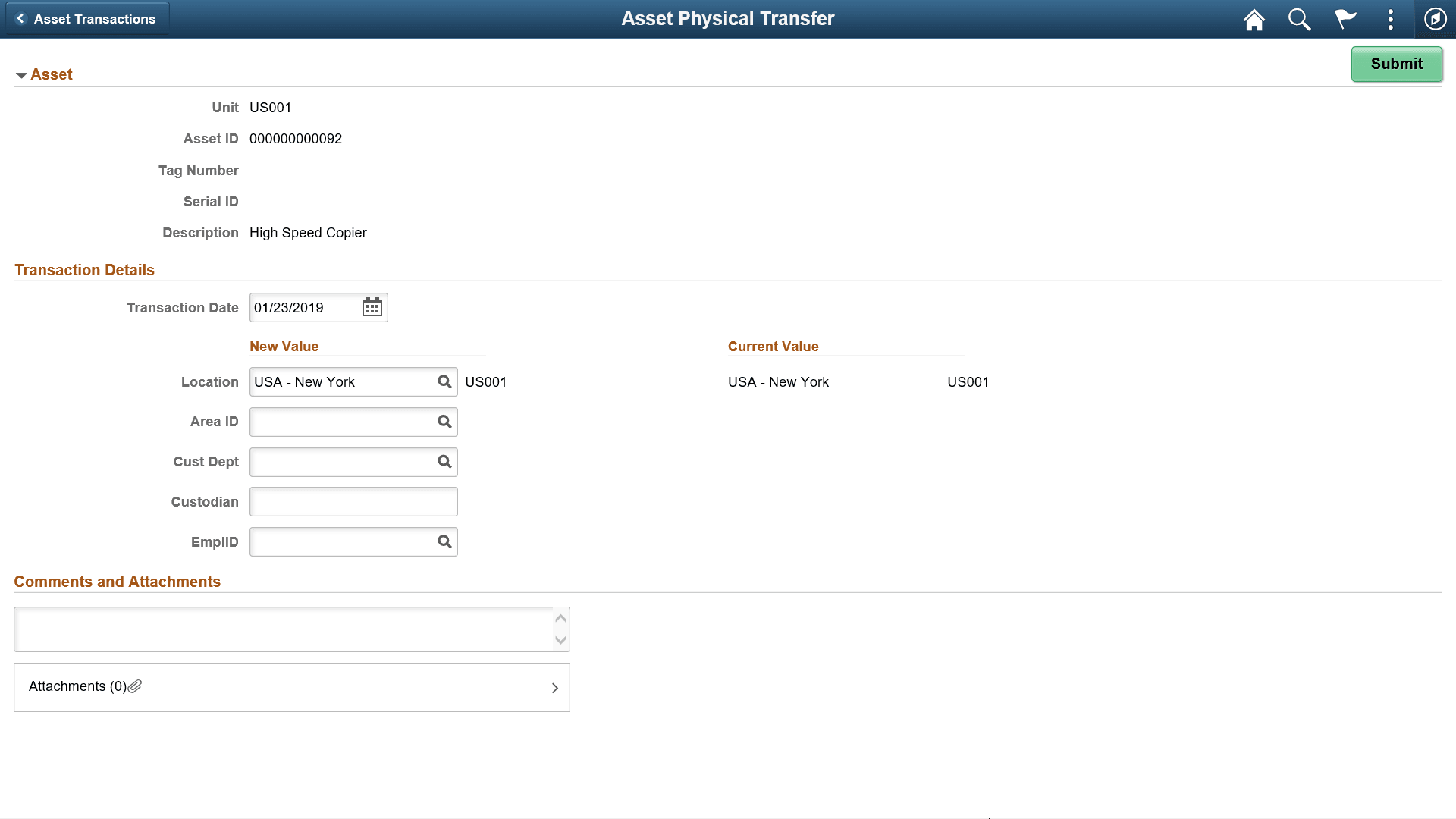

This example illustrates the fields and controls on the Asset Physical Transfer page. You can find definitions for the fields and controls later on this page.
New Value
Modify the existing field value or select new values.
Current Value
Displays the existing values for comparison purposes.
Comments and Attachments
Enter comments and add attachments about the transaction, if any.
Submit
Select the Submit button to proceed with the transaction.
During the Asset physical transfer approval process, the approvers can review the new values. After the final approval, the asset details display the new values.
See Pending Approvals - Asset Physical Transfer page.
This example illustrates the fields and controls on the Asset Retire page. You can find definitions for the fields and controls later on this page.
Asset Retire page
Review the details and modify them if required, and submit for approval. After final approval for Asset Retire transaction, you need to run the transaction loader to update the asset transaction tables.
See Load into AM Page.
