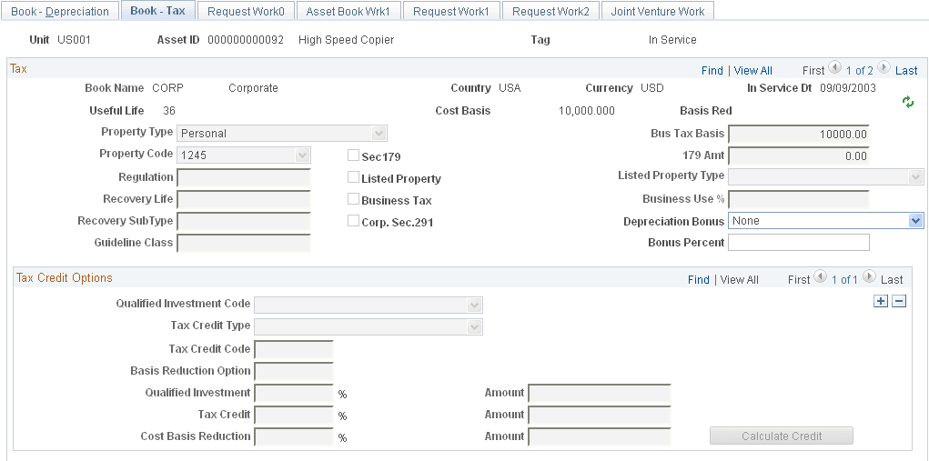

Book - Tax Page
ASSET_BOOK_02
Specify property type, tax depreciation criteria, and tax credit options. If the fields on this page are not available, the book was not set up as a tax book on the Business Unit/Book Definition page.

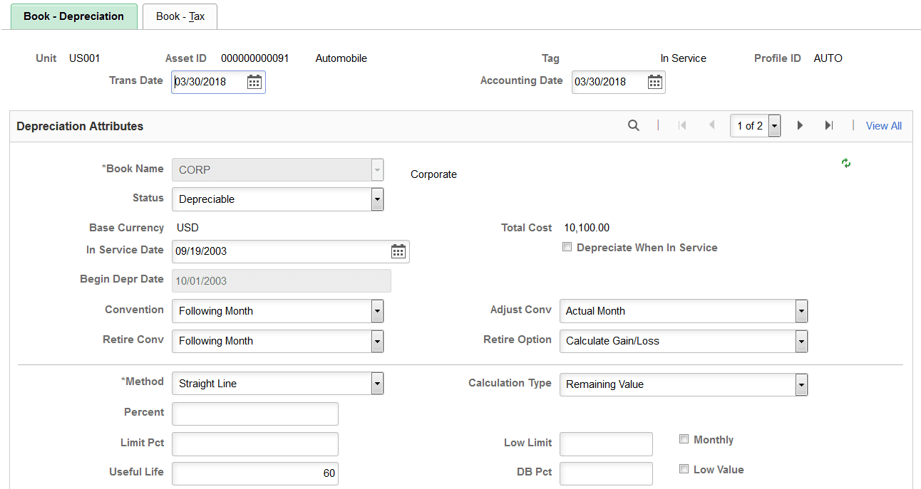

Use the Book - Depreciation page (ASSET_BOOK_01) to identify the asset's books and some of the information needed for calculating depreciation.
An asset can be linked to any number of books. Typically, separate books are required for financial and tax purposes.
Navigation:
Asset Management, and then Asset Transactions, and then Asset Book Information, and then Define Tax/Depr Criteria
This example illustrates the fields and controls on the Book - Depreciation page. You can find definitions for the fields and controls later on this page.
Book - Depreciation page (1 of 2)

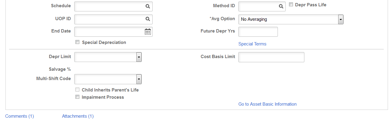

Book - Depreciation page (2 of 2)
Field or Control Description
In Service Date
Enter the date that the asset was made available for use from a financial standpoint. This date and the depreciation convention determine when depreciation starts for this book. This date is reflected in the Begin Depr Date field.
Depreciate When In Service
Select to allocate annual depreciation as of the date that you placed the asset in service. If you do not select this option, PeopleSoft Asset Management allocates annual distribution as of the date determined by the depreciation convention. This option is valid only in the year that the asset was acquired.
Convention
Enter the convention that the system uses to prorate depreciation for the asset. Asset Management is delivered with most standard depreciation conventions set up in the Depreciation Conventions table. The system derives the beginning depreciation date from the convention and the placed-in-service date. For example, if you began using an asset on May 3, 2006, and selected Actual Month as the depreciation convention, PeopleSoft Asset Management would begin depreciating this asset on May 1, 2006. If you selected Following Month as the convention, depreciation would begin on June 1, 2006.
Adjust Convention
Enter the adjustment convention that the system uses to prorate cost adjustments for the asset.
Retirement Convention
Enter the retirement convention that the system uses to prorate retirement for the asset.
Retire Option
Select the retirement calculation option to be processed for assets within a given book. These retirement options are available at the profile, book and asset levels.
See Retire Assets Page.
Select a depreciation method in the Depreciation Method field. Some depreciation methods require you to enter additional information. Depending on the method that you select, additional fields will display as needed, and as described in the following table:

The following table defines the additional fields:
Limit Pct (limit percent)
Enter to specify a limit for depreciation as a percentage of cost.
UOP ID (units of production ID)
Enter the units-of -production ID, production information, and transaction information to use for the asset.
DB Pct (declining balance percent)
Enter the percentage of declining balance depreciation to be taken each year until the amount calculated by the straight line method is greater.
Percent
Enter the percentage of original basis to be taken in depreciation each year.
Low Limit
Enter an amount. When the asset basis reaches this limit, the remaining basis is taken in depreciation and the asset is fully reserved. Low limit is specific to group assets and flat rate.
Depr Pass Life (depreciate past useful life)
Select this if you want to continue to depreciate this asset past its useful life. This option is used for certain countries' governmental regulations and in utilities industries to depreciate an asset to the end of a depreciation calendar.
Method ID
Enter the user-defined method to use.
Schedule
Enter a schedule to use for depreciation.
Avg Option (average option)
Generally, this field is used by utility companies to depreciate composite assets. The averaging options are expressly designed to work with the flat rate depreciation method.

This example illustrates the fields and controls on the Book - Tax page. You can find definitions for the fields and controls later on this page.
Book - Tax page
