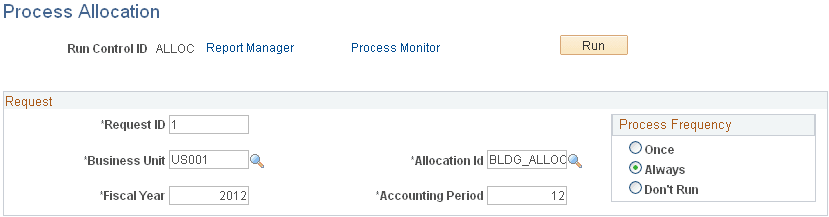

This example illustrates the fields and controls on the Process Allocation page. You can find definitions for the fields and controls later on this page.
Enter a Business Unit, Allocation Id, and Accounting Period to process allocations. Select a Process Frequency.
