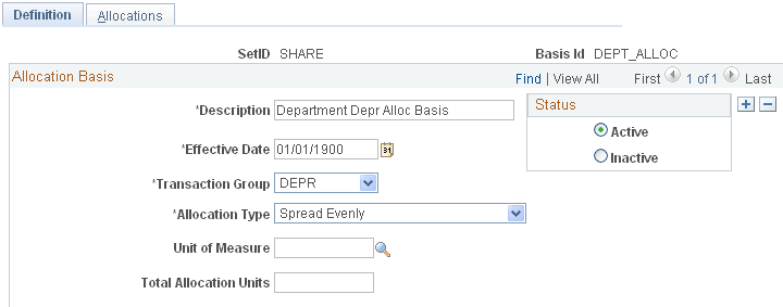

Allocation Basis Definition - Definition Page
Use the Allocation Basis Definition - Definition page (ALLOC_BASIS_PNL) to define basic information for your allocation basis.
Navigation:
Set Up Financials/Supply Chain, and then Product Related, and then Asset Management, and then Accounting, and then Asset Allocation Basis Defn
This example illustrates the fields and controls on the Allocation Basis - Definition page. You can find definitions for the fields and controls later on this page.
Field or Control Description
Transaction Group
Select a transaction group which combines depreciation types for allocating expenses. In the case of using budget or fund accounting, select the transaction group that is used for budget or fund reallocations.
Allocation Type
Select one:
  • Copy: Select to override a value so that ownership can be assigned (for example, to one department while expense is charged to another department).
  • Evenly: Select to distribute the Total Allocation Units equally among the allocation destinations.
  • Prorata: Select to distribute the Total Allocation Units in the way you specify in the Destination group box on the Allocation Basis Definition - Allocations page.
    Note: If you select Prorata as the allocation type, enter a Unit of Measure and the number of Total Allocation Units.
Unit of Measure
If you select Prorata as the allocation type, enter a unit of measure. This is the criteria you are going to use to do the allocation.
The total quantity of your units of measure that are used to perform the allocation. You enter the allocation units for each destination to establish the allocation ratio for each destination.

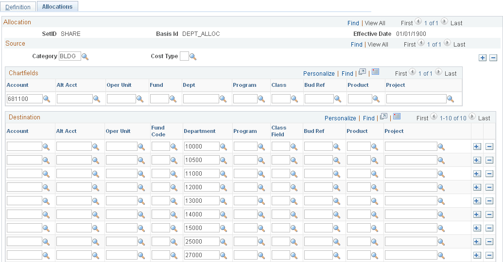

Allocation Basis Definition - Allocations Page
Use the Allocation Basis Definition - Allocations page (ALLOC_BASIS1_PNL) to specify the sources and destinations for the allocation.
Navigation:
Set Up Financials/Supply Chain, and then Product Related, and then Asset Management, and then Accounting, and then Allocation Basis Definition, and then Allocations
This example illustrates the fields and controls on the Allocation Basis Allocations page. You can find definitions for the fields and controls later on this page.
Complete the applicable ChartField sources and destinations.
If you are using a prorata allocation, enter the Allocation Units for each destination in the Destination group box.

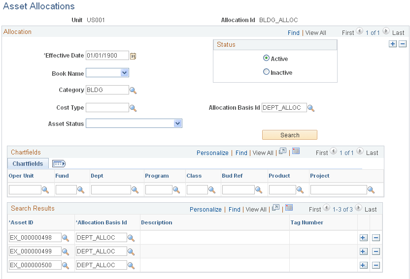

Asset Allocations Page
Use the Asset Allocations page (ALLOC_DEFN_PNL) to associate assets with Allocation Basis IDs.
Navigation:
Asset Management, and then Accounting Entries, and then Allocate Depreciation Expense, and then Asset Allocations
This example illustrates the fields and controls on the Asset Allocations page. You can find definitions for the fields and controls later on this page.
Specify the criteria for your allocation and click the Search button to retrieve the resulting assets:
The system might not display all ChartFields. The available ChartFields are dependent upon the definitions that you have created during implementation.
You can modify an asset allocation in one of two ways:
  • Modify an existing asset allocation (same effective date) using Correction mode. You can also add assets to your list that do not meet the search criteria.
  • Add a new effective-dated row for the asset allocation.
Search
For a new effective-dated asset allocation, click the Search button to retrieve all of the assets that match your criteria. If you are adding assets to your results that do not match your criteria, make sure that you save your allocation so that you don't lose those assets that you manually added.
For an existing effective-dated asset allocation, click the Search button to retrieve any additional assets that match your criteria. Your existing assets will not be removed; only any new assets matching the criteria will be added to your existing list.
Cost Type
Select the Cost Type to further narrow your search results.
Allocation Basis Id
Enter the Allocation Basis ID for this allocation; this is the default basis for this allocation.
Note: Use the upper Allocation Basis Id field to quickly establish the allocation basis value by default to each one of the selected asset IDs. Entering a value in the Allocation Basis Idfield in this portion of the page doesnot narrow your search.
Within the group box on the page, you can also associate each Asset ID with an Allocation Basis Id .
When using budget or fund accounting, define the assets against which allocations should be run. For example, include all assets that pertain to the budget reference year 2001. After running the accounting entry generation process (AM_AMAEDIST) and the depreciation close (AM_DPCLOSE) process, the Depreciation Allocation (AMALLOC) process with the appropriate budget Allocation ID can be run for the applicable fiscal year and period.
