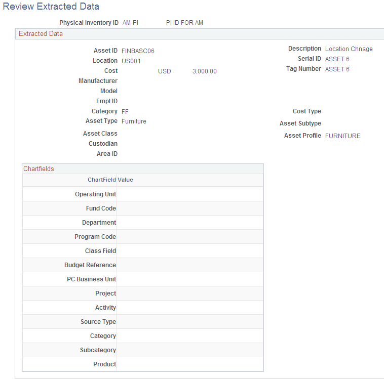

Review Extracted Data Page (Classic Physical Inventory Only)
PI_EXTRACT_01
(Optional)) View the results of the extract data one asset at a time. You can also search by PI line number, asset ID, department, tag number, serial ID, and location. The PI line number reflects the number of this asset in the extract sequence. For instance, the third asset that was extracted falls on PI Line Number 3. The system presents you with all the assets that match your criteria. Select the one you want to view.
You can run the report AMPI2000 to list all the information that has been extracted. Run this from the Physical Inventory Reports page.

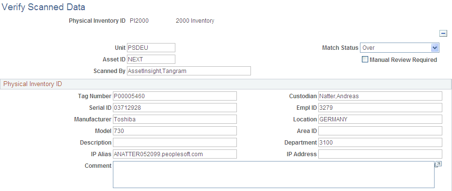

Verify Scanned Data Page
PI_SCAN_01
PI_SCAN (component)
Verify scanned data for the Physical Inventory ID.

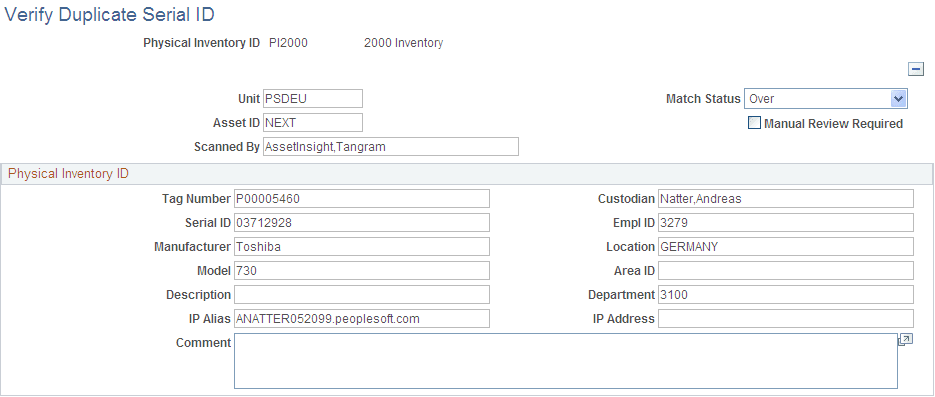

Verify Duplicate Tags Page
PI_SCAN_01
PI_SCAN_DUP_TAG is the component
Conduct searches for finding and correcting physical inventory data.
Verify Duplicate Serial ID Page
PI_SCAN_01
PI_SCAN_DUP is the component

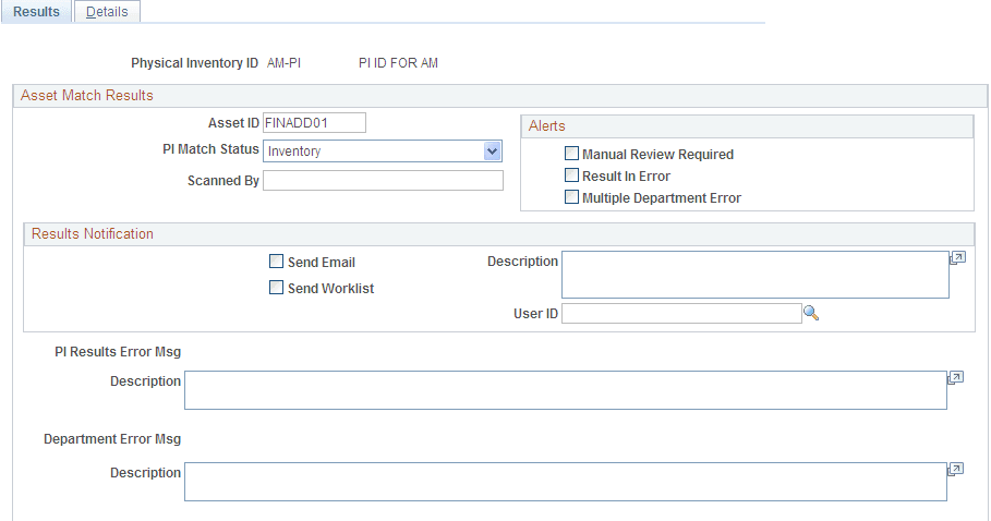

Results Page
PI_RESULTS_01
View the results of the matching process.

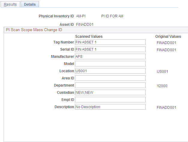

Review Matching Results - Details
PI_RESULTS_02
View the original and scanned data.

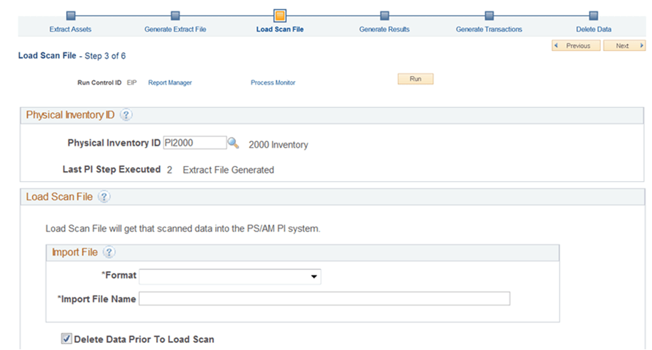

In order to process physical inventory, you must execute each step in its proper order. The Load/Match/Reconcile PI Info page includes each step in the proper order and prominently displays the step that was last processed for a given physical inventory ID
Because steps 2 and 3 of Load/Match/Reconcile PI require writing and reading files, you should run the AM_PIJOB, which consists of the AMPI1000 SQR program and AM_PIWS_RUN Application Engine program that are executed in parallel for these steps from the file location. For example, if you are writing and reading files from c:\temp\file.txt or c:\temp\scan.dat, you would run the process on the client. If you are writing and reading files from a directory on the PeopleSoft Internet Architecture server, run the process on that server.

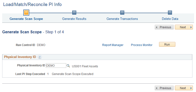

Generate Scan Scope (Step 1)
After defining scan scope parameters you can run step 1 of the Load/Match/Reconcile PI process.
Load/Match/Reconcile PI Info - Generate Scan Scope page
Load/Match/Reconcile PI Info page (Mobile Physical Inventory)
Click the Run button to run the Generate Scan Scope process. This process automatically defines a set of assets that should be scanned and provides that list to the Physical Inventory page, which is accessible from your mobile scanning device.

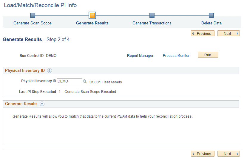

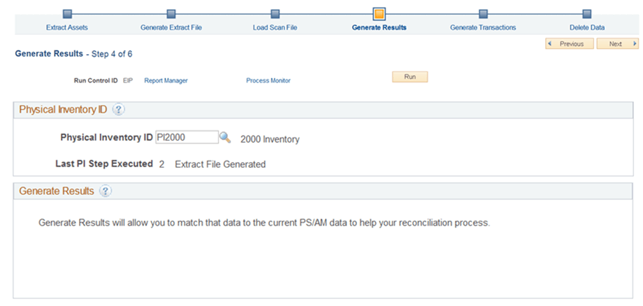

Generate Results (Step 2)
After scanning barcodes in combination with the Physical Inventory tile (which inserts scanned records into the PI_SCAN table), review the scanned data before running step 2 (generate results).
Step 2 performs matching between a physical inventory scan scope and scanned data, and creates physical inventory results for review.
Load/Match/Reconcile PI Info - Generate Results page
Load/Match/Reconcile PI Info - Generate Results page (Mobile Physical Inventory)
Remember before you generate results, you should use the Verify Duplicate Tags page and Verify Duplicate Serial ID page to clean up any possible errors in the scanned data.
Generate Results Select the Generate Results option and click the Run button to initiate processing. Note that this step may take some time to complete due to the amount of information that must be processed.
Because this step involves some complex processing, you may want to have your database administrator optimize the database before you execute the step.

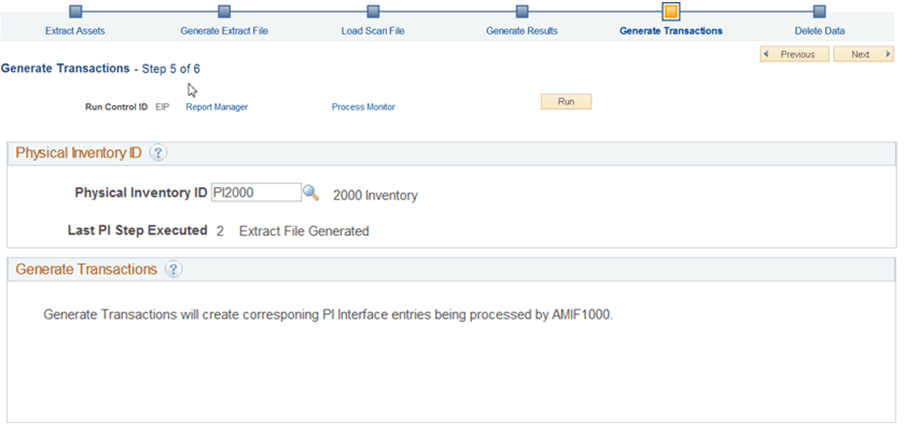

Generate Transactions (Step 3)
After matching is performed, you create physical inventory transactions that reconcile the data in Asset Management with the results of the physical inventory.
Load/Match/Reconcile PI Info - Generate Transactions page
Load/Match/Reconcile PI Info - Generate Transactions page (Mobile Physical Inventory)
Select the Generate Transactions step and click the Run button to begin generating the transactions.
Because this step involves some complex processing, you may want to have the database administrator optimize the database before you run it.
This step takes the longest time to process, so be sure that you are satisfied with the generated results before you load the transactions. You can see the results of the matching process by reviewing the Results page and the Results Detail page.

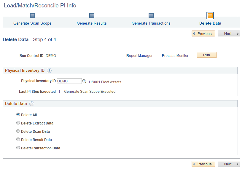

Delete Data (Step 4)
When you no longer need your physical inventory data, select one of the following options and click the Run button.
Load/Match/Reconcile PI Info - Delete Data page
Load/Match/Reconcile PI Info - Delete Data page (Mobile Physical Inventory)

Delete All
Select to delete all physical inventory data generated for the specified Physical Inventory ID: (Scan Data, Result Data, and Transaction Data).
Delete Scan Data
Select to delete the physical inventory scan data.
Delete Result Data
Select to delete the physical inventory results data.
Delete Transaction Data
Select to delete the physical inventory transaction data.
Upon successfully completing all the steps, the system will advance the navigator to the next step. The user can click the Run button to submit the process.

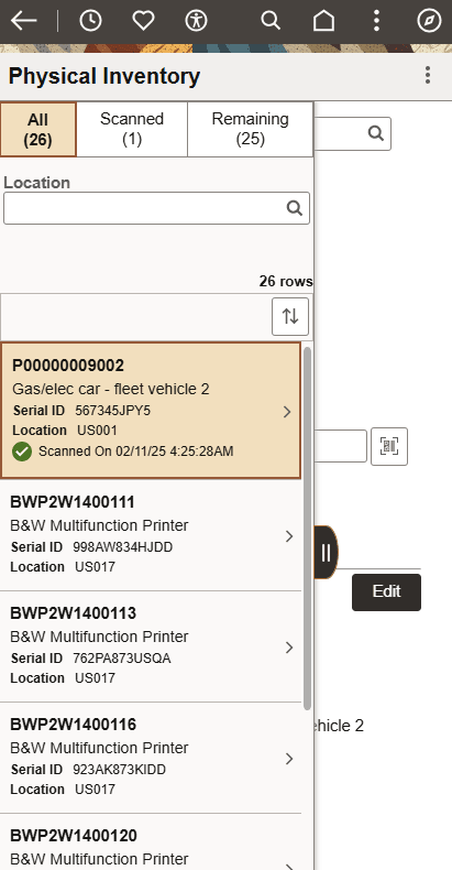

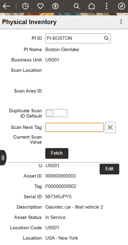

Physical Inventory Page
Use the Physical Inventory (PI_SCAN_PHY_FL) page to perform mobile physical inventory, scan assets, retrieve and display asset information from the Asset Repository, and automatically populate the Physical Inventory (PI_SCAN) and Scan History (PI_SCAN_HIST) tables with scan records.
Navigation:
Fluid Home, and then Asset Tracking, and then Select the Physical Inventory tile
This example illustrates the fields and controls on the Physical Inventory page - Scan Scope. You can find definitions for the fields and controls later on this page.
Physical Inventory page-Search result
This example illustrates the fields and controls on the Physical Inventory page - detail.
When you begin physical inventory, the asset inventory list displays on the left side of the page. You can filter the list by all assets (all assets in scan scope, plus scanned assets not in the scan scope), scanned assets, and remaining assets (assets not yet scanned). You can also use the Grid Sort icon to sort list results by Tag Number, Description, Serial ID, Location, or Scan Date.
The View By toggle switch determines whether to display the Tag or the Serial Id as the primary/secondary data in the grid. The View By toggle switch is available only when the Scan By field option is Tag Number or Serial ID. For details see Application Fundamentals: Setting Up Application-Specific Installation Options
The asset inventory list displays when you select the Show Inventory List option on the Scan Options page. If you do not enable this option, the asset inventory list is hidden from the page.
Scan an asset barcode to perform physical inventory and populate the Physical Inventory (PI_SCAN) and Scan History (PI_SCAN_HIST) tables with scan records.
Use the Scan Icon Scan Icon to open the native camera of your device to scan the asset tag.
The user must sign in using SSL link on your mobile device to successfully scan an asset with the mobile device camera.
The scanner requires permission to access your device's camera in order to scan. You may be prompted to grant camera access.
From here you can access related physical inventory pages that enable you to edit asset information, manually add a scan record for a new asset, and manually add a scan record.
The Scan By toggle switch is displayed based on the value entered in the Installation Options - Asset Management page. For details see Application Fundamentals: Setting Up Application-Specific Installation Options
Select the Edit button to access the Edit Scan Record page and edit scanned asset information.
Select New Asset from the Actions List menu to access the New Asset Scan Record page and add a new scanned asset to the PI_SCAN table.
Select Find Asset from the Actions List menu to access the Find Asset page and manually create a scan record for an asset without scanning a barcode.

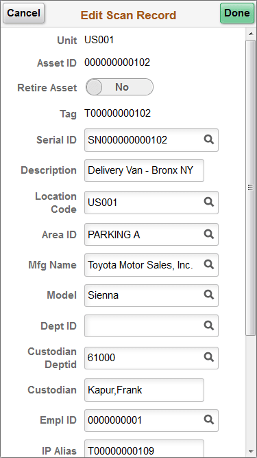

Edit Scan Record Page
Use the Edit Scan Record (PI_SCAN_EDIT_SCF) page to modify scanned asset information.
Navigation:
Fluid Home, and then Asset Tracking, and then Select the Physical Inventory tile, and then Select the Edit button on the Physical Inventory tile.
FluidUI_AssetTracking_PhysicalInventoryTile_EditScanRecord
You can use the Edit Scan Record page to modify scanned asset information. If this is a new asset you can edit all fields on this page. If this is an existing asset you cannot edit Business Unit, Asset ID, and Tag.
Use the Retire Asset toggle to retire the scanned asset. This field is functional when you select the Allow Retirements option on the Scan Options page. If you do not enable this option, you cannot use the Retire Asset toggle.
Select Done to save your changes.

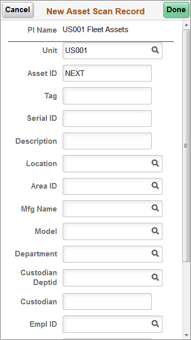

New Asset Scan Record Page
Use the New Asset Scan Record (PI_SCAN_NEW_SCF) page to manually add a new scanned asset to the Physical Inventory (PI_SCAN) interface table.
Navigation:
Fluid Home, and then Asset Tracking, and then Select the Physical Inventory tile, and then Select New Asset Scan Record from the Actions List menu.
FluidUI_AssetTracking_PhysicalInventoryTile_ActionsList_NewAsset

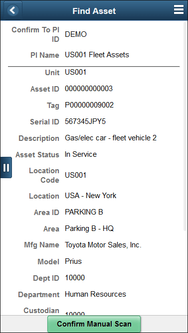

Find Asset Page
Use the Find Asset (PI_SCAN_FIND_FL) page to manually create a scan record for an asset without scanning a barcode.
Navigation:
Fluid Home, and then Asset Tracking, and then Select the Physical Inventory tile, and then Select Find Asset from the Actions List menu.
Find Asset page
FluidUI_AssetTracking_PhysicalInventoryTile_ActionsList_FindAsset
When you are unable to scan a barcode while performing physical inventory, you can use the Find Asset page to manually create a scan record for an asset without scanning a barcode.
Simply enter search parameters, such as Business Unit and Asset ID, and select Search to retrieve asset information from the Asset Repository. Asset information is displayed in a list on the left side of the page.
Use the list to select an asset you want to manually create a scan record for, and select Confirm Manual Scan to complete the process. Similar to scanning an asset, selecting Confirm Manual Scan populates the Physical Inventory (PI_SCAN) and Scan History (PI_SCAN_HIST) tables with the scan record.

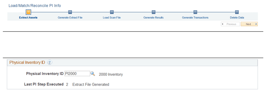

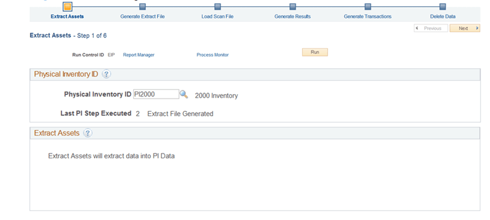

Extract Assets (Step 1)
Select this physical inventory option to extract asset data and click the Run button to process the step.
This example illustrates the fields and controls on the Extract Assets Page. You can find definitions for the fields and controls later on this page.
Extract Assets Page
This step executes the actual data extract from PeopleSoft Asset Management. When you extract data, you do not need to enter a file name or file type. The data is saved in a relational table called PI_EXTRACT. If you want to view the extract data before using it in subsequent steps, see Review Extracted Data Page (Classic Physical Inventory Only).

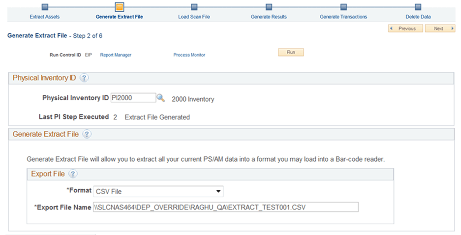

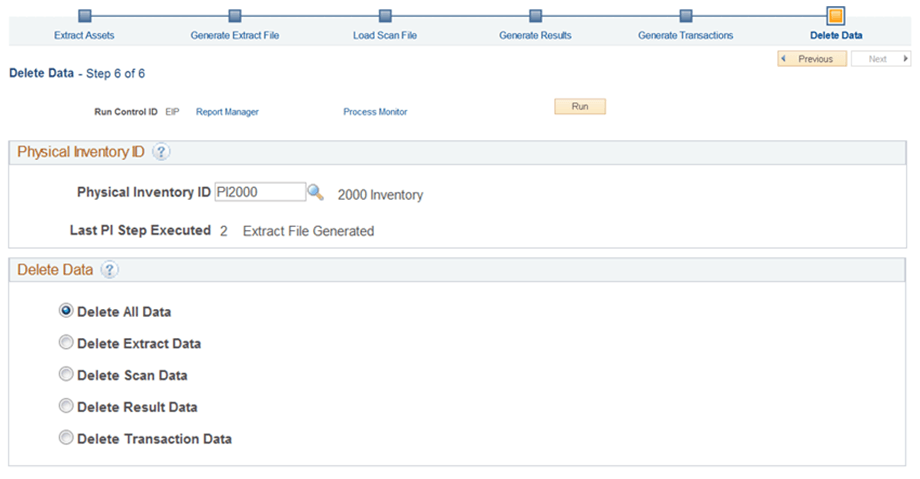

Generate Extract Export File (Step 2)
Select this step to create an output file from the extract data. When you select this option, you must select an export file format and supply a file name:
This example illustrates the fields and controls on the Generate Extract File Page. You can find definitions for the fields and controls later on this page.
Field or Control Description
Export File
CSV File - Select CSV File for a comma-separated values (CSV) file.
Scanner File - Select Scanner File as the export file type, and enter a file name (as well as any additional path information) for the file that you want to generate. The output file is formatted for loading into a bar code scanning device in preparation for performing physical inventory.
Generate Labels - To create a file for printing labels rather than performing inventory, select Generate Labels as the export file type. A label file is created for the printer in a different format from the one used for a scanning device.
To generate files for both a scanning device and a printer, perform step 2 twice with a different output file type each time.
Web Service - Select Web Service to use the Integration Broker web service option to load the physical inventory data. This happens without any input or initiation. As soon as an inbound XML message is received from the third party vendor, the associated handler loads the scanned data.
Note: When using the web service option, remember to supply the file size for chunking on the Asset Management Installation Options page. This specifies the chunk size for the message GET_PIDATA.
See Application Fundamentals: Setting Up Application-Specific Installation Options
The EXTCOPY.BAT file is configured to copy the extract file to the A:\ drive for demonstration or quick overview purposes. You need to modify EXTCOPY.BAT if you want to copy the extract file to the appropriate drive on a scanner.

Load Scan Import File (Step 3)
After completing the physical inventory with the scanning system, download the scanner data into a workstation or network server so that it can be converted back into a PeopleSoft Asset Management table called PI_SCAN. You do this using a communications software package or by using the certified integration solution provided by various software vendors. Consult the bar code scanning device manual or software supplier for more information.
This example illustrates the fields and controls on the Load Scan Import File. You can find definitions for the fields and controls later on this page.
Load Scan File Page
PeopleSoft Asset Management provides an unsupported file called SCANCOPY.BAT (found in the \PI directory) that can be edited to copy the SCAN.DAT file from the scanner to the computer. You may need to modify the copy statement in SCANCOPY.BAT so that it copies from the drive letter corresponding to the scanner's drive. This is similar to the modification that you may need to make to EXTCOPY.BAT.
Once the scanner files are available to load into Asset Management, you can run step 3 of the physical inventory process.
Enter the directory and file name of the inventory file. This is most likely \TEMP\SCAN.DAT. If located on the PeopleSoft Internet Architecture server, you can run the next process on the server.
Select the Load Scan Import File option and click the Run button to load the scan data into PeopleSoft Asset Management. You can load as many files as you need by renaming SCAN.DAT (during the bar code scanning process) with unique file names and loading each file separately.
If you have written your own scanning program or modified PI.BAS to configure fields or field lengths, you need to update the file formats in AMPI1000.SQC to match.
Once you have completed this step, review scanned data, find any duplicate tags, and verify that there are no duplicate serial IDs.

Generate Results (Step 4)
After the inventory data is loaded into Asset Management and you have reviewed it, correcting any duplicates or errors, you can run step 4. ,This step performs matching between a physical inventory scan scope and scanned data and creates physical inventory results for review.
This example illustrates the fields and controls on the Generate Results . You can find definitions for the fields and controls later on this page.
Generate Results Page
Generate Results
Generate Physical Inventory Transactions (Step 5)
Select the Generate Transactions and click the Run button to begin generating the transactions.
This example illustrates the fields and controls on the Generate Physical Inventory Transactions. You can find definitions for the fields and controls later on this page.
This step takes the longest time to process, so be sure that you are satisfied with the generated results before you load the transactions. You can see the results of the matching process by reviewing the Results page and the Results Detail page. See Results Page.

Delete Physical Inventory Data (Step 6)
This example illustrates the fields and controls on the Delete Physical Inventory Data. You can find definitions for the fields and controls later on this page.
Delete All
Select to delete all physical inventory data generated for the specified Physical Inventory ID: (Extract Data, Scan Data, Result Data, and Transaction Data.
Delete Extract Data
Select to delete the Physical Inventory extract file.
Delete Scan Data
Delete Result Data
Upon successfully completing all the steps, the system will advance the navigator to the next step. The user can click the Run Button to submit the process.

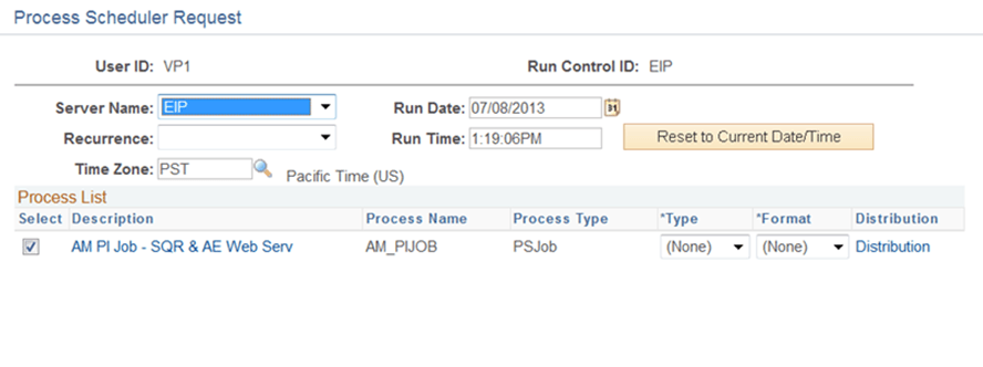

This example illustrates the fields and controls on the Process Scheduler Request Page. You can find definitions for the fields and controls later on this page.
Process Scheduler Request page
Use the Review Extracted Data page (PI_EXTRACT_01) to view the results of the extract data one asset at a time. This step is optional.
Navigation:
Asset Management, and then Physical Inventory, and then Review Extracted Data, and then Review Extracted Data
This example illustrates the fields and controls on the Review Extracted Data page. You can find definitions for the fields and controls later on this page.
View the extract data one asset at a time. You can search by Physical Inventory ID, PI line number, asset ID, , tag number, and location code. The PI line number reflects the number of this asset in the extract sequence. For instance, the third asset that was extracted falls on PI Line Number 3. The system presents you with all the assets that match your criteria. Select the one you want to view.
Use the Verify Duplicate Serial ID (identification) page (PI_SCAN_DUP) to conduct searches for finding and correcting physical inventory data.
Navigation:
Asset Management, and then Physical Inventory, and then Verify Duplicate Serial ID
This example illustrates the fields and controls on the Verify Duplicate Serial ID page. You can find definitions for the fields and controls later on this page.
The Duplicate Serial Number page is similar to the Duplicate Tags page except that you are reviewing created records that have a duplicate Serial ID number.
Identification of duplicate serial IDs within the same physical inventory ID.
Use the Verify Scanned Data page to review the scanned data.
Navigation:
Asset Management, and then Physical Inventory, and then Verify Scanned Data, and then Verify Scanned Data
This example illustrates the fields and controls on the Verify Scanned Data page. You can find definitions for the fields and controls later on this page.
The Verify Scanned Data page is similar to the Verify Duplicate Tags page except that you are reviewing the scanned data.
Results Page
Use the Results page (PI_RESULTS_01) to view the results of the matching process.
Navigation:
Asset Management, and then Physical Inventory, and then Review Matching Results
This example illustrates the fields and controls on the Results page. You can find definitions for the fields and controls later on this page.
Results page
The PI Match Status (physical inventory match status) field displays an asset's physical inventory status when results are generated and matching is performed. An asset can have one of the following statuses:
Status Reason Transactions Generated
Accel
NA
NA
All I, O, U
Discard
Initial
Inventory
Asset was scanned during inventory as expected.
Transfers and physical changes (description, location, department, custodian, and so on).
None
Over
Asset was scanned but not expected.
Physical adds.
Retire
Asset was scanned during inventory and was determined to be sold/retired.
Retirements.
Special Depr
Under
Asset was expected but not scanned.
Retirements.
Manual Review Required
This check box is selected if the scanner operator requested a special review for this asset.
Results in Error
This check box is selected if the physical inventory processing cannot process a result further. The following error conditions may apply:

Results Notification
If you use Workflow, this section contains fields that are used in workflow processing to generate automatic physical inventory results notifications. These can be sent to a worklist, an email address, or both.
This example illustrates the fields and controls on the Details Page. You can find definitions for the fields and controls later on this page.
Details page
