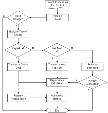

Understanding Capitalization Threshold Validation
The Capitalization Threshold Validation process validates whether assets still belong to the capitalization brackets to which they were initially catalogued after adjustments are made to the original cost. If an asset is in the same bracket as originally classified, then this process takes no further action; however, if it is not, the asset is moved to its respective capitalization bracket.
The following graphic represents the process flow for the capitalization threshold validation process:
Capitalization Threshold validation process flow:
Capitalization Validation process flow

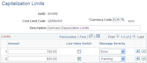

Capitalization Limits Page
Use the Capitalization Limits page (DEPR_CAP_LIMIT) to set up capitalization limit codes by business unit by book, as necessary, especially Germany.
Navigation:
Set Up Financials/Supply Chain, and then Product Related, and then Asset Management, and then Financials, and then Capitalization Limit
This example illustrates the fields and controls on the Capitalization Limits page. You can find definitions for the fields and controls later on this page.
Create a cost limit code, complete the applicable fields, and select the Low Value Switch check box to identify which limit amount triggers low value asset reporting. This is used only in certain countries.
For example, you might set up capitalization limits for Germany. Using the Cap Limit table, you can set up your system so that assets with a cost less than 800.00 EUR could be added, but the system would generate a warning that the cost was below the capitalization limit; likewise, assets with a cost less than 100.00 EUR could not be added and would generate an error message.

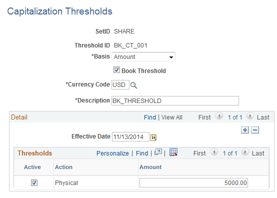

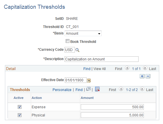

Capitalization Thresholds Page
Use the Capitalization Thresholds page (CAP_THR_DEFN) to establish capitalization thresholds by asset profile to be used in automatic classification of capital asset, non capital asset, or expense asset.
Navigation:
Set Up Financials/Supply Chain, and then Product Related, and then Asset Management, and then Financials, and then AM Capitalization Thresholds, and then Capitalization Thresholds
This example illustrates the fields and controls on the Capitalization Thresholds page. You can find definitions for the fields and controls later on this page.
Capitalization Threshold page
Capitalization Thresholds page - Book Method
Field or Control Description
Threshold ID
Supply a meaningful threshold ID when creating capitalization thresholds to assign them to asset profiles or assets.
Basis
Select the basis to be used for calculating the appropriate capitalization action to take. Select from the following options:
  • Amount: The capitalization threshold is based on the total cost of an asset (cost x quantity).
  • Quantity: The capitalization threshold is based on the unit costs per asset.
Book Threshold
Select this option to define capitalization threshold by book.
When you select this option, only the Physical Action option is available in the Thresholds group box.
Currency Code
Enter the currency code of the amounts reflected in the Amount fields.
Effective Date
Enter the date when the threshold becomes applicable.
Active
Activate each threshold bracket. When deselected, the amount becomes unavailable.
Action
Select to activate and set thresholds for the following brackets:
  • Physical: If this action is active and an asset falls within the threshold for this bracket, the system creates the asset ID but does not capitalize it. Any asset added that has an amount above this bracket is capitalized if this bracket is active.
  • Expense: If this action is active and falls within the threshold for this bracket, the asset is excluded from asset generation. If however, the Physical bracket is not active and an asset amount is above the Expense limit, the asset is capitalized.
    Note: If you select the Book Threshold option, this option is not available.
Amount
Enter the ceiling amount for each bracket. Amounts that are less than or equal to the amount entered are included in that bracket.

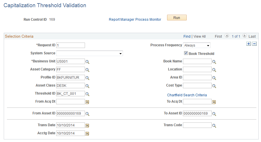

Capitalization Threshold Validation Page
Use the Capitalization Threshold Validation page (AM_CAPVAL_RQST) to run the process to validate whether an asset still meets conditions to remain in the capitalization status that it was originally catalogued upon asset addition based on the capitalization threshold process.
Navigation:
Asset Management, and then Asset Transactions, and then Financial Transactions, and then Cap Threshold Validation
This example illustrates the fields and controls on the Capitalization Threshold Validation page. You can find definitions for the fields and controls later on this page.
Supply the selection criteria for assets to be evaluated for capitalization threshold validation.
Book Threshold
Select this option to process capitalization validation for asset book.
When you select this option, the Validation Basis field is unavailable and only Threshold IDs associated with asset books are available for selection.
Chartfield Search Criteria link
Access the Chartfield Search Criteria page to supply ChartField filter information for those assets that have particular ChartFields active.
Trans Code (transaction code)
Select this criteria, which is useful for assets that are converted from trackable to capitalized. If you want to identify them or perform a different accounting entry, you can define and utilize a transaction code for that purpose.
Validation Basis
Select the criteria to use in order to evaluate the total cost of the asset against the threshold. The following options are available:
  • Capitalized Cost : The system sums only the amounts stored on the cost table.
  • Total Cost: The system sums up the amounts stored in both the cost and non capital cost tables.
    Note: This field is unavailable when the Book Threshold option is selected.

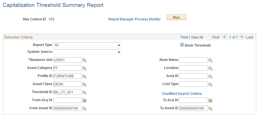

Capitalization Threshold Summary Report Page
Use the Capitalization Threshold Summary Report page (AM_CAPSUM_RQST) to run a report to show the capitalization status of assets based upon criteria selection.
Navigation:
Asset Management, and then Financial Reports, and then Capitalization Summary Report
This example illustrates the fields and controls on the Capitalization Threshold Summary Report page. You can find definitions for the fields and controls later on this page.
Select criteria to report assets as they are classified according to the Capitalization Threshold process. The report displays the acquisition date, asset ID, description, quantity, tag number, serial ID, capitalized cost and non capitalized cost.
Book Threshold
Select this option to process the capitalization status report for asset book.
Report Type
Select to report only the assets that are candidates for recategorization or select to report all assets.
Validation Basis
Select to report assets that are capitalized (from the cost table) or select to report both capital and non capital assets.
