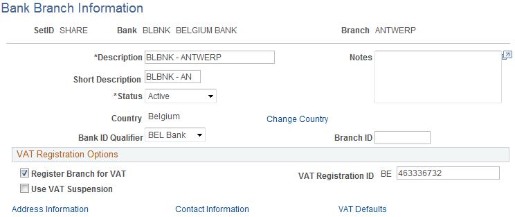

Bank Branch Information Page
Use the Bank Branch Information page (BANK_BRNCHPNL) to edit bank branch information associated with an external account.
Navigation:
  • Click the Bank Branch Information icon on the External Accounts page.
  • Banking, and then Banks and Branches, and then Bank Branch Information
This example illustrates the fields and controls on the Bank Branch Information page. You can find definitions for the fields and controls later on this page.
Field or Control Description
Bank ID Qualifier
Select a bank qualifier, if one is defined for the branch's country. The system uses the bank qualifier to validate values when you create accounts for the branch.
Branch ID
Enter a numeric branch ID, if one is defined for this bank branch.
VAT Registration Options
Bank branches represent physical bank locations. In order for the system to determine the appropriate VAT treatment for transactions generated through each branch, you must define the VAT registration information, as well as the VAT default parameters to use in VAT accounting.
Register Branch for VAT (register branch for value-added tax)
Select the check box and enter the VAT Registration ID, which the system automatically validates.
Use VAT Suspension (use value-added tax suspension)
Select if bank has been selected as a supplier that suspends charging VAT.
Note: You must first set two other VAT suspension settings in PeopleSoft to enable the VAT suspension functionality: you must select the Use VAT Suspension check box on the VAT Country table and set the VAT Exception Type for the VAT entity to Suspension. In order for a VAT applicable transaction to be marked as suspended, these three settings (VAT Country, VAT Exception Type for VAT entity, and the bank branch set as a VAT suspended supplier) must be in place.
Address Information
Click this link to access the Address page (BRANCH_ADDRESS_SEC), where you can set up the branch address.
Contact Information
Click this link to access the Bank Contacts page (BRANCH_PNLCNTCT), where you can set up contact information for the specified branch.
VAT Defaults (value-added tax defaults)
Click to access the VAT Defaults Setup page (VAT_DEFAULTS_DTL). The VAT Defaults Setup page is a common page used to set up VAT defaulting for all PeopleSoft applications processing VAT transactions. On this page, you can define bank branch information defaults as applicable.
Note: The VAT Defaults link appears on all Bank Branch Information pages; however, it is available only if the country for the bank is set up for VAT and the Register Branch for VAT check box is selected.
