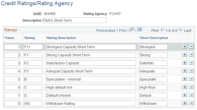

Credit Ratings/Rating Agency Page
Use the Credit Ratings/Rating Agency page (CREDIT_RTG_TBL) to define rating agencies and their associated credit ratings.
Navigation:
Set Up Financials/Supply Chain, and then Product Related, and then Treasury, and then Credit Ratings/Rating Agency
This example illustrates the fields and controls on the Credit Ratings/Rating Agency page. You can find definitions for the fields and controls later on this page.
Field or Control Description
Value
Displays the value by which to rank the ratings in ascending order. 1 is the highest rating. This value assigns a numeric equivalent to an alphanumeric rating so that you can implement any processes or credit reports needed for your organization.
Rating
Displays the actual alphanumeric rating that the rating agency assigns.

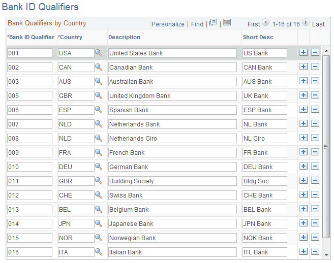

Bank ID Qualifiers Page
Use the Bank ID Qualifiers page (BNK_ID_QUAL_PNL) to view the ID qualifiers that the system uses to edit bank values.
Navigation:
Banking, and then Banks and Branches, and then Bank ID Qualifiers
This example illustrates the fields and controls on the Bank ID Qualifiers page. You can find definitions for the fields and controls later on this page.
Oracle’s PeopleSoft delivers predefined bank ID qualifiers, which you should typically not modify.
Bank ID Qualifier
Displays the country-specific numeric value for a bank. This value controls how the bank and counterparty pages edit and display bank information. This information drives bank account edits, which can vary by country for each bank type. In some cases, a country may have more than one ID.
Each bank ID qualifier indicates a specific type of bank with specific identifying information. For example, when the system encounters a bank ID qualifier of 001 (indicating a U.S. bank), the system validates that you entered a valid check digit for an ABA transit routing number for the bank qualifier.
Note: If you add a new bank ID qualifier, you must write PeopleCode to match the new value. This code appears in the record PeopleCode for FUNCLIB_LCINTFC.BANK_ID_QUAL in the FieldFormula event. Oracle suggests that you make this page a display-only page or use PeopleTools security to limit access to system administrators only.
This table describes the system-delivered data.
Qualifiers marked with (no field validation) have no rule validation. If you want the system to automatically perform rule validation routines, you must write the appropriate PeopleCode. For more information, refer to the European Committee for Banking Standards website at http://www.ecbs.org. You can access various countries' bank account numbering conventions and specifications at http://www.ecbs.org/tr201country.htm.
Bank ID Qualifier Bank ID (Defining Banks) Bank Account Number (Bank Accounts) Branch Check Digit
001
U.S. Bank
9-digit transit routing number. Exactly 9 numerics with check digit calculation.
NA
NA
NA
002
Canadian Bank
Exactly 4 numerics.
Between 7 and 12 numerics.
Branch routing number
Exactly 5 numerics.
NA
003
Australian Bank
Exactly 3 numerics.
Max 9 numerics.
Exactly 3 numerics.
NA
005
Great Britain Bank
Exactly 6 numerics.
(Sort Code)
Max 10 numerics.
NA
NA
006
Spanish Bank
Exactly 4 numerics.
Exactly 10 numerics.
Exactly 4 numerics.
Exactly 2 digits with check digit algorithm.
007
Netherlands Bank
NA*
Exactly 10 numerics with modulus 11 check.
NA
NA
008
Netherlands Giro
NA*
Max 7 numerics.
NA
NA
009 French bank
Exactly 5 numerics.
Max 11 characters.
Exactly 5 numerics.
Check digit algorithm.
010
German Bank
Exactly 8 numerics.
Max 10 numerics.
NA
NA
011
Great Britain Building Society
Exactly 6 numerics.
(Sort Code)
Max 10 numerics.
NA
NA
012
Swiss Bank
Between 3 and 5 digits.
Max 16 characters.
NA
NA
013
Belgian Bank
Exactly 3 numerics.
Max 7 numerics.
NA
2 numerics with 97 modulus check.
014
Japan Bank
Exactly 4 numerics.
Max 7 numerics.
Exactly 3 numerics.
NA
015
Norwegian Bank (no field validation)
NA
NA
NA
 NA
016
Italian Bank
Exactly 5 numerics.
Max 12 alphanumerics.
Exactly 5 numerics.
1 alpha with check digit algorithm.
020
Swiss PPT(no field validation)
NA
NA
NA
 NA
See the product documentation for PeopleTools: Security Administration.

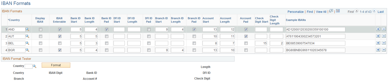

IBAN Formats Page
Use the IBAN Formats page (IBAN_FORMAT_TBL) to view IBAN formats and generate sample IBANs.
Navigation:
Banking, and then Banks and Branches, and then IBAN Formats
This example illustrates the fields and controls on the IBAN Formats page. You can find definitions for the fields and controls later on this page.
IBAN Formats page
This page displays the formatted components of the International Bank Account Number (IBAN) based on the three-character, European country code selected in the first column. The IBAN is composed of a country code, IBAN check digits, and the Basic Bank Account Number (BBAN)—all the information needed to route a payment through any national clearing house. PeopleSoft supports and provides sample data for 38 countries.
Because the two-character, country code and IBAN check digits are always the first four characters of an IBAN, it is not necessary to include columns defining their position and length on this page.
Country
Select the three-letter country code for a specific European country.
Display IBAN
Select to enable IBAN functionality for a specific country to show the IBAN in addition to the bank account number on pages and reports. The Display IBAN check box is deselected by default. If deselected, local bank account numbers will be displayed on pages and reports related to the country.
IBAN Enterable
This box determines how the IBAN is entered on various PeopleSoft Financials application pages. If Selected, the user enters the IBAN manually. If left unchecked, the user enters a two-character, IBAN, check digit and clicks a View IBAN button to have the system generate it.
Note: Previous to Release 9 of PeopleSoft Financials, IBAN was supported only for Belgium, France, Germany, Ireland, Italy, Netherlands, Spain, Switzerland, and the United Kingdom, and only by using the check-digit entry method. For those nine countries, the default setting for the IBAN Enterable field is unchecked. Any of these countries can be configured to support entering the IBAN manually by selecting this box.
Bank ID Pad, DFI ID Pad, Branch ID Pad, and Account Pad
If selected, leading zeroes will be prefixed to the ID value to extend it to its maximum length.
Bank ID Start
Enter where the first alphanumeric character of the bank identification value will appear in the IBAN.
Bank ID Length
Enter the number of characters making up the bank identification value.
DFI Start
Enter where the first alphanumeric character of the DFI code will appear in the IBAN. The DFI is a bank identifier that may be included in the IBAN ID when the DFI Qualifier is set to SWIFT on bank-account related pages (for example, the Beneficiary Bank page).
DFI Length
Enter the number of characters making up the DFI code.
Branch ID Start
Enter where the first alphanumeric character of the branch ID code will appear in the IBAN.
Branch ID Length
Enter the number of characters making up the branch ID code.
Account Start
Enter where the first alphanumeric character of the bank account will appear in the IBAN.
Account Length
Enter the number of characters making up the bank account.
Check Digit Start
Enter where the first alphanumeric character of the bank check digit will appear in the IBAN.
Note: This is the check digit used in the formal validation of the domestic bank account, not the IBAN check digit.
Check Digit Length
Enter the number of characters making up the bank check digit.
IBAN Format Tester
Select a country code and click Format to generate a sample IBAN for any of the PeopleSoft-supported countries.
Oracle is not responsible for the validity of IBANs manually keyed in any of the bank-account related pages. The IBAN should be provided by a financial institution.
See External Accounts Page.
See Beneficiary Bank Page.
See PeopleSoft Cash Management: EFT Request - Destination Page.
See PeopleSoft Order to Cash Common Information: Adding General Customer Information.
See PeopleSoft Expenses: Understanding Accounting-Related Data Setup.

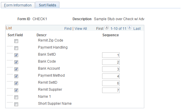

Sort Fields Page
Use the Sort Fields page (PYMNT_FORM_SORT) to select the grouping of fields used to sort your forms of payment.
Navigation:
Banking, and then Banks and Branches, and then Payment Forms, and then Sort Fields
This example illustrates the fields and controls on the Sort Fields page.
Sort Fields page
Select the fields that you want to use to sort your check output. Enter sequence numbers for sorting priority.
