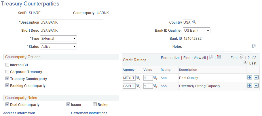

Treasury Counterparties Page
Use the Treasury Counterparties page (BANK_PNL_TR) to establish counterparties.
Navigation:
Banking, and then Banks and Branches, and then Treasury Counterparties
This example illustrates the fields and controls on the Treasury Counterparties page. You can find definitions for the fields and controls later on this page.
Most of the fields on this page are the same as the fields on the Bank Information page. See the Bank Information Page for more information.
Field or Control Description
Address Information
Click this link to access the Address Information page (BANK_ADDR_PNL_TR), where you can enter a counterparty’s address, if desired.
Counterparty Options
Corporate Treasury
Select if a bank is a regional or corporate treasury. This option applies only to internal bank types. Corporate treasury entities have special rights within PeopleSoft Treasury, such as servicing internal accounts. You can designate multiple internal counterparties as a corporate treasury. If you select this check box, you should also specify the general ledger unit with which it is associated. When you select this check box, the system automatically selects the Internal BU check box.
Counterparty Roles
Select the check boxes that reflect the activities in which this counterparty is involved. Options are: Deal Counterparty, Issuer, or Broker.

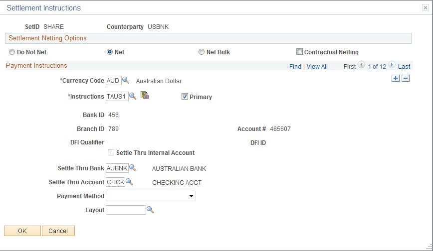

Settlement Instructions Page
Use the Settlement Instructions page (BANK_STL_NET) to specify, by currency, the counterparty's account into which your payments will be directed as a result of deals transacted with this counterparty.
Navigation:
Click the Settlement Instructions link on the Counterparty Information page.
This example illustrates the fields and controls on the Settlement Instructions page. You can find definitions for the fields and controls later on this page.
You can specify netting options and payment instructions for deals associated with a specified counterparty.
Netting options specified here are used only in the deal settlement netting process; these options are not used in the bilateral account netting process.
See PeopleSoft Deal Management: Settlement Instructions Page.
Settlement Netting Options
Select a netting option for this counterparty.
Do Not Net
Select if no netting takes place for transactions with this counterparty.
Net
Select if both positive and negative cash flows for each currency are netted, resulting in one net cash flow per currency.
Net Bulk
Select if positive and negative cash flows for each currency are netted separately, resulting in one positive cash flow amount and one negative cash flow amount per currency.
Contractual Netting
If you select either Net or Net Bulk, select this check box to indicate that there is a netting contract in place with this counterparty.
Payment Instructions
Instructions
Select a settlement instruction.
Primary
Select to indicate which instructions are the default instructions in Deal Management.
Settle Thru Internal Account
Select to enable settlements to go through an internal account as opposed to an account in another bank. This check box is available only if the bank type is Internal.
Settle Thru Bank and Settle Thru Account
Select the appropriate bank code and account code.
Payment Method
Payment methods available to you are determined by the selected Settle Thru Bank and Settle Thru Account.
See External Accounts - Payment Methods Page.
