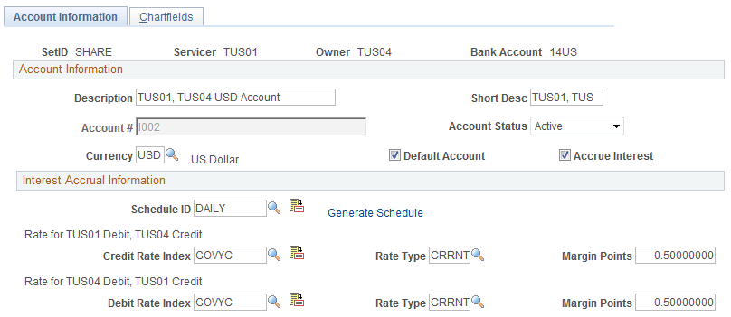

Internal Accounts - Account Information Page
Use the Internal Accounts - Account Information page (BANK_ACCT_INT) to maintain balances and transfer amounts among the business units within your enterprise, with one or more treasury units serving as an in-house bank.
Navigation:
Banking, and then Bank Accounts, and then Internal Accounts, and then Account Information
This example illustrates the fields and controls on the Internal Accounts - Account Information page. You can find definitions for the fields and controls later on this page.
There are two perspectives for each internal account: the view from the account owner's side (the business unit's perspective) and the view from the account servicer's side (the treasury's perspective). You must define both banks as internal banks, and define at least one bank as a corporate treasury.
Account Information
Field or Control Description
Account # (account number)
Displays the bank account number assigned by the system.
Default Account
Select to set this account as your default internal account.
Accrue Interest
Select to accrue interest on this account. You can run interest accruals on the Interest Accruals page. You can view your interest accruals on the Internal Account Activity page.
Interest Accrual Information
Schedule ID
If you specified that this account accrues interest, select a schedule ID to indicate how often interest accrues.
Credit Rate Index and Debit Rate Index
Enter both debit and credit rate index information, which is required to run interest accrual calculation and interest schedule generation processes.

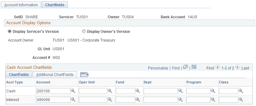

Internal Accounts - ChartFields Page
Use the Internal Accounts - Chartfields page (BANK_ACCT_INT2) to enter both the account servicer's (treasury's) and the account owner's (business unit's) ChartField and account number information.
Navigation:
Banking, and then Bank Accounts, and then Internal Accounts, and then Chartfields
This example illustrates the fields and controls on the Internal Accounts - Chartfields page. You can find definitions for the fields and controls later on this page.
Account Display Options
Display Servicer's Version
Select to view or modify ChartFields for the servicer.
Display Owner's Version
Select to view or modify ChartFields for the owner.
Cash Account ChartFields
Select a cash account ChartField for both the servicer's version and the owner's version.
Important:
To properly book internal account transfer activity between the servicer and owner, you must specify General Ledger cash account ChartFields for all internal accounts. Doing this ensures that the system creates the necessary accounting entries and events, and updates the appropriate system tables and internal ledger accounts. In addition, if you selected the Accrue Interest check box on the Internal Accounts - Account Information page, you must enter ChartFields to create transactional accounting entries for the servicer and owner.
