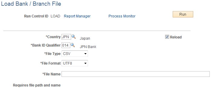

Use the Load Bank / Branch File page (EBK_RUN_CNTRL) to specify the run parameters for the External Bank / Branch Load process.
Navigation:
Set Up Financials/Supply Chain, and then Common Definitions, and then Bank Branch File, and then Load External Bank File
This example illustrates the fields and controls on the Load Bank / Branch File page. You can find definitions for the fields and controls later on this page.
Field or Control Description
File Type
Select either Fixed or CSV.
File Name
Enter the full file path and file name of the bank file.
Reload
Select to reload the entire bank file. In this case, the system deletes the existing bank/branch information and replaces it with a new set of information.
